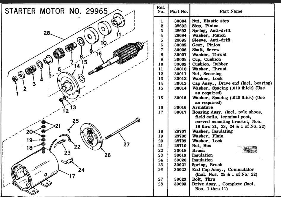

Bucko 10 #1 Posted June 27, 2018 On my 61 H55D wheel horse, the spring that is supposed to push the starter gear back is broken. Is this available? Share this post Link to post Share on other sites
pfrederi 19,794 #2 Posted June 27, 2018 Looks to be discontinued #28693.This is an HH60 part listing but i think it was the same as yours Share this post Link to post Share on other sites

moe1965 774 #5 Posted June 28, 2018 Repair kits are available on eBay etc. They usually include the drive as well. Be sure to count the number of teeth on the drive if you are going to replace that as well. I would as long as you got it apart Share this post Link to post Share on other sites
Bucko 10 #6 Posted June 28, 2018 (edited) The gear operates smoothly "in/out" on the shaft, but will not return in on its own. Found that this spring was in pieces. Gear teeth are in great shape. It totally amazes me in how solid this tractor is. Its only downfall was that its owner left in under a roof cover, but in dirt and mud. Over its past 5 years, it sat sunk on its left side up over the left front wheel, hence the reason that rim completely rusted out. The rest of the tractor has come apart easily, and cleaned up well. Its "patina" will stay, as it shows its original paint in decent, but faided out shape. The seat will get recovered. Pictures to come. Many thanks to all on this site for help, guidance, and support. Edited June 28, 2018 by Bucko Share this post Link to post Share on other sites
