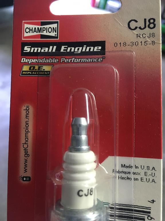

Bucko 10 #12 Posted July 6, 2018 On 6/28/2018 at 2:34 PM, Terry M said: These work Nice in all of my Tecumseh H/HH 60 ‘s and simalar engines This is what I ended up with at my local ACE hardware store. J8's seem to be no longer available, nor the RJ8's (resistor). I forgot what the C stood for, but it lines up in size with the old J8 that was in there. Share this post Link to post Share on other sites
lynnmor 8,684 #13 Posted July 6, 2018 7 hours ago, Bucko said: This is what I ended up with at my local ACE hardware store. J8's seem to be no longer available, nor the RJ8's (resistor). I forgot what the C stood for, but it lines up in size with the old J8 that was in there. C stands for copper. For whatever reason they made plugs with a copper core. Share this post Link to post Share on other sites
