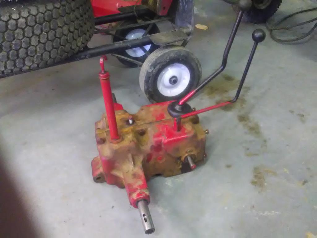

drn441 11 #1 Posted June 24, 2018 I have the transaxle out of my 310-8 because it was leaking all over the garage floor.. when I pulled the drain plug I got a lot of water and milky oil out of it so I want to open up the case and clean everything up and replace all of the seals... Only problem is I'm not sure what model transaxle I have to order parts.. the model number of the tractor is no longer there...The only identification I have is sticker on the transaxle that reads (Uni-Drive Pat. No. 2988185).. also the engine is a kohler magnum 10. any help would be great thanks Dan Share this post Link to post Share on other sites

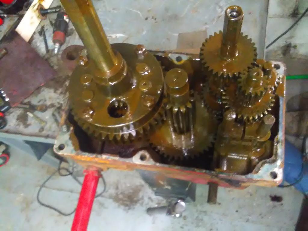

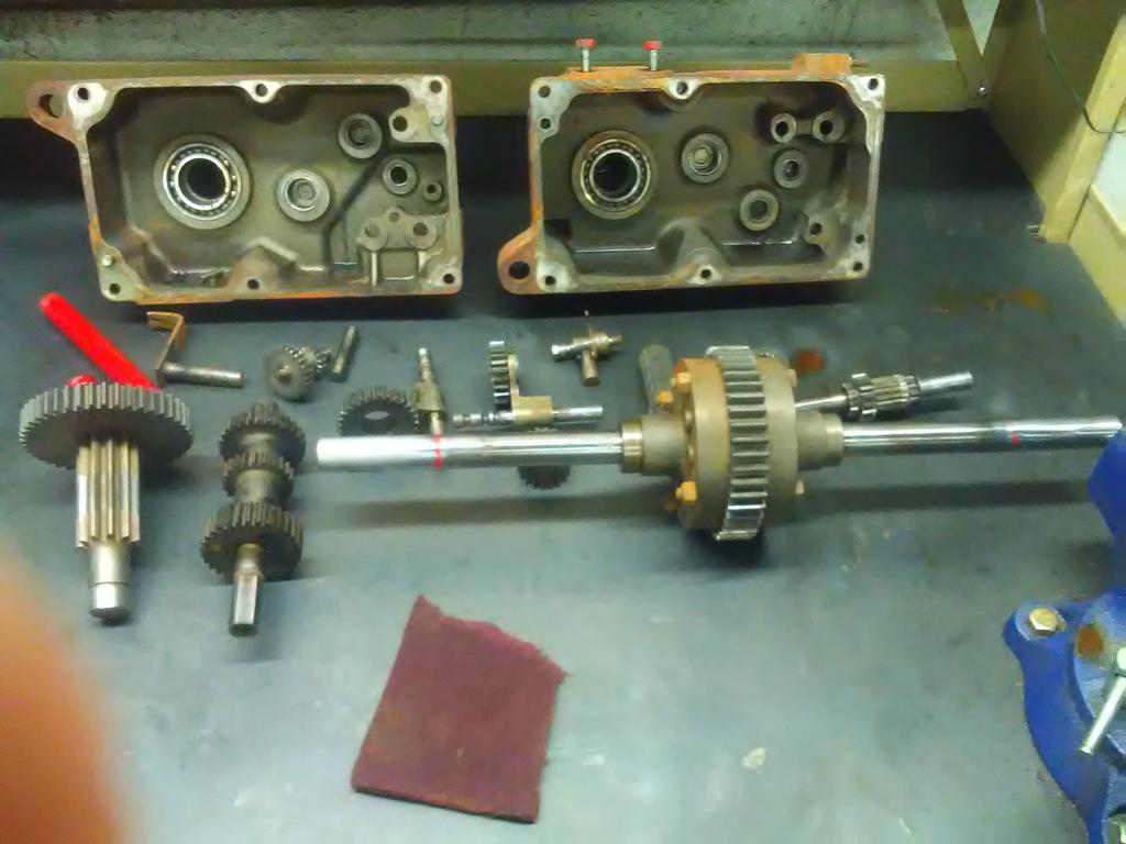

drn441 11 #8 Posted June 28, 2018 I pulled the case apart and it looks like I can get away with just replacing seals and gaskets and cleaning everything up. I took some pictures of my progress. thanks again for all the info 3 Share this post Link to post Share on other sites
stevasaurus 23,620 #9 Posted June 28, 2018 Thank you for the pictures. It does look like just a cleaning and seals. Share this post Link to post Share on other sites

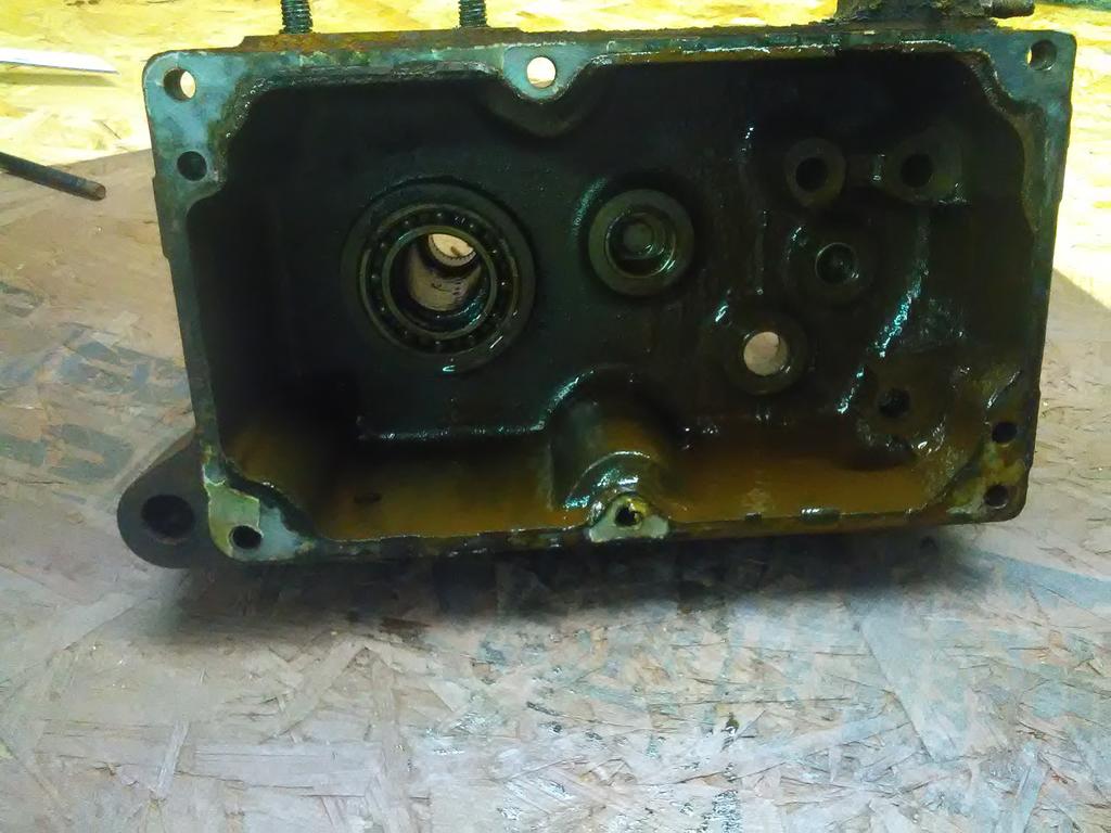

drn441 11 #11 Posted June 29, 2018 All cleaned up just waiting on parts 1 Share this post Link to post Share on other sites
stevasaurus 23,620 #12 Posted June 29, 2018 That looks great, except...you need to scrape and wire wheel the case halves where the gasket goes. You knew that, didn't you. Share this post Link to post Share on other sites

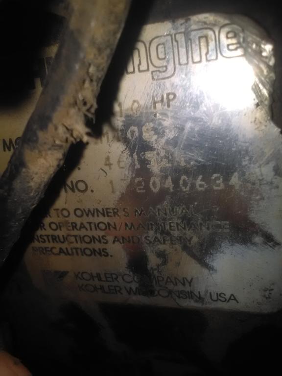

drn441 11 #13 Posted July 1, 2018 Yeah that's just the picture I snapped after pulling everything from the parts washer before I cleaned the gasket surface. I found the tag on the engine not sure what all can be identified by it.. Share this post Link to post Share on other sites
gwest_ca-(File Mod) 12,014 #14 Posted July 1, 2018 Kohler made serial 172040634x in 1987 so the engine would land on a 1987 or 1988 model tractor. Engine Specification # 461521 was used in both the 1987 and 1988 310-8 tractor models. Possible tractor models 1987 310-8 tractor model 21-10K804 1988 310-8 tractor model 21-10K805 Garry 1 Share this post Link to post Share on other sites
drn441 11 #15 Posted July 3, 2018 Thank you for the info. I actually have the engine out of the tractor right now because it was burning oil really bad. (I'm thinking it needs rings at least) that should help me in finding a good manual! Share this post Link to post Share on other sites
