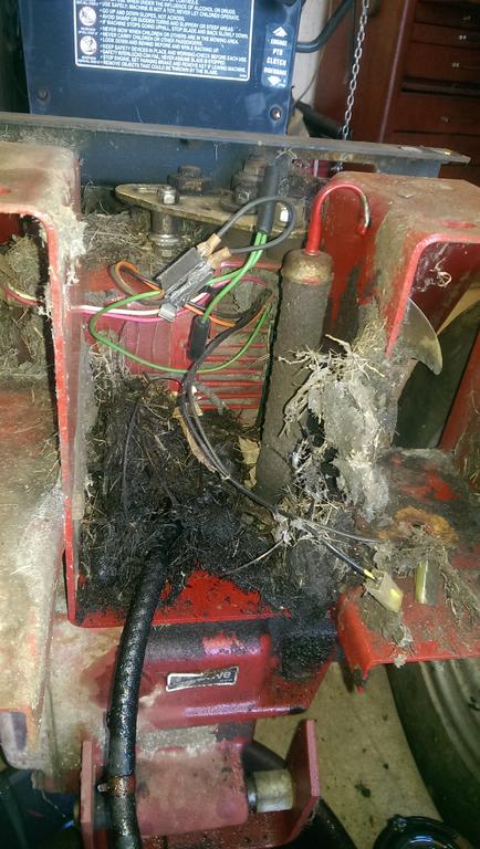

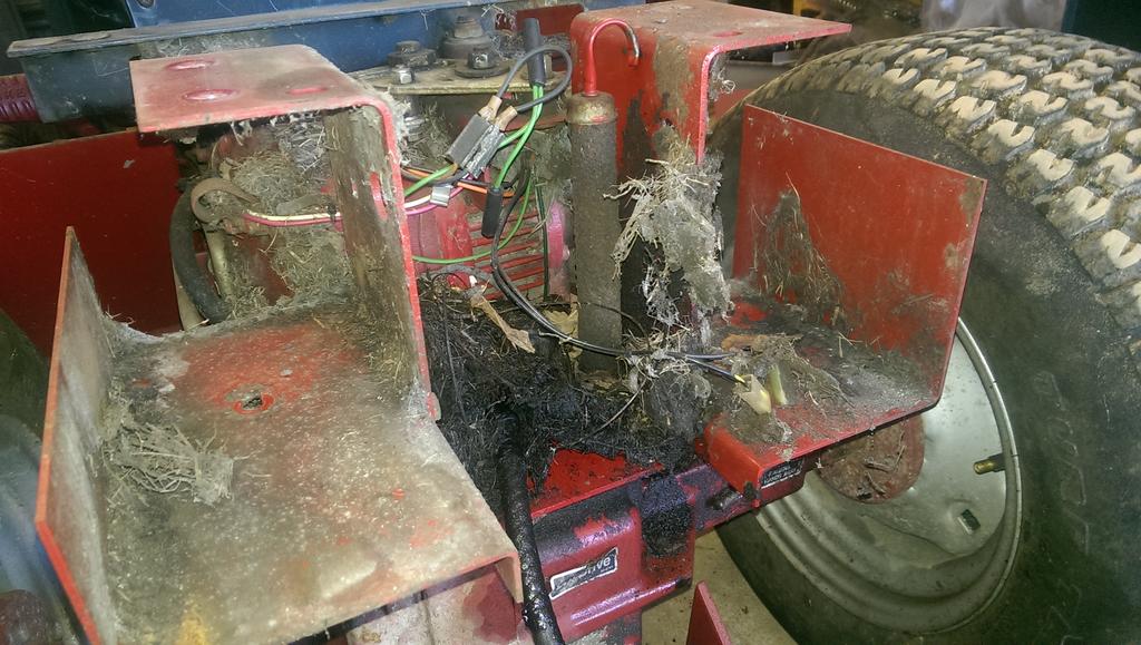

WVHillbilly520H 10,377 #2 Posted June 23, 2018 I would pull the seat/fender pan you would be surprised how much "gunk" gets accumulated in top of the hydro pump/fins, and give that area a proper cleaning then change oil and filter any 10w30 motor oil most here prefer synthetics and a NAPA/Wix 1410 filter, I prefer the Toro filter myself, Jeff. (pictures were of a 230 hour machine) 1 Share this post Link to post Share on other sites

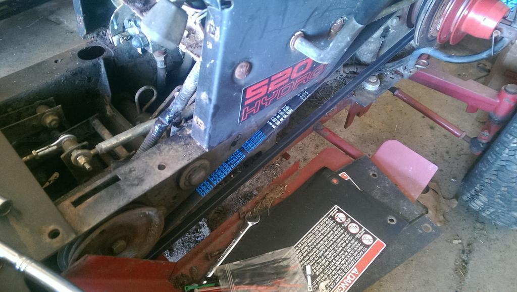

cgambino1018 28 #7 Posted June 26, 2018 ok tried the test against the tree. The tires did not spin. Took the chair and back panel off. It looked pretty clean. See pics below. Just to be thorough I checked the dip stick. it is DRY.. yes I am an idiot. I will put a 1/2 qt in tomorrow and try again. For my knowledge, if its the belt that is slipping is there a place to tighten it or do i just replace it? Thanks Chris Share this post Link to post Share on other sites

cgambino1018 28 #10 Posted June 28, 2018 With the dipstick showing proper oil level power is back. I cut the wet grass yesterday (Yes I know cutting wet grass is bad) after I put in about 1/3 of a qt. Wouldnt think that little amount of oil would make such a difference. Will keep an eye on it since it ran fine for a couple of cuts. I will try the test against the tree this weekend to confirm it can spin the tires. Also is there a belt that may be slipping also? If so can it be tightened or do i just replace the belt? Share this post Link to post Share on other sites
WVHillbilly520H 10,377 #11 Posted June 29, 2018 11 hours ago, cgambino1018 said: Also is there a belt that may be slipping also? If so can it be tightened or do i just replace the belt? There is only the main drive belt from the engine to the hydro pump, it has a spring tensioned idler pulley no other way to tighten slack other than replacing the belt which is easier to do with the right rear tire removed to get the hydro fan off, Jeff. 1 Share this post Link to post Share on other sites
