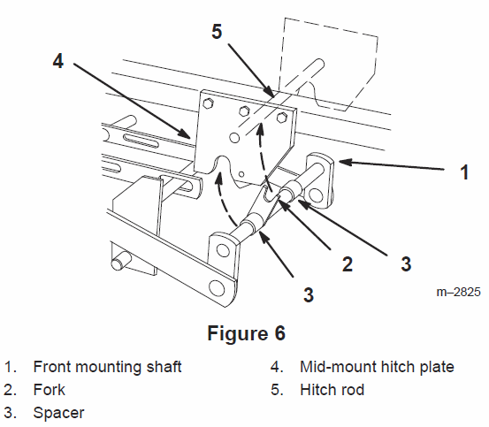

gwest_ca-(File Mod) 11,521 #3 Posted June 23, 2018 Go through the operator manual and review the setup instructions. Make sure the tire pressures are correct. Click on the fuzzy picture of the manual below Make sure the fork in the hitch is captured by the cross shaft Garry Share this post Link to post Share on other sites
peter lena 9,308 #4 Posted June 23, 2018 those shaft spacers have to shoulder up on the inside ,both sides of the mid mount hitch plate. as soon as you described the deck offset I knew what was up. I also pick up the lift rod to stop , put deck on lowest setting, before sliding deck in and hooking up to lift slide hole. Then I pick up deck with lift rod handle, and secure it to hitch plate, that is where you shoulder up your deck to square. flip the lower locking lever back to secure the front mounting shaft, your now locked in. now pick up your cutting height at wheel .after I did this a couple of hundred times , its a piece of cake, pete Share this post Link to post Share on other sites
