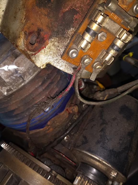

D kiger 2 #1 Posted June 21, 2018 (edited) I replaced key switch now my engine only runs if i jump wire from coil to solenoid. Can anybody help. Edited June 21, 2018 by D kiger Share this post Link to post Share on other sites

ebinmaine 75,665 #3 Posted June 21, 2018 1 hour ago, D kiger said: I replaced key switch now my engine only runs if i jump wire from coil to solenoid. Can anybody help. Why do you have the picture in your posting that I took and put in my own thread? Share this post Link to post Share on other sites
gwest_ca-(File Mod) 11,838 #4 Posted June 21, 2018 These wiring diagrams should help you figure out how the power gets from the ignition switch to the coil. Click on the picture. This is the switch you need. Click on the picture and again on the pictures that come up on the next page. The switch must have the "I" (eye) terminal to work on battery ignition. An identical switch with a "M" terminal is for magneto ignition. Garry Share this post Link to post Share on other sites

ebinmaine 75,665 #6 Posted June 21, 2018 3 hours ago, gwest_ca said: These wiring diagrams should help you figure out how the power gets from the ignition switch to the coil. Click on the picture. This is the switch you need. Click on the picture and again on the pictures that come up on the next page. The switch must have the "I" (eye) terminal to work on battery ignition. An identical switch with a "M" terminal is for magneto ignition. Garry Gary, is this thread some kind of joke or spam? That's not even their picture. I took it ... one of my own tractors. Share this post Link to post Share on other sites
