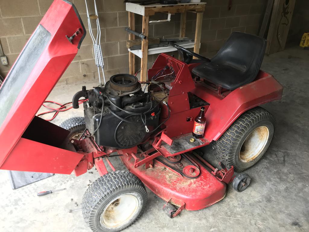

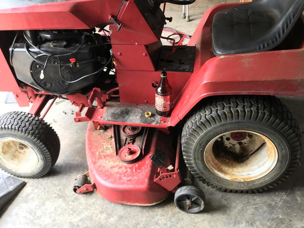

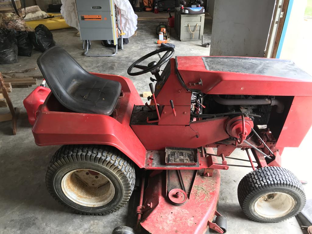

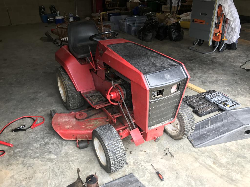

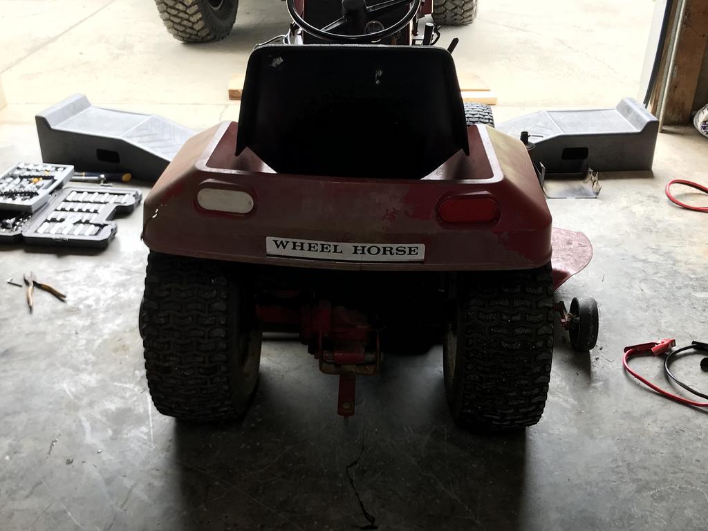

Ephillips2582 6 #1 Posted June 21, 2018 Hi folks! I’m a brand spanking new wheel horse owner. My family and I just moved to Tennessee from Florida. We’ve got 6 acres, and didn’t have a mower for the 2 acres of yard. I happened across an old wheel horse at, what I felt, was a good deal. She’s not pretty. But I prefer older stuff, just easier to work on. As the old saying goes “they don’t make them like they used to”. She was a little rough starting, but ran like a top for the couple of hours I was running her. So yesterday I pulled the battery, starter and relay. Have a new battery and relay, and having the starter rebuilt locally. The problem I have encountered is that I don’t know the model or year. I can’t find a badge anywhere on her. I’ve looked exterior and all over the motor. All I can tell you is it has a Kohler twin 17. Pictures below of the rest of her. Any and all help would be greatly appreciated. 3 Share this post Link to post Share on other sites
Sparky-(Admin) 24,636 #2 Posted June 21, 2018 What you have is a C-175 automatic. Made from 1980 to 1984. Does the tranny fluid filter point towards the rear or the side of the tranny? That will narrow down the year a bit..to the side is an early 1980 and to the rear is a late 1980-1984. Is the model# tag still attached under the dash? Close to the hydro lift lever? 1 Share this post Link to post Share on other sites

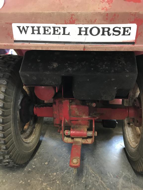

Ephillips2582 6 #5 Posted June 22, 2018 Excellent! Thanks all of you for your input. -I did not see a badge under the dash. -It has a muffler. That pic was post disassembly for the starter. So it was already taken off. -does the pic below help? 1 Share this post Link to post Share on other sites
953 nut 64,142 #6 Posted June 23, 2018 1980 was the first year the C-175 had an Eaton Trans. Need the model number from the tag. Share this post Link to post Share on other sites

midpack 1,104 #8 Posted June 23, 2018 20 hours ago, Ephillips2582 said: Excellent! Thanks all of you for your input. -I did not see a badge under the dash. -It has a muffler. That pic was post disassembly for the starter. So it was already taken off. -does the pic below help? Looks like an Eaton hydro. Could be a later C-175. You could try to hone in on the year with the engine tag. Looks like an original series I Kohler Share this post Link to post Share on other sites
