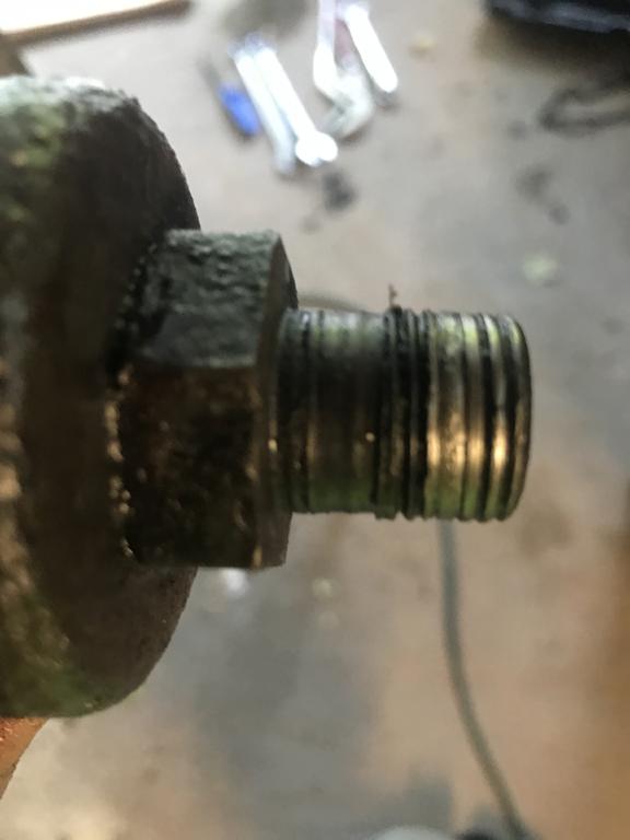

Dadlife520H 195 #1 Posted June 20, 2018 Was mowing, heard some strange noises coming from my 48sd... So long story short... one of the washers the center blade sits between went away? And the blade was loose. I attempted to take the blade off and the nut was seized. Once I got the nut off, I was left with this.... is there an off birand spindle that is a replacement for the oem part or will I be forced to spend $125 each for new spindles? The other two nuts are seized as well. Share this post Link to post Share on other sites

Dadlife520H 195 #4 Posted June 21, 2018 This unfortunately was the aftermath of heating the first one. Lol. Im not sure if there is enough thread left to run a die. But I'll try anything to save a few bucks. And and I was hoping to make it down to the show but my work schedule just didn't pan out. Share this post Link to post Share on other sites

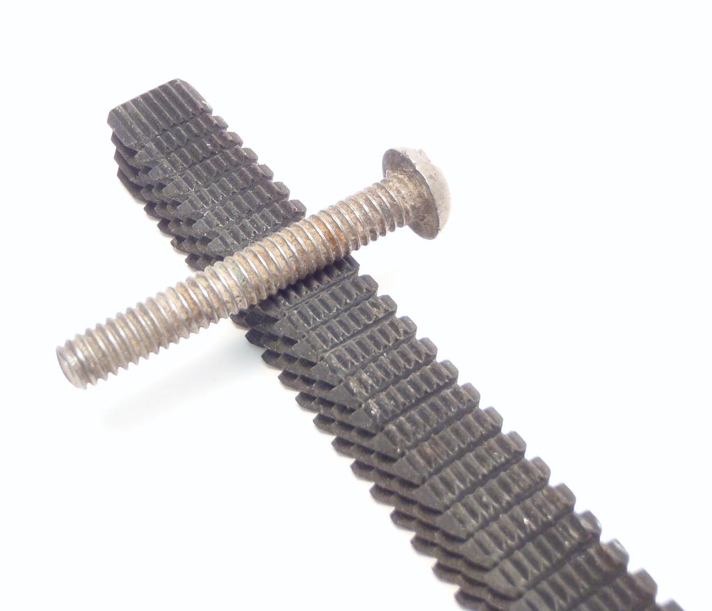

gwest_ca-(File Mod) 12,015 #6 Posted June 21, 2018 You have a thread or two that looks OK which is required to use a thread file. You register the file in a couple of good threads and file away at the next ones to it working your way around the shaft. Garry 2 Share this post Link to post Share on other sites

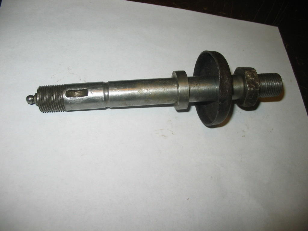

pacer 3,179 #7 Posted June 21, 2018 A spindle can be made fairly easily --- if --- you have, or know of someone who has a metal lathe & mill. I have made 2 of them for hard to find, expensive, non existent, etc.... That one can even be saved by welding over the stripped threads and take it back to size on a lathe and rethread. But, that beyond most peoples ability. There are usually spindles on the bay, keep an eye out for them ... We will HAVE to become more and more inventive? as our parts become more and more scarce 7mill. I have made 3 of them so far 2 Share this post Link to post Share on other sites

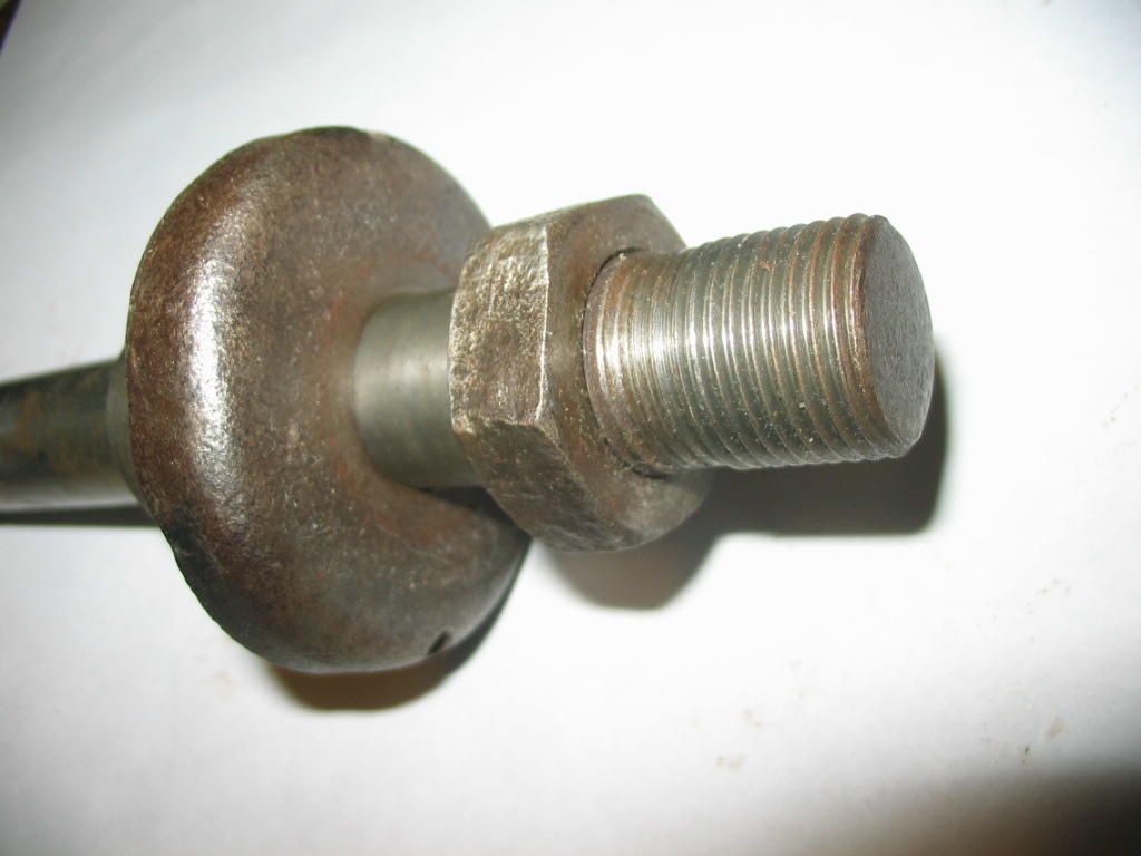

daveoman1966 3,882 #9 Posted June 21, 2018 (edited) Two types of spindles for these decks. Either type will fit either the 42 or 48" decks, but the top pulleys are, of course, different OD. One spindle style uses a WOODRUFF key on the pulley end, which is 3/4" diameter...for a 3/4" ID pulley. The other style, WITHOUT the woodruff key has a shaft pulley-end diameter of only 5/8", for a pulley with 5/8" ID. I have, in hand, a good shaft that uses the WOODRUFF key on the pulley end. Not new, but in good condition and very useable. For pic and a price, ask me at the following email address: daveoman@windstream.net if you need ONLY the spindle shaft, I have a USED one in the WOODRUFF key design shown here. Edited June 21, 2018 by daveoman1966 Share this post Link to post Share on other sites
