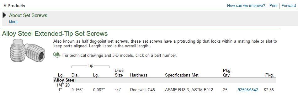

Kenneth R Cluley 661 #2 Posted June 20, 2018 Best on-line is Mcmaster Carr. Have variety and fast shipping. I would not recommend grinding as outside of screw is hardened and inside is not as hard. you would grind away the hard area and expose the softer interior. 3 Share this post Link to post Share on other sites

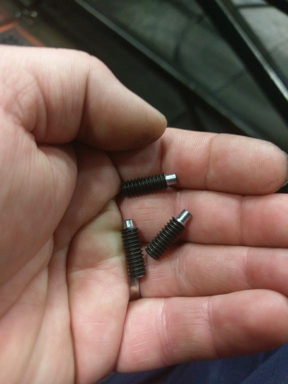

gwest_ca-(File Mod) 12,014 #12 Posted June 20, 2018 Grind a dog-point on a socket head cap screw. Someone recently posted that they are Gr8. Garry 1 Share this post Link to post Share on other sites
WVHillbilly520H 10,378 #13 Posted June 20, 2018 19 minutes ago, gwest_ca said: Grind a dog-point on a socket head cap screw. Someone recently posted that they are Gr8. Garry Yes that's what they tell use at work that the socket head cap screws are grade 8. And you could just grind your dog-point on a standard set screw. Guess I could fire up the lathe at work and make a few (100) to help everyone out here . Share this post Link to post Share on other sites
ebinmaine 77,516 #14 Posted June 21, 2018 1 hour ago, gwest_ca said: Grind a dog-point on a socket head cap screw. Someone recently posted that they are Gr8. Garry 1 hour ago, WVHillbilly520H said: Yes that's what they tell use at work that the socket head cap screws are grade 8. And you could just grind your dog-point on a standard set screw. How much concern is there of losing the heat treatment or hardness of the bolt while I'm grinding? Should I just take my time and do it slowly and keep dipping it in cold water? Share this post Link to post Share on other sites
WVHillbilly520H 10,378 #15 Posted June 21, 2018 7 hours ago, ebinmaine said: How much concern is there of losing the heat treatment or hardness of the bolt while I'm grinding? Should I just take my time and do it slowly and keep dipping it in cold water? That will help a lot if you get it red hot from grinding then you went to fast but oil to help cool will actually help more than water. Share this post Link to post Share on other sites

jebbear 386 #18 Posted June 21, 2018 This is what I did, really easy to do and seemed to work pretty well. I didn't have a problem with the initial cost of these things, but the shipping they wanted was ridiculous for something that could have been thrown into an envelope & mailed. http://www.wheelhorseforum.com/topic/73715-my-856-project/?do=findComment&comment=712938 1 Share this post Link to post Share on other sites
WVHillbilly520H 10,378 #19 Posted June 21, 2018 1 hour ago, jebbear said: This is what I did, really easy to do and seemed to work pretty well. I didn't have a problem with the initial cost of these things, but the shipping they wanted was ridiculous for something that could have been thrown into an envelope & mailed. http://www.wheelhorseforum.com/topic/73715-my-856-project/?do=findComment&comment=712938 I was going to mention that as when reloading ammo I use my drill at my lathe...but I did whittle out a dozen dig-point set screws earlier while at work, Jeff. Share this post Link to post Share on other sites
pfrederi 19,941 #20 Posted June 21, 2018 2 hours ago, ebinmaine said: Hey Paul...... Where are you buying them? McMaster my go to for hardware. If I order by 5:30 pm Mr Brown drops it off the next day some times as early as noon. Shipping for most of my orders is between 5 and 9 dollars. 1 Share this post Link to post Share on other sites
