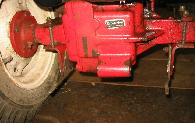

daveoman1966 3,841 #2 Posted June 20, 2018 It MAY BE that your rear axle bracket is not aligned properly. Just a 1/2" inch either way critical. Release the top four bolts and whack it one way or the other. Go easy with the whacking. Don't forget to retighten the 4 nuts. If not, you MAY have to put a spacer washer behind the idler pulley, or MAYBE bend the bracket just a little to straighten the belt route. 1 Share this post Link to post Share on other sites

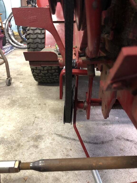

MattK 0 #5 Posted May 26, 2020 Hi, did this get resolved? I am having the same problem. Share this post Link to post Share on other sites
MattK 0 #6 Posted May 26, 2020 (edited) Hi, did this get resolved? I am having the same problem. Seems my idler arm is not aligned? Not sure how to adjust? Edited May 26, 2020 by MattK Share this post Link to post Share on other sites
Lee1977 7,214 #7 Posted May 26, 2020 18 minutes ago, MattK said: Hi, did this get resolved? I am having the same problem. Seems my idler arm is not aligned? Not sure how to adjust? Either welded wrong or it has gotten bent. The Pulley looks to be about 1/4" out of alignment from top to bottom . Share this post Link to post Share on other sites
