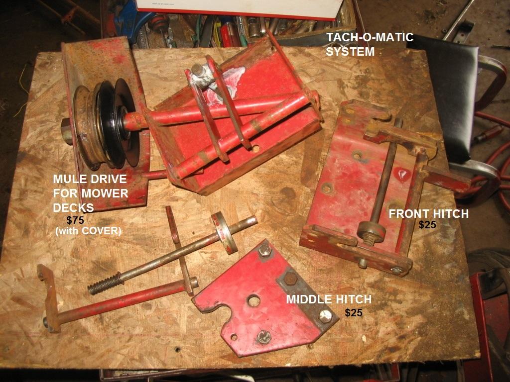

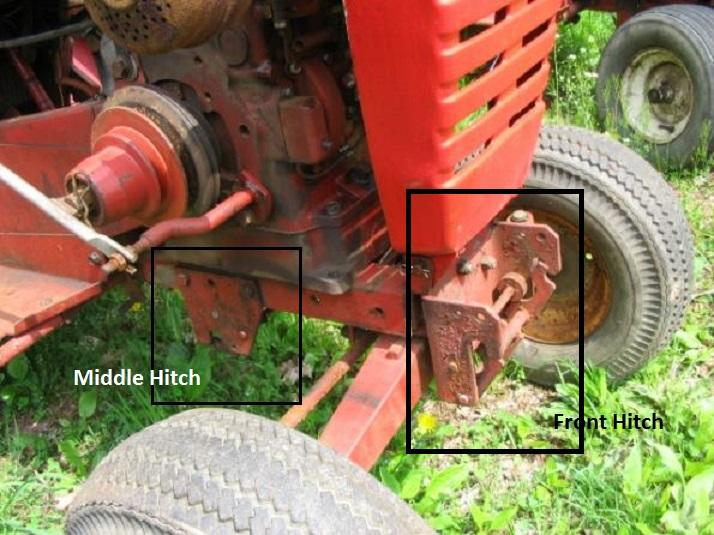

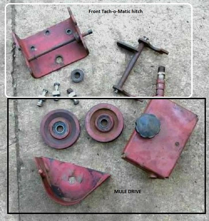

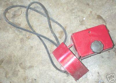

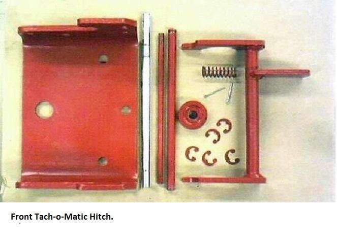

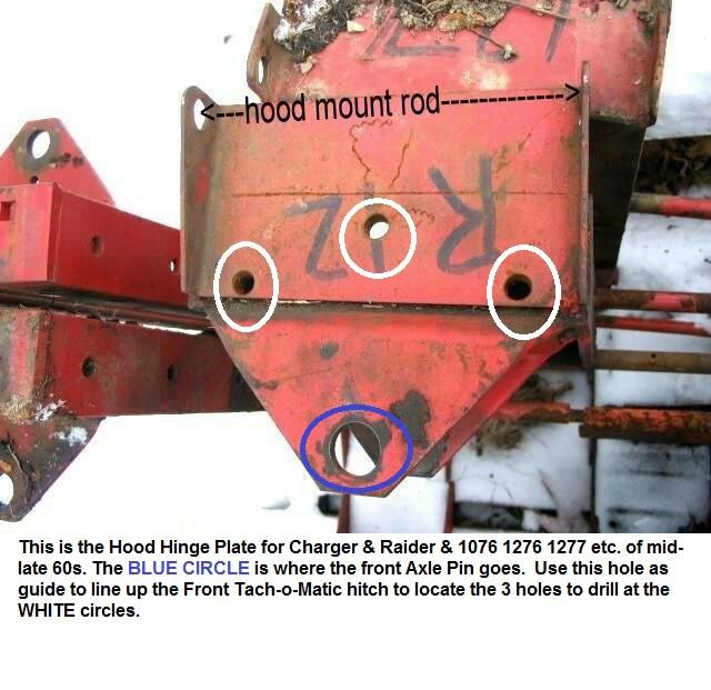

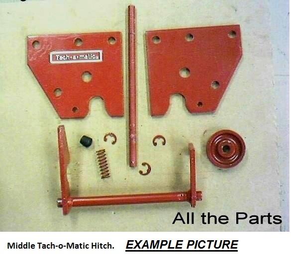

daveoman1966 3,882 #3 Posted June 20, 2018 I have a 1972 Bronco 14 with the same Sndstrand Hydro-gear power unit # 90-2046. I bought it as a dealer demo in 1973. Never had any issue with it, except for the main drive belt that I have to replace in 2005 or 2006. (32 + years service from the OEM belt...) The charger 9 shoul also have the 10-pinion LSD differential ...also a plus (for most guys). If you buy it, I'd recommend modifing it to accommodate the more modern front mule drive which can be done in an hour or so. All you gotta do is drill the from frame under the hood to accept the front tach-o-matic hitch and you'll need a different drive belt. Herre is a Raider 10 that I upgraded a few years back. I have all the parts to do this if you go that route. 3 Share this post Link to post Share on other sites

gwest_ca-(File Mod) 12,005 #8 Posted June 22, 2018 Click on the pictures below Odd that no serials have shown up for the late production unless I missed them. Perhaps the total numbers are very low. Garry Share this post Link to post Share on other sites
