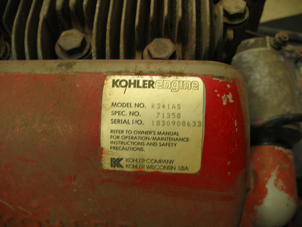

pfrederi 19,784 #1 Posted June 16, 2018 Picked up a Charger 12 that has a K341as engine. Spec Number is 71358. Looked up on Kohler engine and it is a Wheel Horse Spec. Serial number is 18309086633 which should be from 1988. Looking through various 16 hp Horse of 1988 and 1989 it seems they all show that they came with Magnums (or Onans). Any ideas what this engine might have been from originally??? Share this post Link to post Share on other sites
953 nut 63,918 #2 Posted June 16, 2018 My Kohler book only has Spec Numbers up to 71311, Don't know but Jack's seems to think it was . https://www.jackssmallengines.com/jacks-parts-lookup/manufacturer/kohler/k-series-k91-662-kt17-21/k341/k341-71358-wheel-horse-16-hp-11-9-kw-specs-71105-71384 Share this post Link to post Share on other sites
rmaynard 16,837 #3 Posted June 16, 2018 K341AS would indicate "special oil pan". How is that engine mounted onto the Charger 12? Share this post Link to post Share on other sites
pfrederi 19,784 #4 Posted June 16, 2018 They put it on 2 risers... Share this post Link to post Share on other sites
