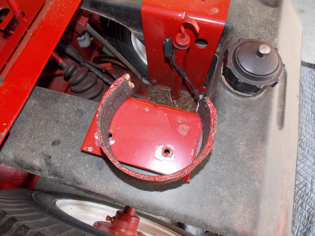

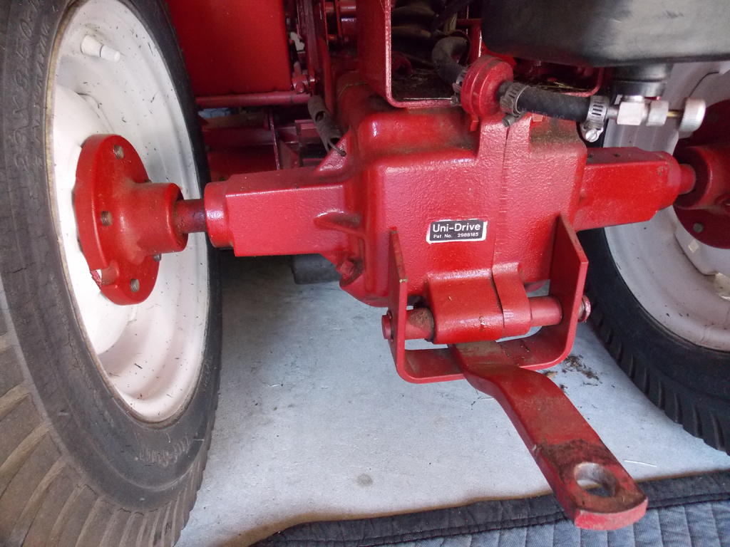

bumpsteer 38 #1 Posted June 15, 2018 Thought I would do so maint on this tractor since its new to me. Don't see a drain plug on bottom only the pipe plug on left side ( see photo) Is this where you drain?. Also when I pulled out the dip stick it was bent in an L shape never seen anything like it before. Is it sposed to be? and one other thing brake lining was shot. Thanks Doug 1 Share this post Link to post Share on other sites
BOB ELLISON 2,983 #2 Posted June 15, 2018 (edited) The drain plug is under the trans it's a 1/4" Allen plug. It's flush so if you jack it up it won't be damaged. And no the dipstick is not supposed to be bent it should be straight. Just carefully straighten it back out and it should work fine. When your drain the trans Jack the front of the tractor up to allow it to drain better there's a hump in the trans that holds oil if you don't tilt it. Go to the vendor section and we have a vendor that sells those brake linings . Looks like you broke the band that holds the lining. Here's a link to the lining . Edited June 15, 2018 by BOB ELLISON 1 3 1 Share this post Link to post Share on other sites

bumpsteer 38 #4 Posted June 16, 2018 Yep tranny fluid is draining now found that drain plug under the tow hitch easy to get out thankfully. Ordered the brake lining just now. have a new air filter on the way, and need to check valves and clean and reset points. One reason I got this tractor for a good price is that the PO rebuilt the K241AS and it is still smoking so I am trying to find the reason. Have not pulled the CC breather off yet and I may have to pull the head to see if any scoring in the cylinder. he said he did not think he cracked a ring and I guess he knew to space the ring gap but then its not that heave of smoking. Ill keep surching. Doug 3 Share this post Link to post Share on other sites
