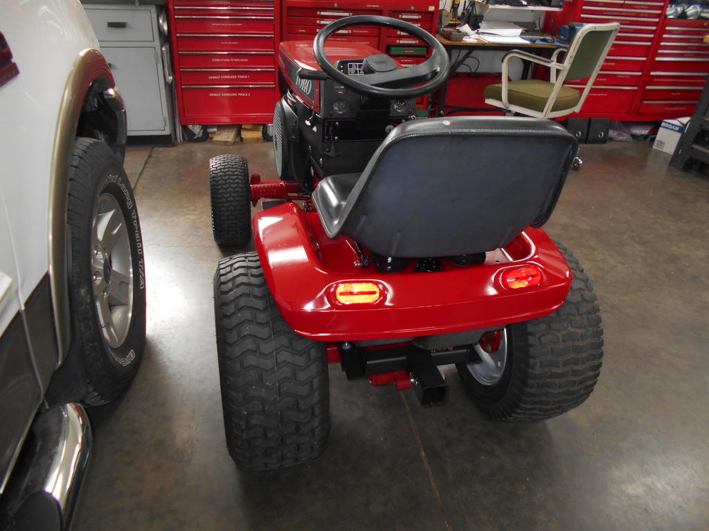

cleat 9,206 #26 Posted August 27, 2018 Rear wheels are now mounted. All that is left is the rear fender painting and taillights, then install a new seat lift support and this machine is done. Cleat 1 1 Share this post Link to post Share on other sites

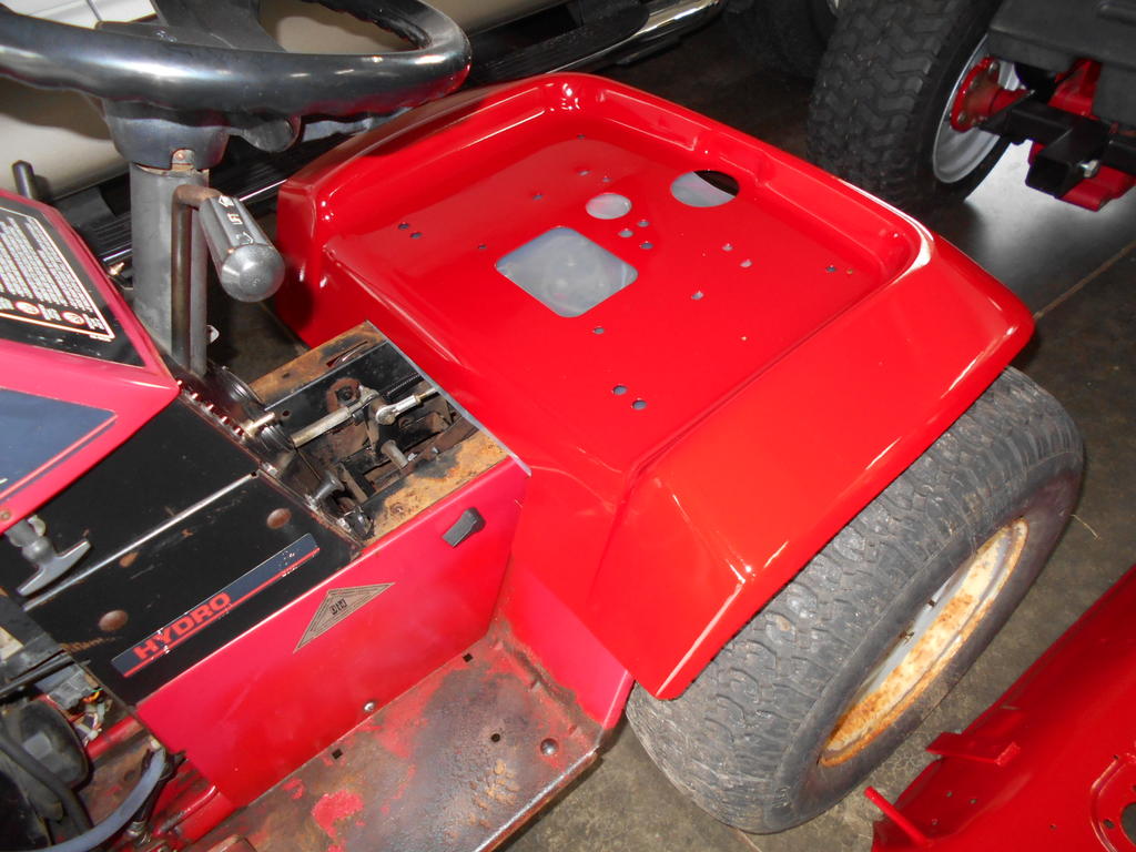

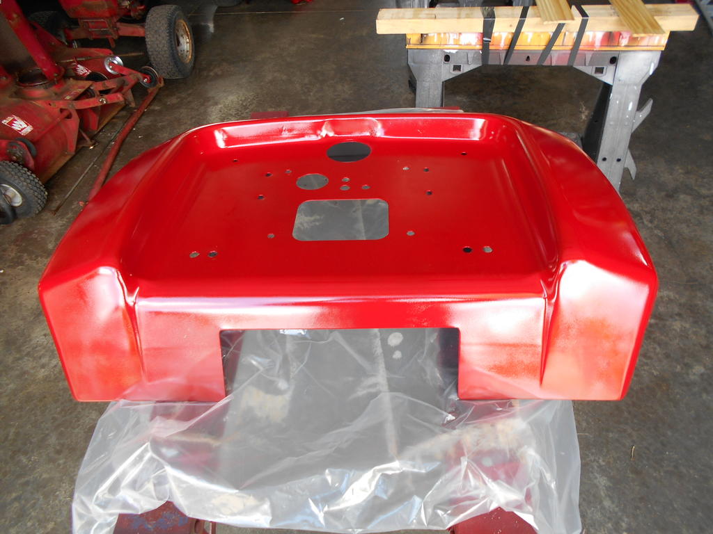

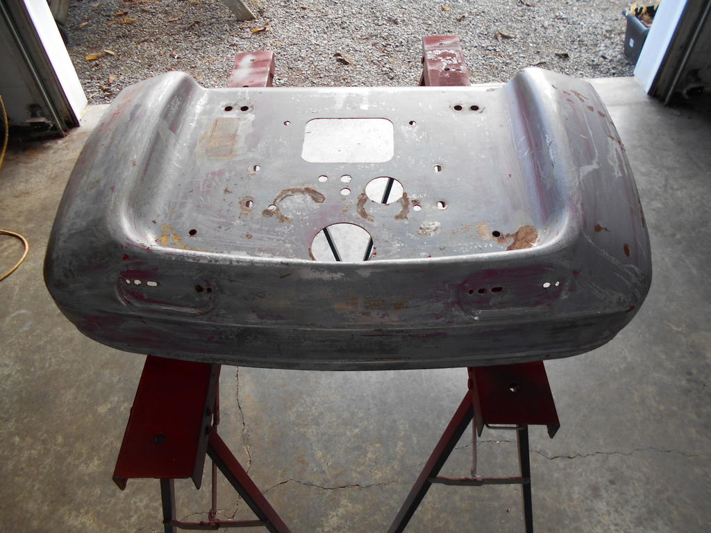

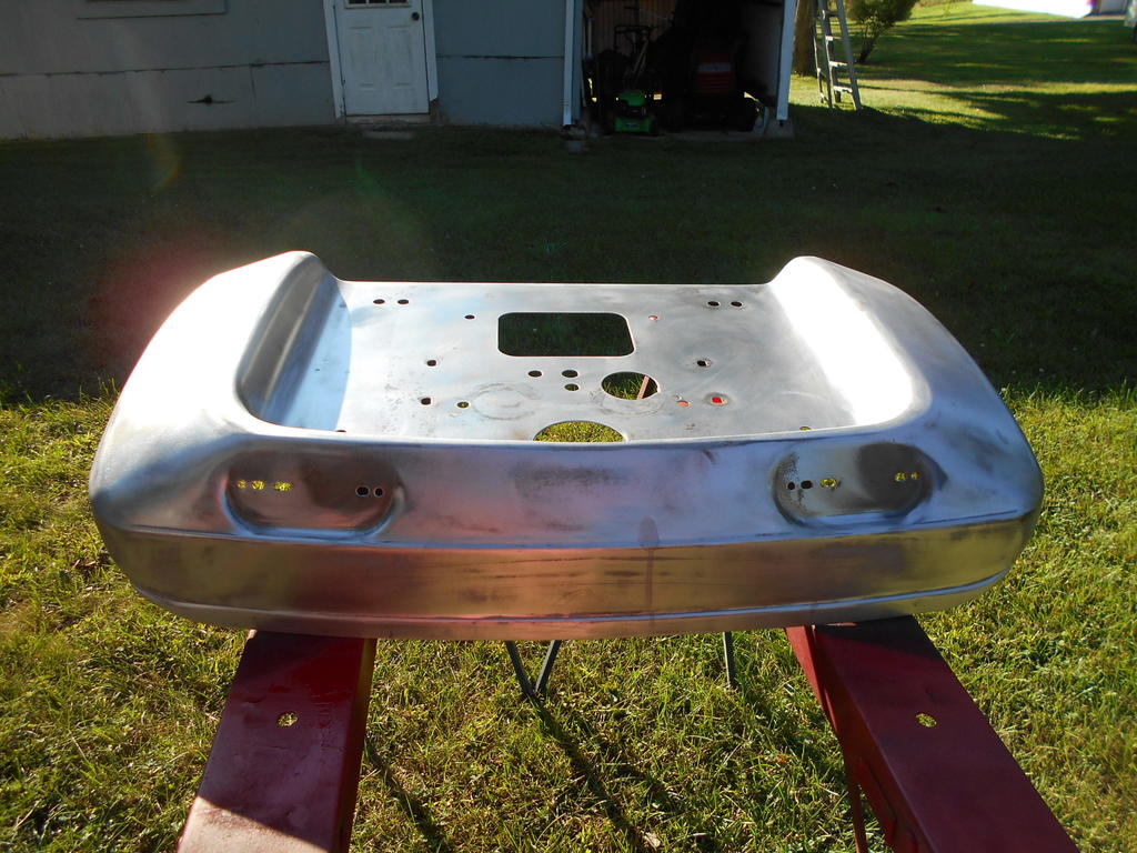

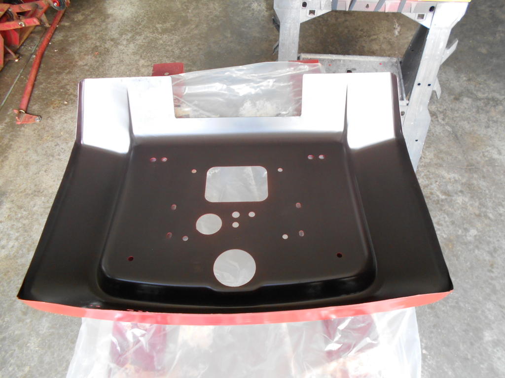

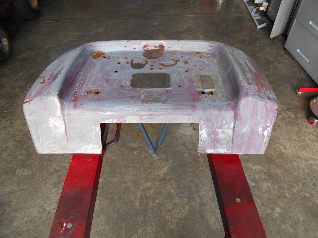

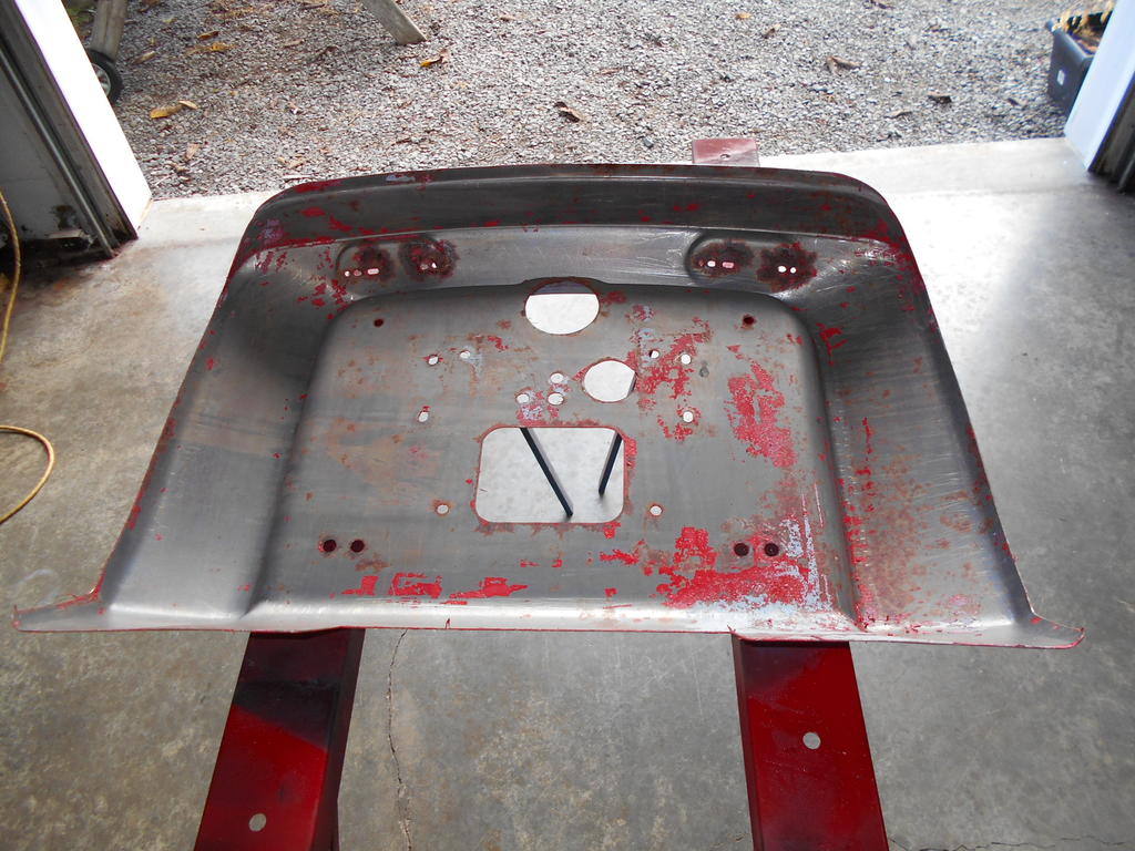

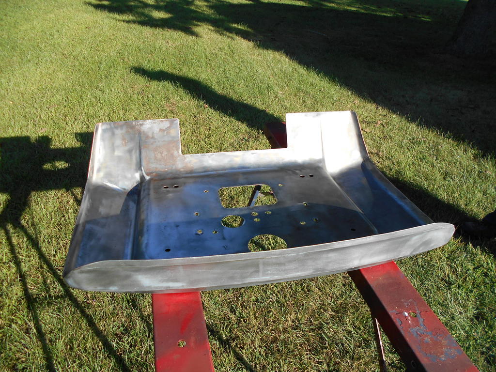

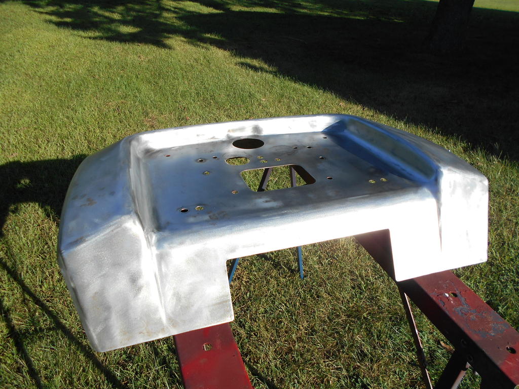

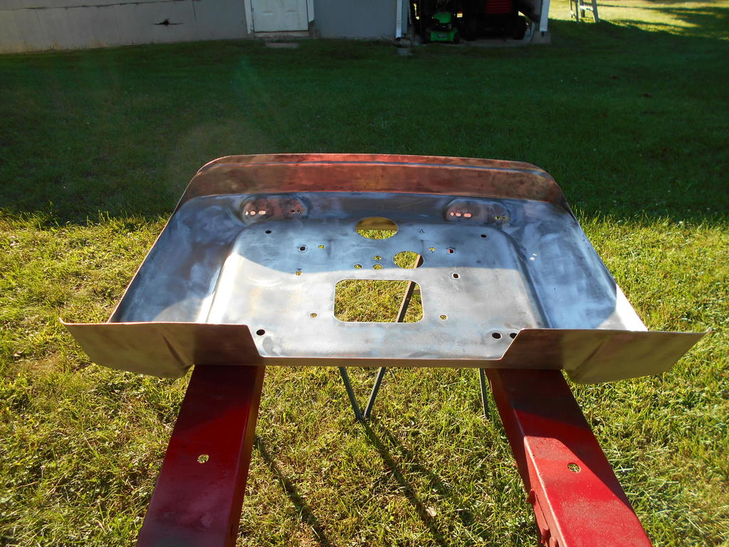

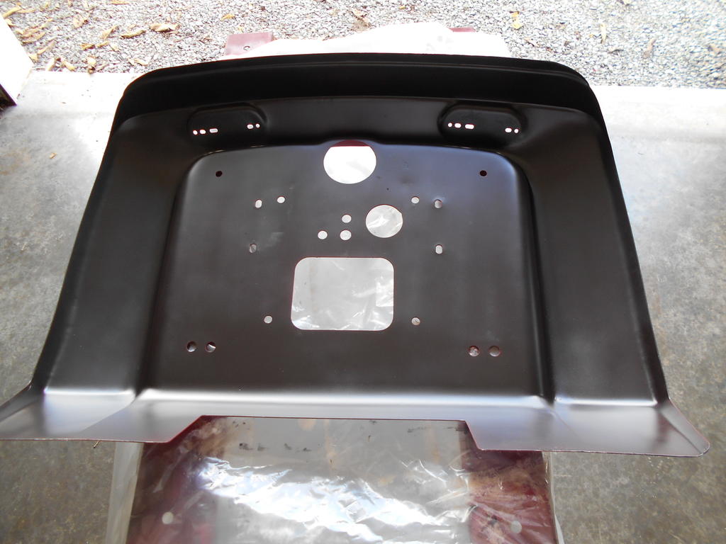

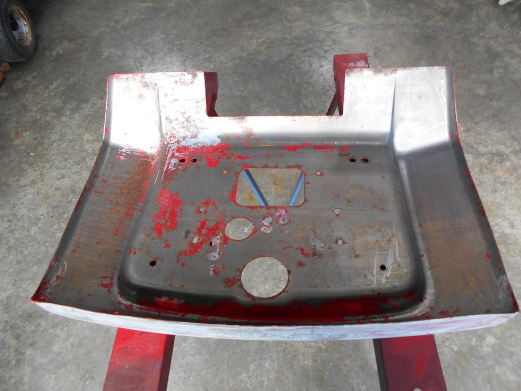

cleat 9,206 #27 Posted September 16, 2018 Well, I got the fender stripped of paint as it had many layers of flaking terrible paint. I used chemical stripping for this. Then it got wire wheeled and sanded/ Then the bottom got a couple of coats of high temp black (I like that paint for durability). Then the topside got a coat pf primer that was sanded then a coat of IH red. I will sand that and apply a second coat whenever this darn humidity clears and the paint will dry properly. Cleat 2 3 Share this post Link to post Share on other sites

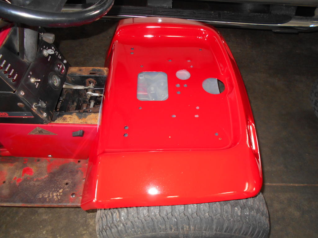

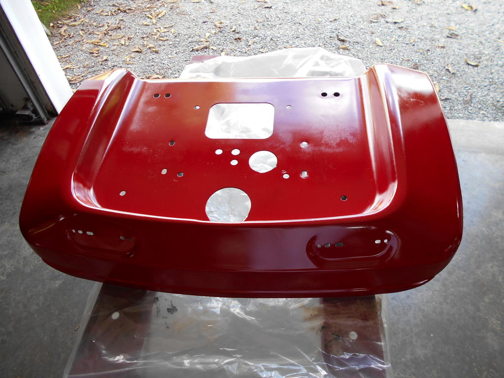

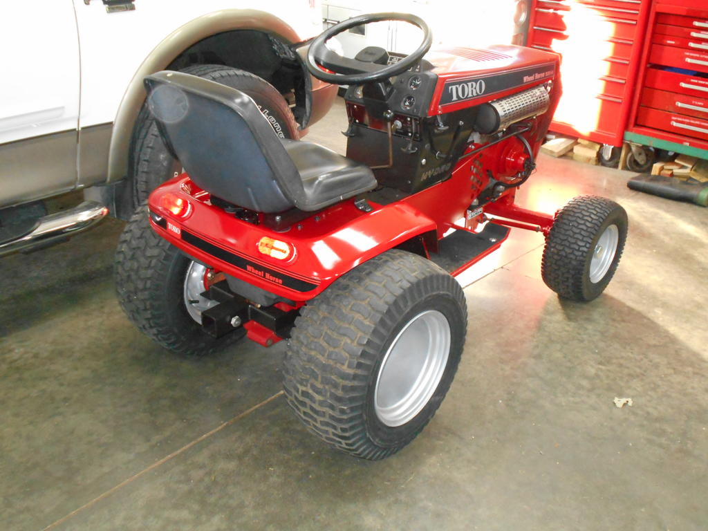

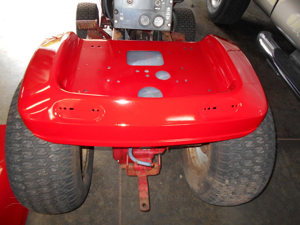

cleat 9,206 #28 Posted September 16, 2018 The paint felt dry enough so I sanded it and applied a top coat. It is much smoother ans shinier now. Fender is just sitting on a 416, not the 520. I have new tail lights from TSC to install once paint is dry. Also decal from Terry will finish it off. Cleat 1 3 Share this post Link to post Share on other sites

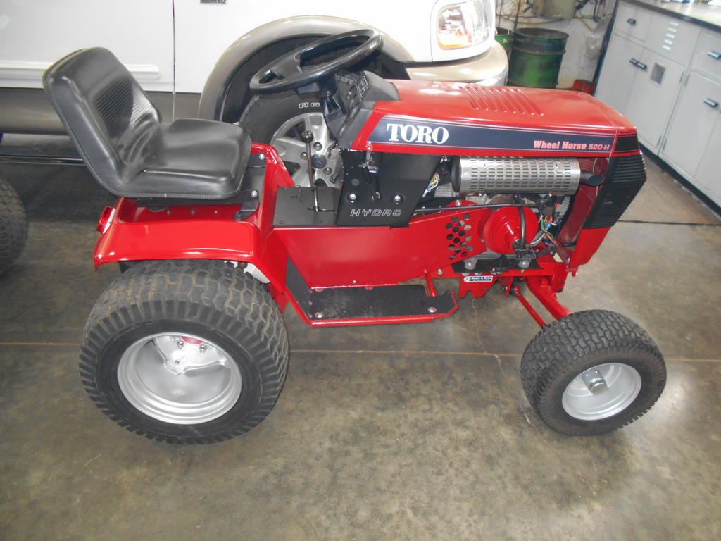

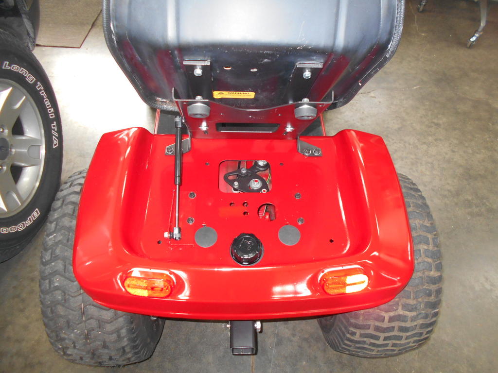

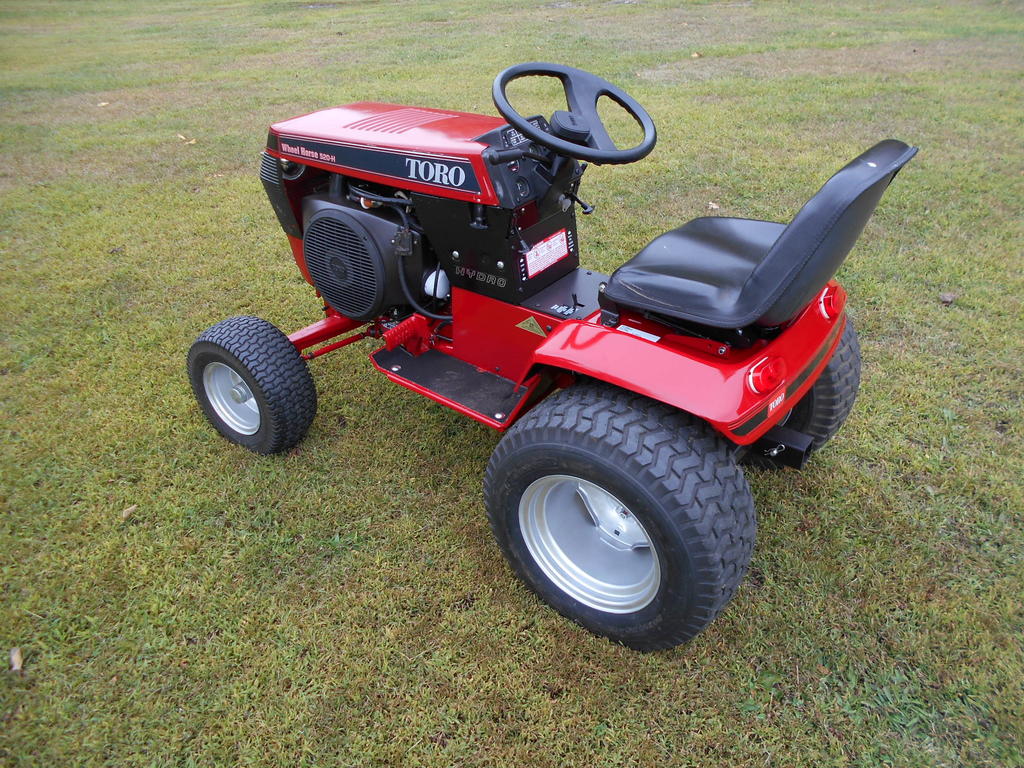

cleat 9,206 #30 Posted September 19, 2018 Tail lights from TSC installed with LED bulbs. Fender installed onto tractor. Terry's rear decal is here, just need to let paint dry some more then install that to be complete. Cleat 1 3 Share this post Link to post Share on other sites

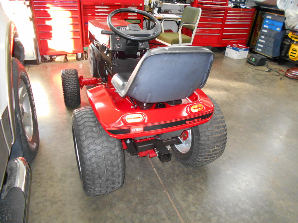

cleat 9,206 #38 Posted September 29, 2018 Decal installed on rear fender (great job Terry). Just need to install Matt's foot control and the console decals. Cleat 1 1 Share this post Link to post Share on other sites

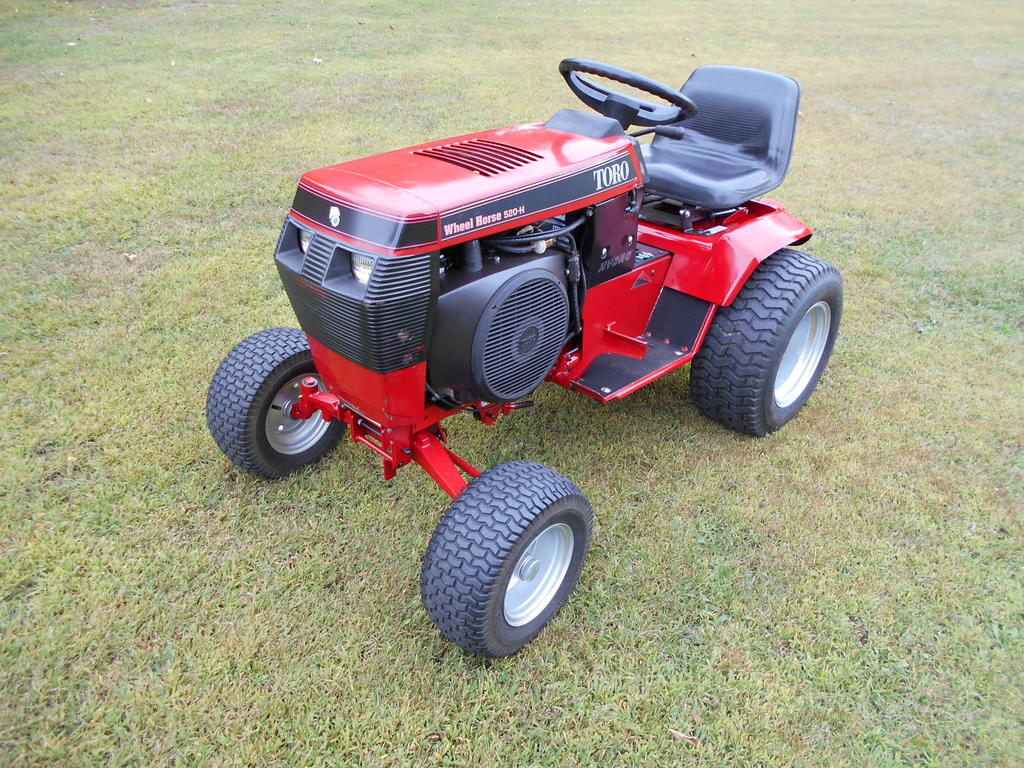

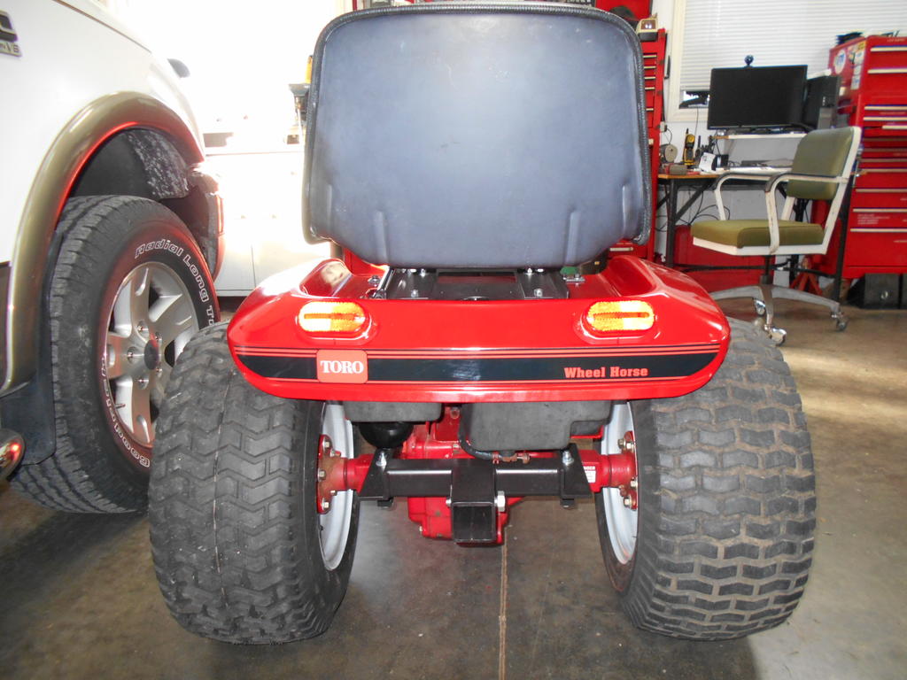

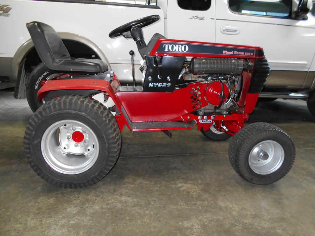

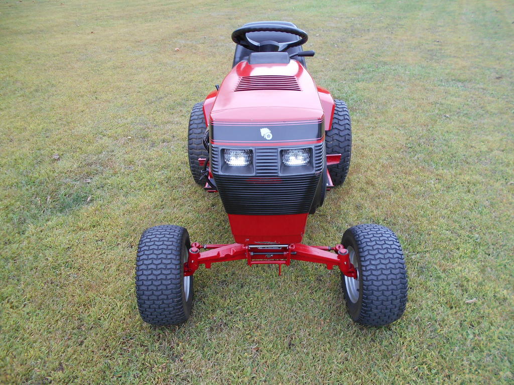

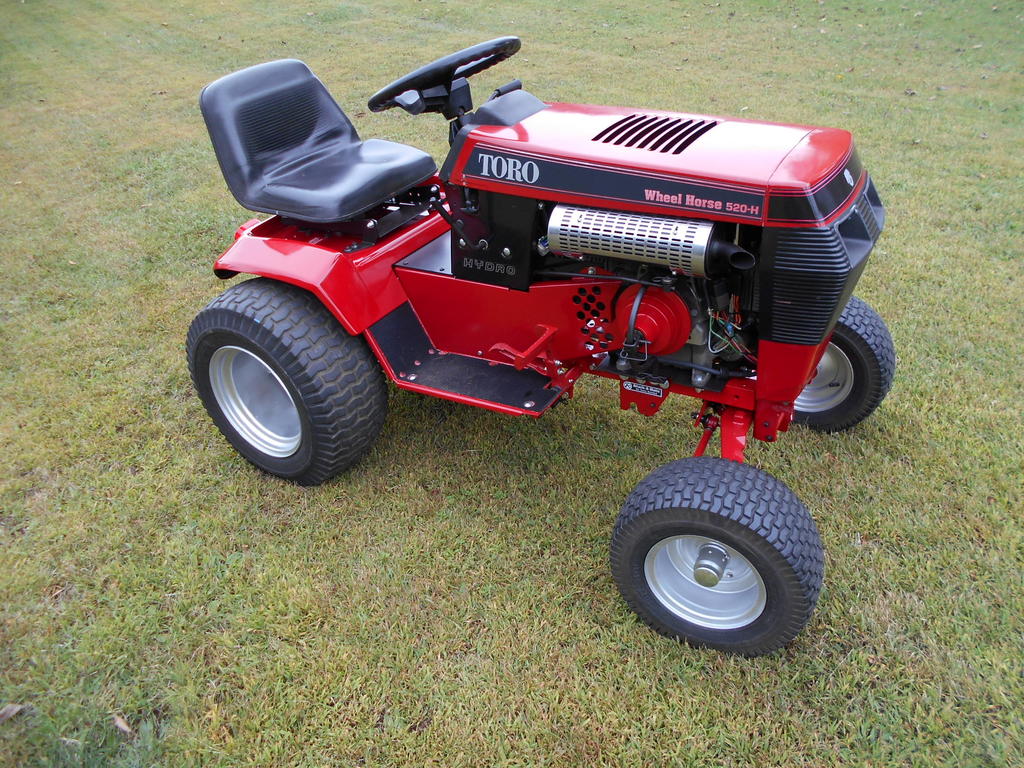

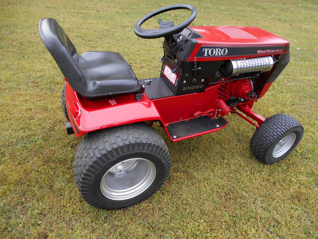

cleat 9,206 #40 Posted October 6, 2018 Tractor finally finished with Matt's foot Control and remainder of Terry's decals installed. This 520 is now a joy to drive and to look at. Thanks to Matt and Terry for their excellent products. Cleat 1 1 Share this post Link to post Share on other sites
