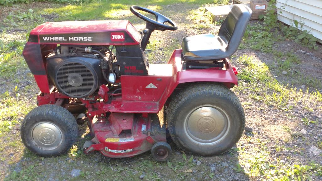

CountryRock 199 #1 Posted June 14, 2018 (edited) Local game club that I belong to has a 416H that keeps blowing fuses during operation. It will run/mow for a while and then the 25 amp fuse will blow and the tractor dies. The problem started last year and we cleaned up a bunch of electrical connections which seemed to take care of the problem for the year. Today I just learned that it's happening again. What do I need to look at to remedy this issue. Edited June 16, 2018 by CountryRock Share this post Link to post Share on other sites
lynnmor 7,727 #2 Posted June 14, 2018 You didn't say which fuse. My best guess is the 25 amp one and the likely short is in the vicinity of the seat switch. Download the Demystify Guide here. 1 Share this post Link to post Share on other sites
CountryRock 199 #3 Posted June 14, 2018 I'm not quite sure which it is, but I think it is the 25. I kinda remember them putting a 30 in it's place. I'll get that guide and probably go look at it this weekend. Share this post Link to post Share on other sites
rmaynard 16,223 #4 Posted June 14, 2018 Your problem is probably in the fuse block. Pull it out and inspect it. If in doubt, replace it. Bad design. Water can get into it and cause lots of problems, 2 Share this post Link to post Share on other sites
CountryRock 199 #5 Posted June 14, 2018 I'll check that too. Thanks. Share this post Link to post Share on other sites
gwest_ca-(File Mod) 11,393 #6 Posted June 15, 2018 It could be worn wire insulation and the last time it was worked on disturbed it's location. Wires against the steering shaft are a common fault. It will wear a flat spot in the insulation which is hard to find. In the center of the flat spot can be an almost invisible wire core but enough to blow a fuse. Before you rip things apart look for possible locations this can happen and then go after them. It may require removing the battery to get a good look. Garry 1 Share this post Link to post Share on other sites

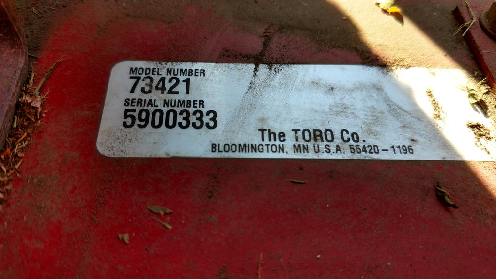

CountryRock 199 #7 Posted June 16, 2018 I made a mistake. It is a 416H, not a 520H. Took a quick look at it today. Didn't see any bad wires in the open. Cleaned up the seat switch connection. I need to put it on the jack and check under the body panels more. It was full of debris so we blew it out the best we could around the transaxle. I want to take it home and give it some well deserved tlc. It's kinda rough. Pics in the original post. Share this post Link to post Share on other sites
