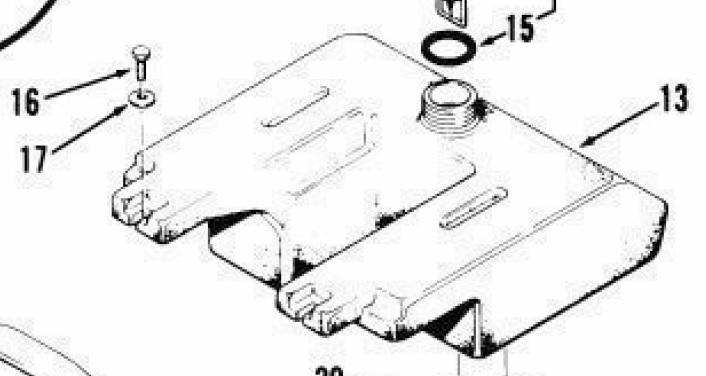

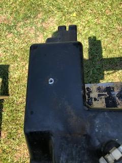

Bill Sherman 11 #1 Posted June 14, 2018 (edited) I recently purchased a 1979 C161 automatic. I'm checking it over and cleaning it up. This tractor has been stored indoors it's entire life and it looks like it too. When I removed the fuel tank there was a small amount of what smelled like old gas. and it was slightly wet around the metal threaded part embedded in the plastic. I'm not sure if it is leaking ever so slightly or if gas had been spilled at some point in time. Does anybody know if the metal ferrule goes all the way through the tank or not? Thank you very much. Below is a picture of the ferrule I'm talking about. It seems to be leaking around it. Edited June 15, 2018 by Bill Sherman Added picture Share this post Link to post Share on other sites

Bill Sherman 11 #4 Posted June 14, 2018 No, the threaded ferrule on the bottom where the tank gets bolted to the metal frame. There are two that are molded into the plastic. I was curious if they go all the way through into the tank where it could potentially leak. I’m at work right now but I’ll take a picture of it in the morning. Share this post Link to post Share on other sites
jay bee 915 #6 Posted June 15, 2018 (edited) I had a tank with this same problem, only much worse than you're describing. Mine leaked real bad. I tried a few remedies with epoxies and other things that said they could be used with fuel, but it still leaked. Then I used a good dose of Seal All around the "nutsert" or whatever it is called. Problem solved!!! Just be careful not to tighten those bolts too tight. You can purchase this at any hardware store. Edited June 15, 2018 by jay bee 1 Share this post Link to post Share on other sites
