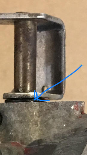

gapper 22 #1 Posted June 13, 2018 Hello all, I need some help. I let my carb in the carb cleaner all weekend and the seal at the top of the throttle shaft swelled up and is causing the shaft to have a good bit of drag when it is turned. Does anyone have these seals or know of something that will fix my carb? thanks Share this post Link to post Share on other sites

gapper 22 #3 Posted June 13, 2018 here is a pic of the seal I am looking for. Share this post Link to post Share on other sites
gapper 22 #4 Posted June 24, 2018 I got the seal free enough on the throttle shaft that it is working and the motor is running great. Share this post Link to post Share on other sites
