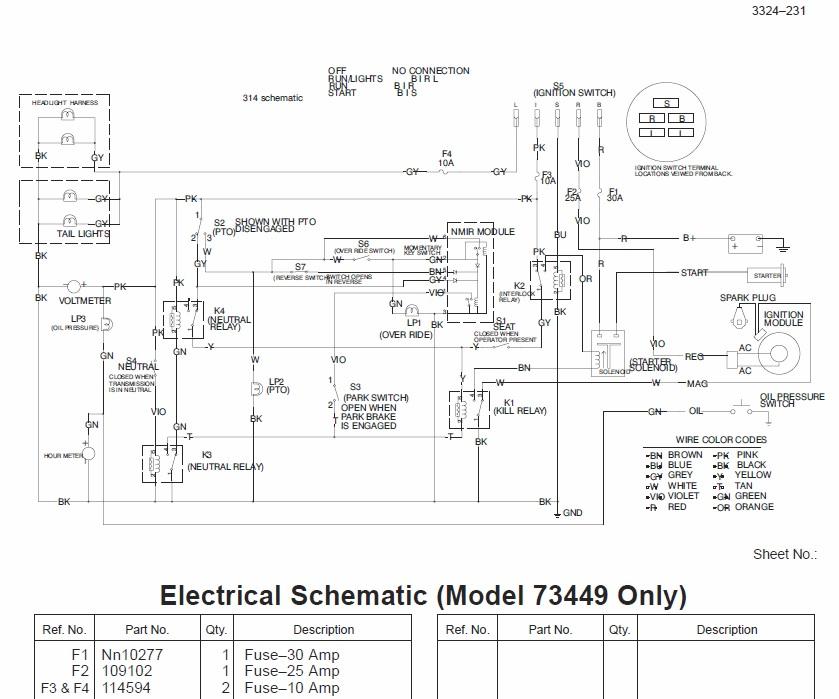

gwest_ca-(File Mod) 11,990 #3 Posted June 11, 2018 If the headlamps work and the tail lights don't the problem is wiring between the two, tail light grounds or tail light bulbs. Turn key to RUN position and do not start engine. If the voltmeter works the oil light circuit should be powered and the oil light should be on if the bulb is good and the oil pressure switch is good. Remove the wire from the oil pressure switch on the engine and the hour meter should run. Oil light if good will be on but too dim to see. Ground the oil pressure switch wire to the chassis metal or battery negative - that should put the oil light on bright and the hour meter should not work. Pause between tests to give the hour meter time to discharge and stop. Some are wound up enough to run for say 15 seconds before the next pulse winds it again for another 15 seconds. I have not figured out what bulb is used. It may be an LED. Added the electrical schematic below because the one in the detailed wiring provided in an earlier thread has this one split on 2 pages and hard to follow. Garry 1 Share this post Link to post Share on other sites
rmaynard 16,843 #4 Posted June 11, 2018 I would suggest downloading and reading the electrical demystification guide from our manuals/files section. Find your model and year, then look at all the possible diagrams that are related to the taillights and safeties. Share this post Link to post Share on other sites
