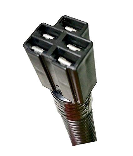

Oldcpecdr 255 #1 Posted June 9, 2018 (edited) Hi all I see several five pin connectors with leads attached labeled as "standard" on both EBay and the Amazon... is my B-100 a "standard" 5 pin ? Layout appears the same and for 12 bucks seems like a good fix. Thanks Mike B Edited June 9, 2018 by Oldcpecdr add pic 1 Share this post Link to post Share on other sites
953 nut 63,020 #2 Posted June 9, 2018 That will work just fine. Share this post Link to post Share on other sites
Oldcpecdr 255 #3 Posted June 10, 2018 Thanks ! Ordered today, seems a whole lot easier than five individual spade connectors...... Mike B 1 Share this post Link to post Share on other sites
rmaynard 16,693 #4 Posted June 10, 2018 The colors of the wires will probably be wrong, so spice your old wires by position, not color. Share this post Link to post Share on other sites
gwest_ca-(File Mod) 11,846 #5 Posted June 10, 2018 You can also relocate the wires to a different position if it helps with a color match. Click on the picture. Share this post Link to post Share on other sites
953 nut 63,020 #6 Posted June 10, 2018 The ones I have gotten have the wires separate so you can insert them as desired. Share this post Link to post Share on other sites
