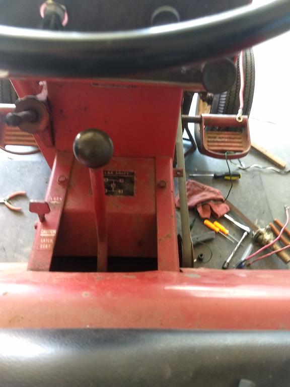

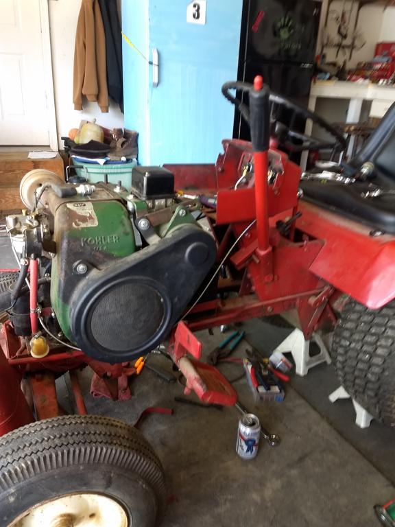

kainesdad 7 #1 Posted June 7, 2018 I was told it's a 1968 Wheel Horse but that's it it has an 8 horse Kohler k181s spec number 30198d. Serial number a 119296. The model number on the tractor is I 3715 or 45 it's very hard to make out the model number Tag. The serial number is 554063. Has three forward gears One reverse, and I just need some help so I can order a few parts 5 Share this post Link to post Share on other sites
gwest_ca-(File Mod) 11,775 #2 Posted June 7, 2018 Welcome to the forum. Added your serial number to the list where it seems to fit. Click on the picture. Garry Share this post Link to post Share on other sites
stevasaurus 23,489 #3 Posted June 7, 2018 I think Garry is right on. 1969 Workhorse 700 model 1-3745. It originally came with a Tecumseh H70, but I would keep the Kohler at this point. Nice PBR can on the floor. 1 Share this post Link to post Share on other sites
953 nut 62,530 #4 Posted June 7, 2018 As you probably know your left the factory with a Tecumseh 7 HP pull start. I think the upgrade to a Kohler is a big improvement. 1 Share this post Link to post Share on other sites
kainesdad 7 #5 Posted June 7, 2018 Yeah after downloading that file you suggested I also downloaded the chart years file and realize that things were not matching up and I'd have to agree it is not the original motor so the purpose of this supposed to begin with was putting a new ignition in needing a wiring diagram correct one for this Heinz 57 Share this post Link to post Share on other sites

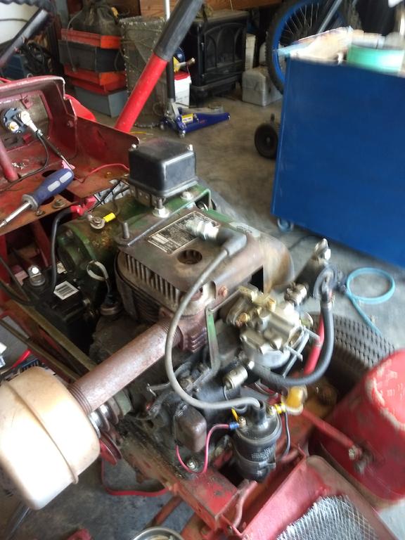

stevasaurus 23,489 #7 Posted June 7, 2018 It looks like you have the typical Kohler that has the starter/generator. It should not take much to make it a key start. Have you had it running?? Share this post Link to post Share on other sites
gwest_ca-(File Mod) 11,775 #8 Posted June 7, 2018 Here is a parts list for your engine. Wanted to see if the battery ignition was original and it is. https://www.partstree.com/parts/kohler-engines/engines-horizontal/k181-30198-kohler-k181-engine-k-series-john-deere-8hp-6kw-specs-30100-30848/ The original Techumseh with magneto used an ignition switch that was heavy enough to handle the high starter current without a solenoid. The same switch for battery ignition is 7263 and expensive. You can use a more popular switch with a starter solenoid that will likely last longer for the same money. Garry Share this post Link to post Share on other sites

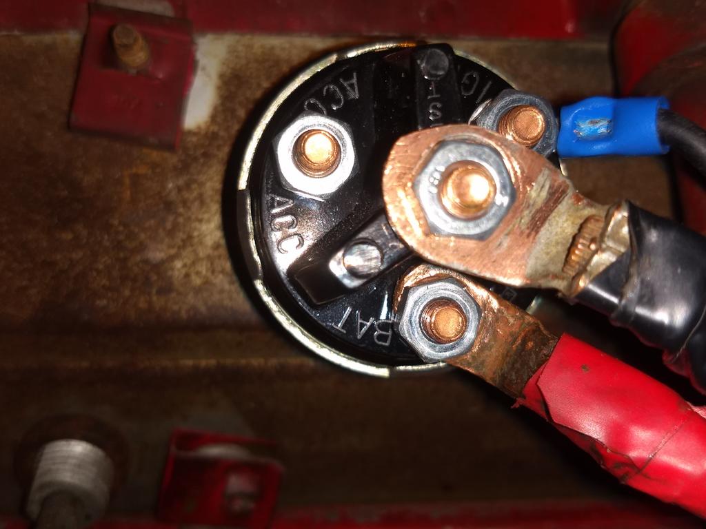

kainesdad 7 #12 Posted June 13, 2018 Ok so i wired it just like the schematic for the 855 shows and i have no fire. The only time she sparks is every time i shut the key off there is a quick spark (i a have the new plug out of it and in the plug boot laying on top of the motor) Share this post Link to post Share on other sites
squonk 44,718 #13 Posted June 13, 2018 Sounds like you need to replace the key switch. The Tecky had mag ignition and the Kohler has battery ignition. The key switch installed sounds like it's grounding out the coil which a mag switch will do. 1 Share this post Link to post Share on other sites

kainesdad 7 #15 Posted June 13, 2018 11 hours ago, squonk said: Sounds like you need to replace the key switch. The Tecky had mag ignition and the Kohler has battery ignition. The key switch installed sounds like it's grounding out the coil which a mag switch will do. Share this post Link to post Share on other sites
kainesdad 7 #16 Posted June 13, 2018 Well that sucks since it's a brand new ignition, so how am supposed to know if it's the correct one or not (if i go in search of another one) Share this post Link to post Share on other sites
gwest_ca-(File Mod) 11,775 #17 Posted June 13, 2018 I think you have a switch that should work. Hook a test light to the battery negative and probe the coil (+) terminal. Crank the motor over with the key and you should have a steady light at the coil (+). Let the key relax to the run position and the light should still be on. If you have that move the light probe to the coil (-) post. Crank the starter again and the light should turn on and off as the engine turns. Let us know what you find. Garry Share this post Link to post Share on other sites
