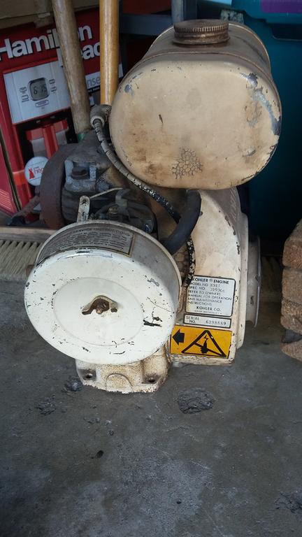

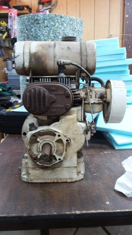

BOB ELLISON 2,983 #1 Posted June 6, 2018 I just purchased a k91t it's pretty nice looking for the age what ever that is. Will it work on a 401 or a suburban. I haven't tried to get it started yet but the PO said it ran good 4 years age. He said it came off a rototiller. Are the k91,s like the k90t,s ??? And what does the T stand for? I don't think I can use it for anything so I may bring it to the big show to sell. 1 Share this post Link to post Share on other sites

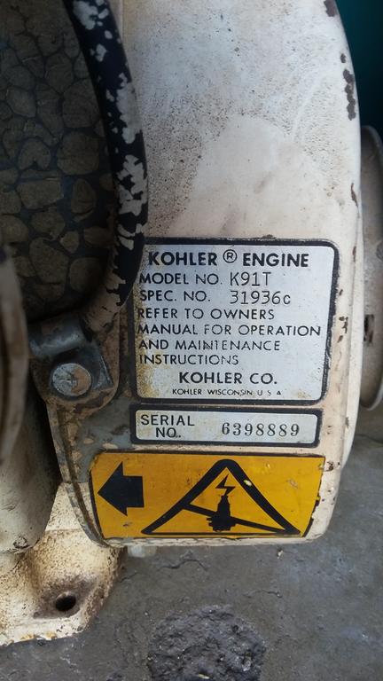

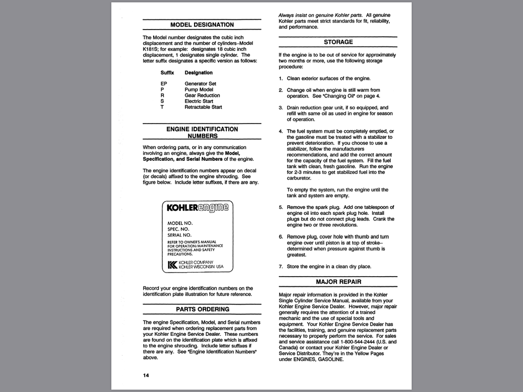

WHNJ701 4,168 #2 Posted June 6, 2018 I think the t stands for rope/manual start, and s stands for starter. I buy those up any chance I can 1 Share this post Link to post Share on other sites

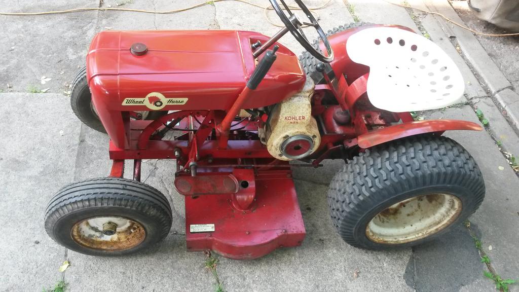

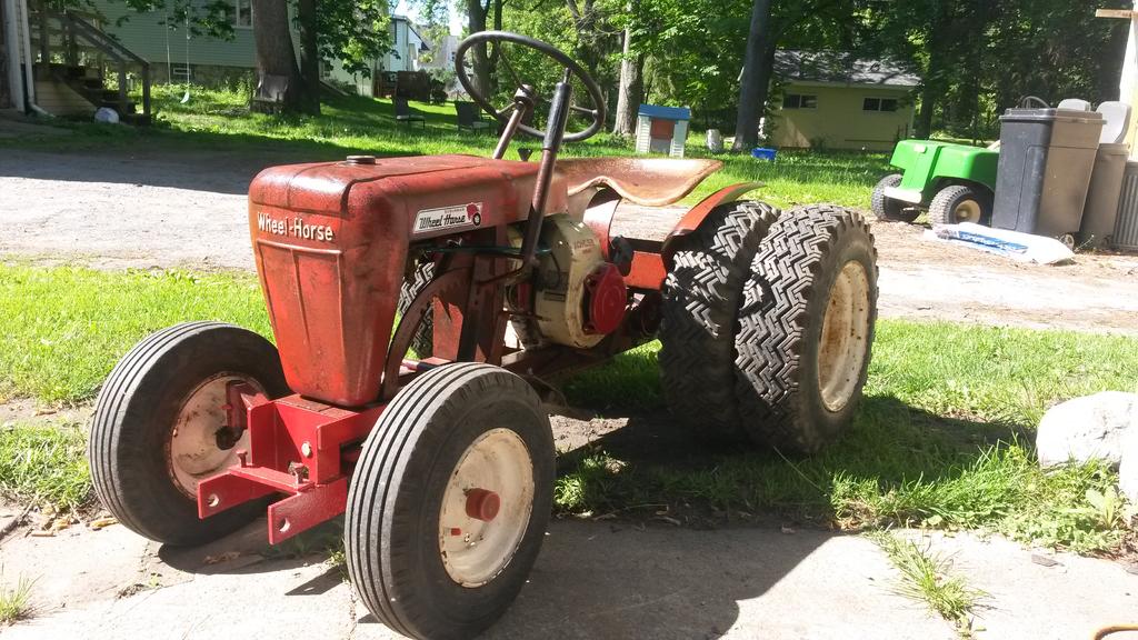

Chris G 3,363 #3 Posted June 6, 2018 It will most definitely work on a suburban or a rj. This 400 and 401 both have k91t engines. 3 Share this post Link to post Share on other sites
ACman 7,686 #4 Posted June 6, 2018 (edited) T stands for retractable start . Bob you could take it to the Big Show and I’m sure it would find a good home . is they don’t make these anymore and finding good ones is getting harder and harder . I’d keep it just for my man cave just in case you ever do come across a RJ or Suburban that you gotta have . Paint it up red buy some more memorabilia at the show make a cool display for Bob’s upholstery shop ! If you ever have to unload it there’s always a market for them . https://www.yumpu.com/no/document/view/52466431/kohler-k90-barrett-small-engine http://resources.kohler.com/power/kohler/enginesUS/pdf/ens_593_f_all.pdf Here’s you’re links to the K-series bibles Bob . Not much difference between the two . The K90 was rated at 3600RPM I believe and the K91 was rated at 4000RPM . Edited June 7, 2018 by ACman 2 Share this post Link to post Share on other sites
gwest_ca-(File Mod) 11,977 #5 Posted June 6, 2018 Kohler made serial number 6398889 in 1974. Garry 1 Share this post Link to post Share on other sites
BOB ELLISON 2,983 #6 Posted June 6, 2018 I'll clean the carb and tank and flush the oil out with deasel fuel before adding good oil. Ill Replace the hoses and see if it'll start. Thanks guys I knew I would learn something new here. 2 Share this post Link to post Share on other sites

Brent Fabian 57 #8 Posted June 9, 2018 On 6/6/2018 at 1:26 PM, BOB ELLISON said: I just purchased a k91t it's pretty nice looking for the age what ever that is. Will it work on a 401 or a suburban. I haven't tried to get it started yet but the PO said it ran good 4 years age. He said it came off a rototiller. Are the k91,s like the k90t,s ??? And what does the T stand for? I don't think I can use it for anything so I may bring it to the big show to sell. A k91T came standard on the 400. I'm guessing a 401 is similar 1 Share this post Link to post Share on other sites
