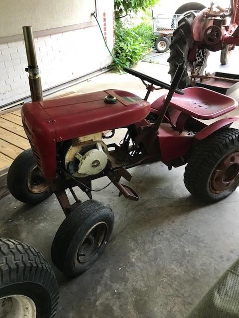

Kagnew66 15 #1 Posted June 2, 2018 An engine with a similar blower housing came on a tractor I just bought. Mine has a recoil starter and nine head bolts. Can't find any numbers, and want to start it before I take it apart. Looks similar to a Model 14, but 14 doesn't show this housing embossment. Thanks for your help. Share this post Link to post Share on other sites
WHNJ701 4,168 #2 Posted June 2, 2018 (edited) Looks like a 143302, air vane gov 5 3/4hp Edited June 2, 2018 by jabelman Share this post Link to post Share on other sites
gwest_ca-(File Mod) 11,980 #3 Posted June 2, 2018 There should be numbers stamped into the fan shroud. May be facing the air cleaner so try removing it. Garry Share this post Link to post Share on other sites
Kagnew66 15 #4 Posted June 3, 2018 Thanks. I'll look there. It does have fire at the plug, I'm hoping it will crank with new gas. I'm assuming it's not original on this tractor? Share this post Link to post Share on other sites
