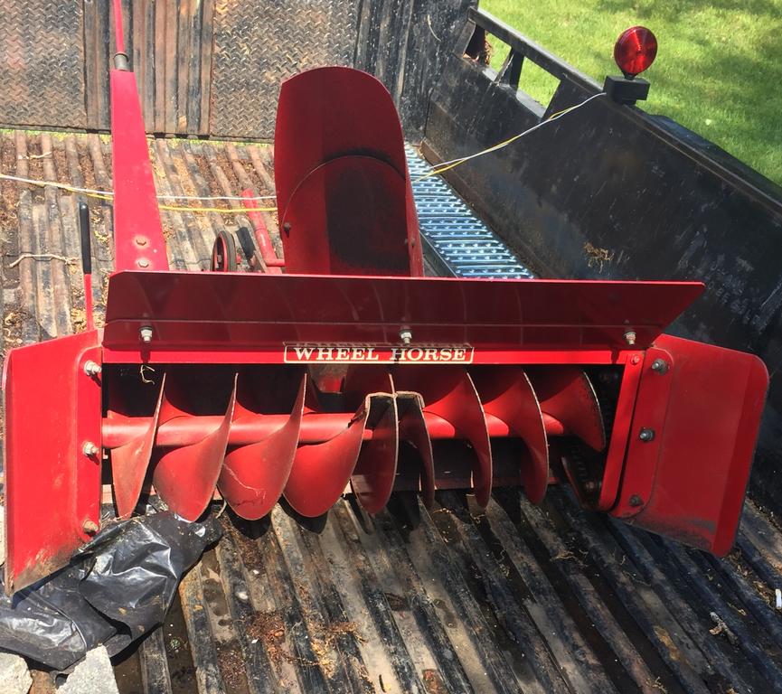

Jake0030 47 #1 Posted June 1, 2018 Actually, I don’t think anyone would make an argument there is ever a bad time to pick up a new impliment; am I right? 42” snow thrower. I can definetly wait until winter to try her out. Sorry I’ve Been absent as of late. Busy and healing. 10 3 Share this post Link to post Share on other sites
peter lena 9,431 #2 Posted June 1, 2018 got the same model, use it on my 312-8, lubrication is vital on the gear and chain drive, I use LUBRIPLATE , CHAIN AND CABLE FLUID, before and after every use, also on the bottom of chute base and cable on rotator. also on the double pulley tension frame at mounting points . that allows it to easily follow spring tension. it spins up with no effort , with regular lubrication, also use the snow chute lube, helps throw ,minimize build up. I use a Kevlar belt , very solid no wear or problems, D&D BELTS , eBay. using a heavy lift spring from tractor supply, really helps on lift . auger looks good , keep after it , keep those moving parts wet with oil . good pick up , Pete 2 Share this post Link to post Share on other sites

Jake0030 47 #4 Posted June 2, 2018 (edited) Thanks for the helpful advice Peter!!! When you're on a budget nut, there is no other option. Quick question for anyone who wants to chime in- Your opinions on a taller chute? Pros, cons or indifferent? Edited June 2, 2018 by Jake0030 Share this post Link to post Share on other sites
peter lena 9,431 #5 Posted June 2, 2018 answer , what is your snow like? if its dry and fluffy, tall chute is the way to go, if its wet snow , stay with the short chute. I also have a mid length chute, that I picked up , home made, that works quite well, about " 6 longer. whenever you use it , pay attention to what works / doesn't work. that will get you spot on .Pete 2 Share this post Link to post Share on other sites
Jake0030 47 #6 Posted June 2, 2018 Thanks Pete. I have wet snow and lots of it. 1 1 Share this post Link to post Share on other sites

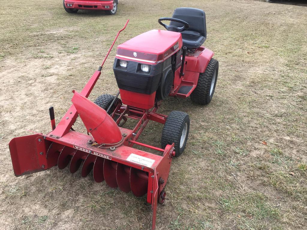

Jake0030 47 #9 Posted November 3, 2018 Is it ok to be afraid of this thing? I feel like I have the Terrafirmanator from Gnomeo and Juliet when it comes to throwing snow - https://www.youtube.com/watch?v=Mc2iCjnTnN4&ytbChannel=null. This thrower seems unnecessarily powerful !!! Photo taken before putting on chains. Too sore to put the wheel weights on today; will put them on tomorrow. Thanks again for the help Pete! 2 Share this post Link to post Share on other sites
Herder 2,355 #10 Posted November 3, 2018 Keep the pets and small children a way from it. I love the way they work, I've used mine for years. They really throw snow. I run mine on a c160 with a hydraulic lift, it makes better height control. Best of luck. 1 Share this post Link to post Share on other sites
gwest_ca-(File Mod) 11,710 #11 Posted November 3, 2018 On 11/1/2018 at 7:42 AM, Jake0030 said: Does anyone know if the 06-42S-T04 takes the 5/8 69" belt or the 5/8 77" belt when being hooked up to a 312-8? Thanks in advance 5/8" x 69" Make sure you get a belt designed to bend backwards over the flat idler. The Gates green belts from Napa are designed for that and there are others. Click on the picture Garry 1 Share this post Link to post Share on other sites
WVHillbilly520H 10,376 #12 Posted November 3, 2018 (edited) 14 hours ago, Jake0030 said: Is it ok to be afraid of this thing? I feel like I have the Terrafirmanator from Gnomeo and Juliet when it comes to throwing snow - https://www.youtube.com/watch?v=Mc2iCjnTnN4&ytbChannel=null. This thrower seems unnecessarily powerful !!! Photo taken before putting on chains. Too sore to put the wheel weights on today; will put them on tomorrow. Thanks again for the help Pete! How about this Terafirmanator in the videos below, BTW those single stage throwers work just fine, Jeff.https://drive.google.com/file/d/1RUlEVGcTglFrPs5Okb0oy62fq0oQQ5fJ/view?usp=drivesdk VIDEO0001.mp4 VIDEO0077.mp4 Edited November 4, 2018 by WVHillbilly520H 1 Share this post Link to post Share on other sites
