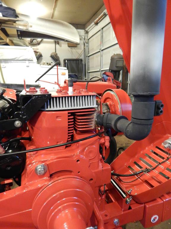

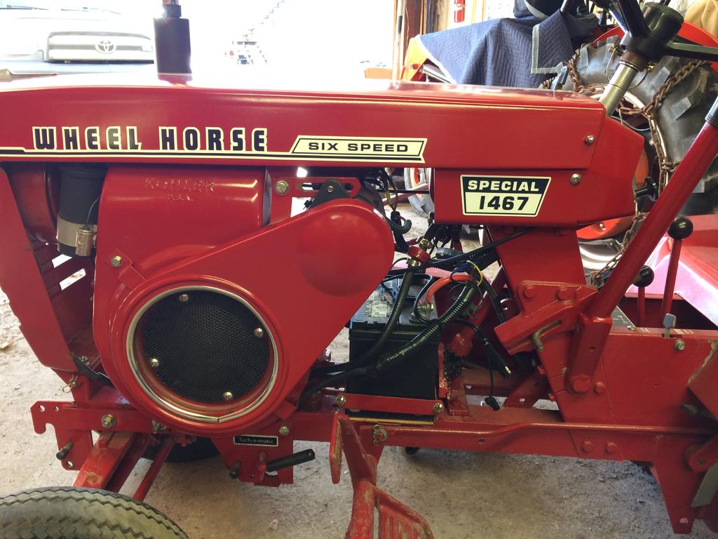

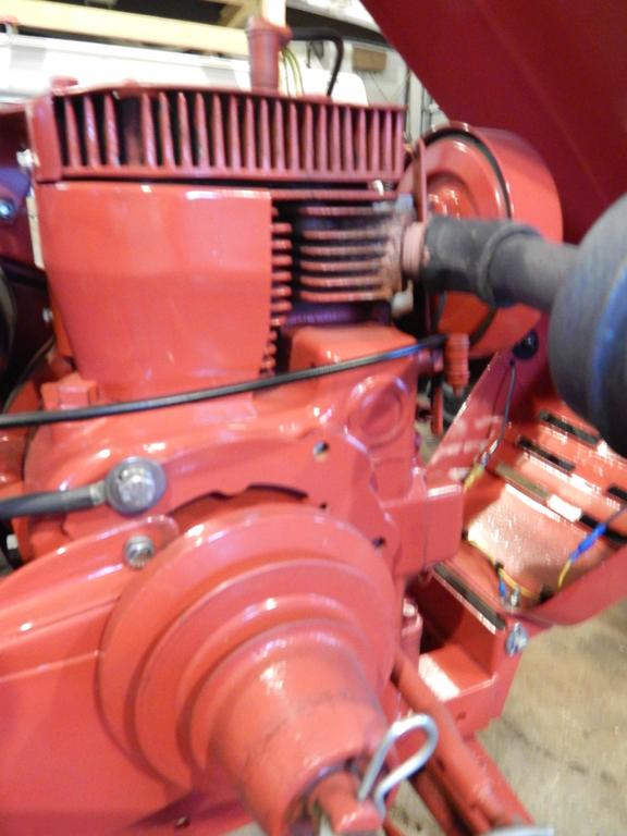

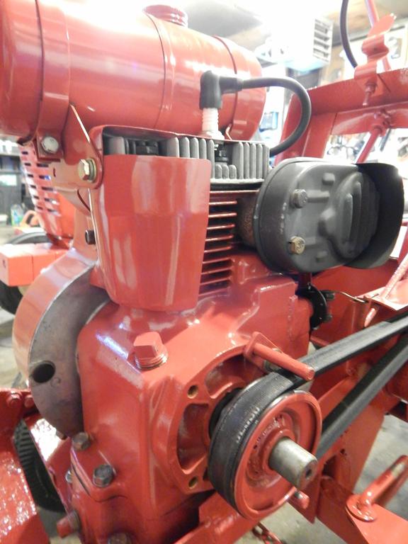

Achto 31,021 #10 Posted May 29, 2018 2 hours ago, ebinmaine said: That would be cool. Thanks Dan. Here are a few examples for you Eric. These engines were all painted with VanSickle acrylic enamel, an automotive grade single stage paint. First my 1076 with a K241. This engine has just over 32hrs. of medium to light duty and was painted in the spring of 2015. I should have blasted the paint off of the cyl head before assembly on this one. The paint is sticking to it just fine but I would rather it bare for better cooling. Next is my McLean with a K91. This engine has about 10hrs. of very light duty and was painted in the spring of 2017. Last is my Raider 12 with a K301. This engine has about 3hrs. on it, most of which were spent pulling a 10" mold board plow. It was painted in the spring of 2018. The exhaust stack has 1500 degree paint on it. As you can see the paint only seems to discolor around the exhaust port. Hope these help. 1 Share this post Link to post Share on other sites
ebinmaine 77,370 #11 Posted May 30, 2018 1 hour ago, Achto said: would rather it bare for better cooling Good info there... And thanks for the pics!! 1 Share this post Link to post Share on other sites
953 nut 64,143 #12 Posted May 30, 2018 21 hours ago, Achto said: would rather it bare for better cooling. When it comes to cooling an air cooled engine the greater the cooling area and the less foreign (thermal insulating) material there is in the way the better. Lots of people spend countless hours filing and sanding all the little nibs off of the fins not realizing that they are reducing the surface area in contact with the cooling flow, this results in laminar air flow which is the least effective cooling flow. Then they paint it so there will be an insulation layer between the cooling air flow and the fins. Fortunately these ten to be trailer queens that don't get worked hard so all is well. 1 Share this post Link to post Share on other sites
