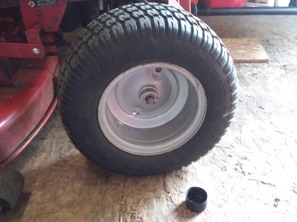

Cee245 852 #1 Posted May 24, 2018 Hey all, Replaced the front bearings and cleaned her all up. BUT, It looks naked. Lol Where can I get new plastic caps for the front spindle? I lost one last year and the one pictured has fallen off a couple times but I was able to recover it. Thanks Cory B Share this post Link to post Share on other sites

doc724 925 #4 Posted May 24, 2018 If you want repro parts, Glen is the source. However, an alternate is to buy the caps (new ones from Toro) for a late model 300 series tractor. Late model means 1998 and later. When you buy the cap, it comes with a thick and larger thrust washer to put over the bearing. The cap snaps over it and will not fall off. The retro parts are nice, but more than once I have lost one. Yes, I find it later in the grass with a big slice in it from the mower. 1 Share this post Link to post Share on other sites

Cee245 852 #6 Posted May 26, 2018 I looked up a 315-8 model number 73450 The cap is part # 61-9780 And the washer that the cap goes on seems to be 28-2480. I can't see where buying the cap comes with the washer. Share this post Link to post Share on other sites
doc724 925 #7 Posted May 26, 2018 I cannot remember ordering the washer separately, however it was 4 years ago and with age, the memory is not so accurate. I likely did buy them from Jacks Small Engines. Share this post Link to post Share on other sites
