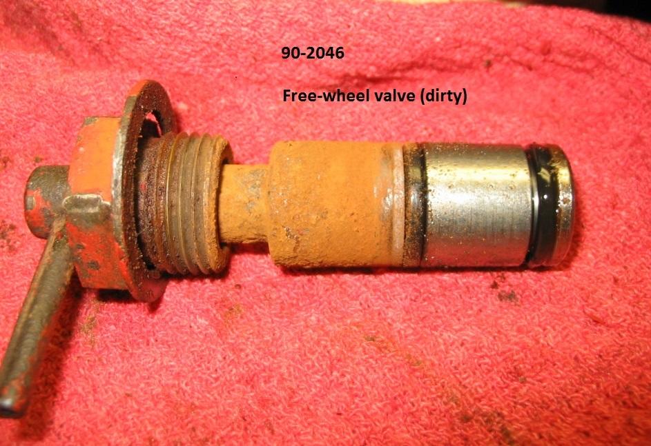

WHNerd 8 #1 Posted May 24, 2018 1969 GT14, I'm unable to turn the tow valve. Anyone have a secret to unfreeze that little sucker? Thanks:-) Share this post Link to post Share on other sites
stevasaurus 23,517 #2 Posted May 24, 2018 What kind of wrench are we looking at here. I have a 1/2" head on my 876. I think some are Allen Head, etc. Which one do you have.?? Share this post Link to post Share on other sites

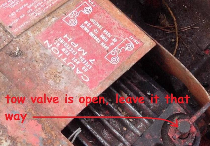

953 nut 63,112 #3 Posted May 24, 2018 On the GT-14 the tow valve is a "T" handle at the top, if the packing nut under it is backed off a turn or so it may turn easier. 2 Share this post Link to post Share on other sites

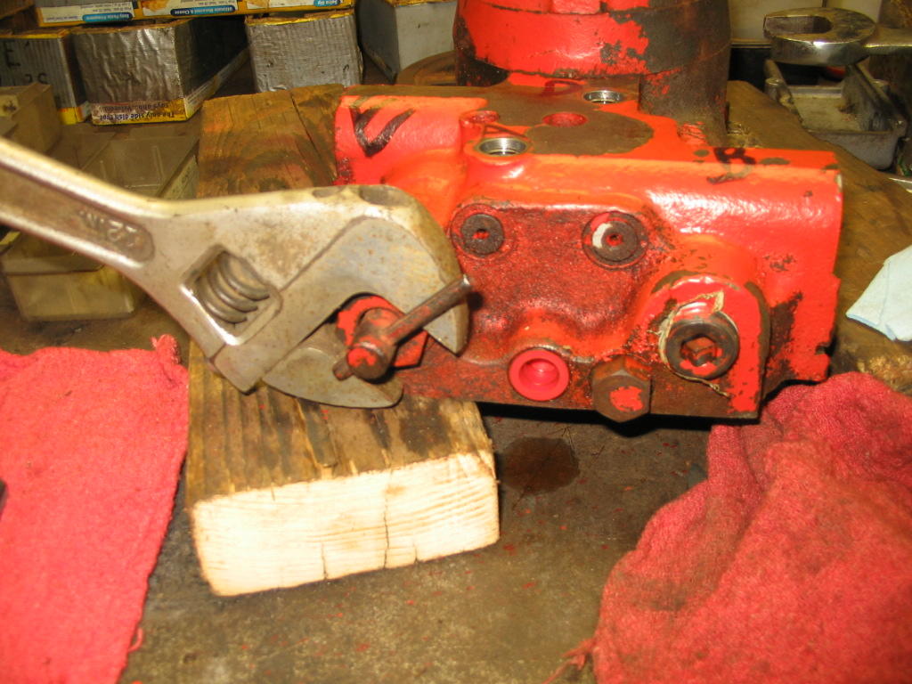

daveoman1966 3,881 #4 Posted May 25, 2018 (edited) Vise grips TIGHT onto the round stem (not the T handle). Give it a QUICK rap and it should break loose. Maybe use a crescent wrench on the Hex nut and remove the entire valve assembly. i Edited May 25, 2018 by daveoman1966 1 Share this post Link to post Share on other sites
WHNerd 8 #5 Posted May 25, 2018 I've got the hex nut loose, but it's the valve itself I can't get out. Thanks Share this post Link to post Share on other sites
Sarge 3,470 #6 Posted May 25, 2018 Start soaking the valve shaft with a good penetrating oil such as AeroKroil, ect, for a few days - it will eventually come loose. One of the best tools I've found is an automotive stud remover - the T-handle style above will require driving out the pin first, but this tool grabs the round stem very well. If whatever method you're using is starting to mangle the shaft, stop - let it soak more before snapping that thing off. Once broken, removing that valve becomes a lot more complicated in a hurry. Same with the older style slotted head valve stems, patience is the key. I have had to heat the valve shaft on more than one Sundstrand, but that will require new seal rings - available from LJ Fluid power if you have the part numbers/drawings for your transmission. Many require removing the nut completely to get the penetrant down where those seals rest, just fyi... Sarge Share this post Link to post Share on other sites
daveoman1966 3,881 #7 Posted May 25, 2018 The best penetrant I've ever found is FREE-ALL. Its a little pricey, but hasn't failed me yet. Auto parts stores or Amazon. Share this post Link to post Share on other sites
WHNerd 8 #8 Posted May 25, 2018 Thanks for your help. I sprayed PB B'laster, left soak over night and was able to get the valve out today. I'd say the valve was hardly, if ever used since 1969;-( OBTW Dave L, I bought a Sundstrand 90-2046 Hydro from you about 10 -12 years ago and it is still going strong, I put it on my 1968 Electro, plowed a lot of snow with it, plowed, disc, and cultivated my garden. That is a great WH!!!!! 1 1 Share this post Link to post Share on other sites
