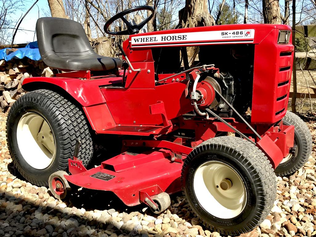

Al C. 1,429 #1 Posted May 24, 2018 I have a Wheel Horse SK486 with a Koehler 341 16hp engine. Both are in “mint” condition. I have noticed that the engine seems to labor if I put it to any heavy work immediately after starting. There is no smoke or coughing, it just sounds like it is working hard. After five minutes (warm up) the condition goes away and the engine can handle any load without breaking a sweat. Should I be concerned? Is this an indication of a problem? 4 1 Share this post Link to post Share on other sites
