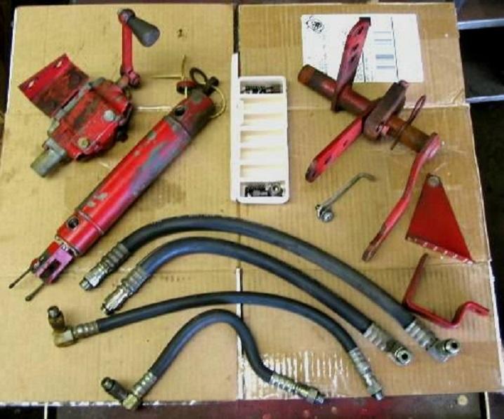

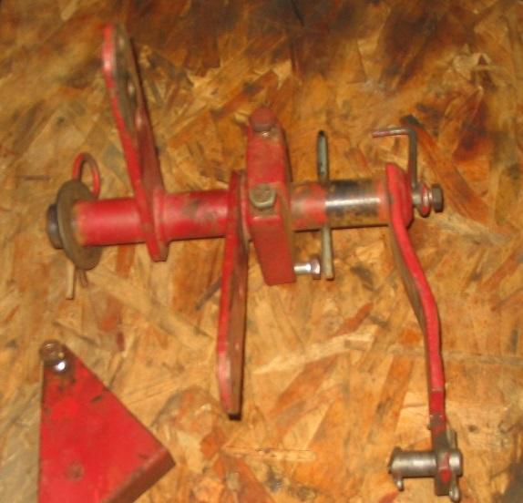

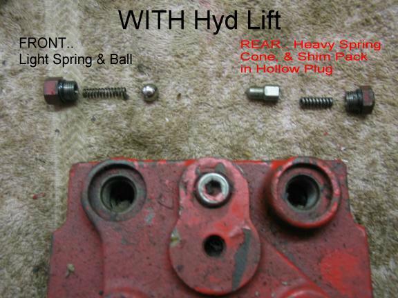

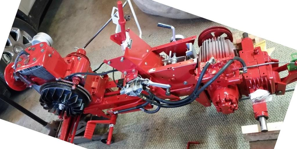

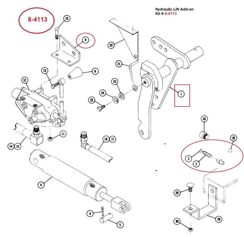

daveoman1966 3,882 #2 Posted May 24, 2018 If you can find the right parts, you can add the hyd lift to the C-120. I have SOME of the parts needed and others can be had on ebay or maybe the classified section here. The Charger hyd system is considerably different from the C-120 as the Sundstrand units (90-2062 vs 90-1136 or 90-1140) have different hyd line connections and ram cylinder is also diff. I will try to post some pics... One of these pics is a stripped-down Charger 12 and should be like yours. Others are what's needed to add a hyd kit to a C-120 It would be MUCH EASIER to work with you on this thru separate emails...outside of Red Square. Send me an email for further info.. I am: daveoman@windstream.net 1 Share this post Link to post Share on other sites
953 nut 64,278 #3 Posted May 24, 2018 9 hours ago, mikeeyre74 said: There is a guy on craigslist selling a hydrostat out of a C120 for a reasonable price. I’m wondering if I should pick that up and run it? One word of caution, can the seller's statement that Hydro is good be trusted? There are lots of sad stories about people buying a used Hydro only to find out that it isn't any good. If it ends up being a bad unit then you can use the axles and differential on yours. If you do the swap I think you should be able to use the parts Dave showed here from your old unit to convert the replacement to a Hydro Lift. You already have the hoses, cylinder and rockshaft etc. Share this post Link to post Share on other sites
mikeeyre74 290 #4 Posted May 24, 2018 Yeah, I don’t think it was clear enough in my original post. I was still looking to use my charger trans axle if possible, and just swap the axles from the 120 into that case. That way, I don’t have to change any of the hydraulic ports, springs, etc. to make it work. My charger already has hydraulics. My concern was that the axles on the 120 would be different from the axles on the charger, because of the different differentials. Also, even if the 120 transmission was known to be good, it doesn’t have hydraulic lift, and since that is a later model of machine, and has a different pump and motor set up than the Hydrogear on my charger, I’m pretty sure that probably wouldn’t work. But axles are axles, and the later model pumps and motors could at least be rebuilt on the side if I needed one, and I don’t have any spares of sundstrand transaxles. I do do have an Eaton 1100, but I’m sure that’s a whole other ball of wax and would not likely drop right in to an old Charger frame! Share this post Link to post Share on other sites

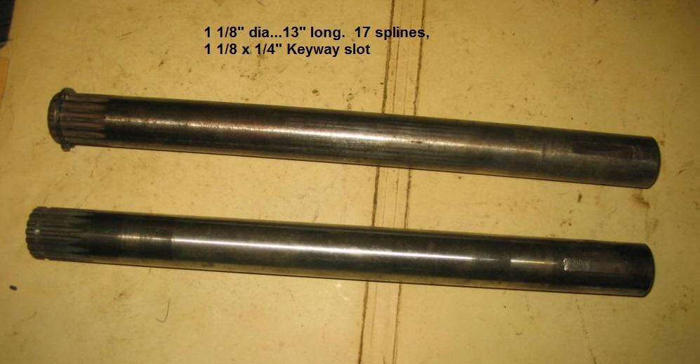

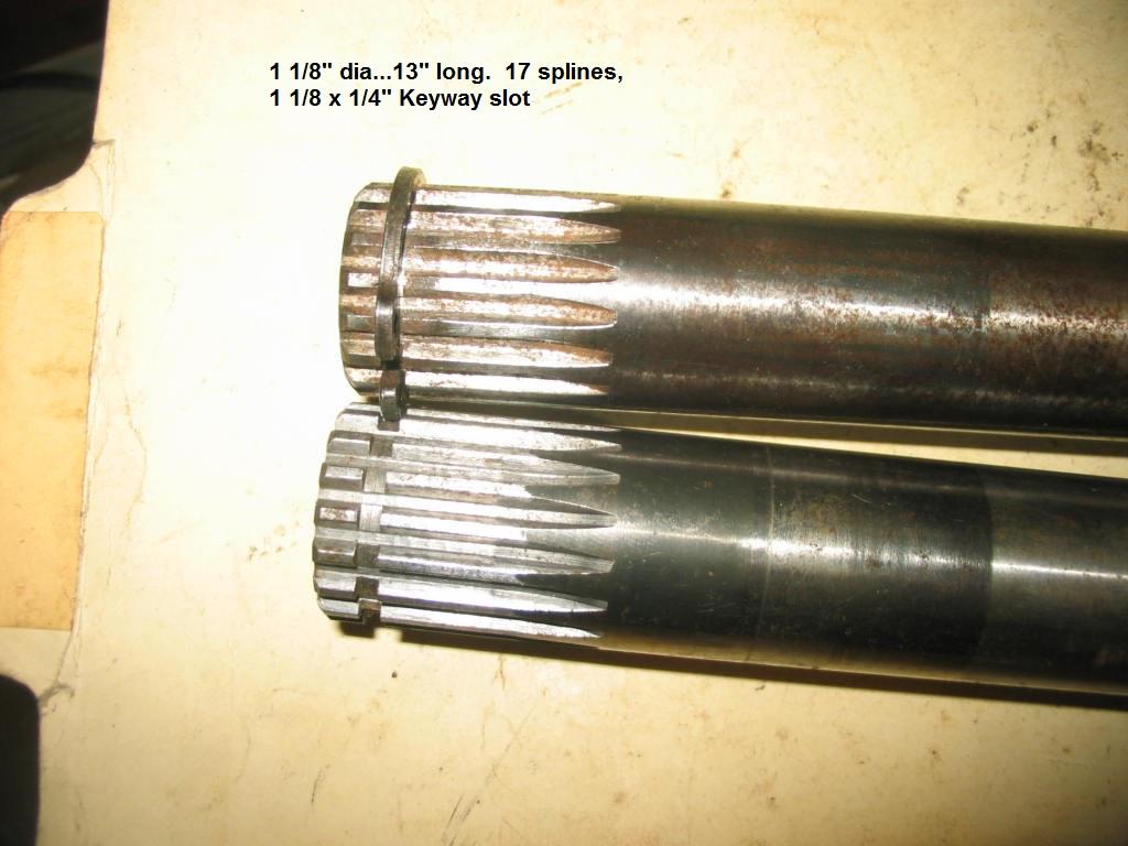

daveoman1966 3,882 #11 Posted May 25, 2018 (edited) Your Charger axles are 1 1/8" dia...right? If so, what is their length and how many splines are on the Gear end of them. I have a matched pair of axles that MAY match...not sure. With the long keyway slots, me thinks these are from C-120 C-160 etc. The older tractors like Chargers have a shorter keyway slot...same width though. Edited May 25, 2018 by daveoman1966 Share this post Link to post Share on other sites
mikeeyre74 290 #12 Posted May 25, 2018 I took a few pictures while I was disassembling it, and mine have 17 splines on the gear end of the axle… I don’t know how long they are, because they are at the machine shop right now where they have been for the best part of a month… Share this post Link to post Share on other sites
pfrederi 19,941 #13 Posted May 25, 2018 (edited) The splines are all the same. Differences I have seen are some have the snap ring some drilled for a roll pin. Either works. Differing length key-ways not an issue, width that would be an issue but again most all I have ever seen same width. lengths change but if you can live with the hub out a bit from the case or as in one of mine the axle recessed about 3/8" from the hub face. I put a 10 pinion into a modern 8 speed no problems. Edited May 25, 2018 by pfrederi Share this post Link to post Share on other sites
