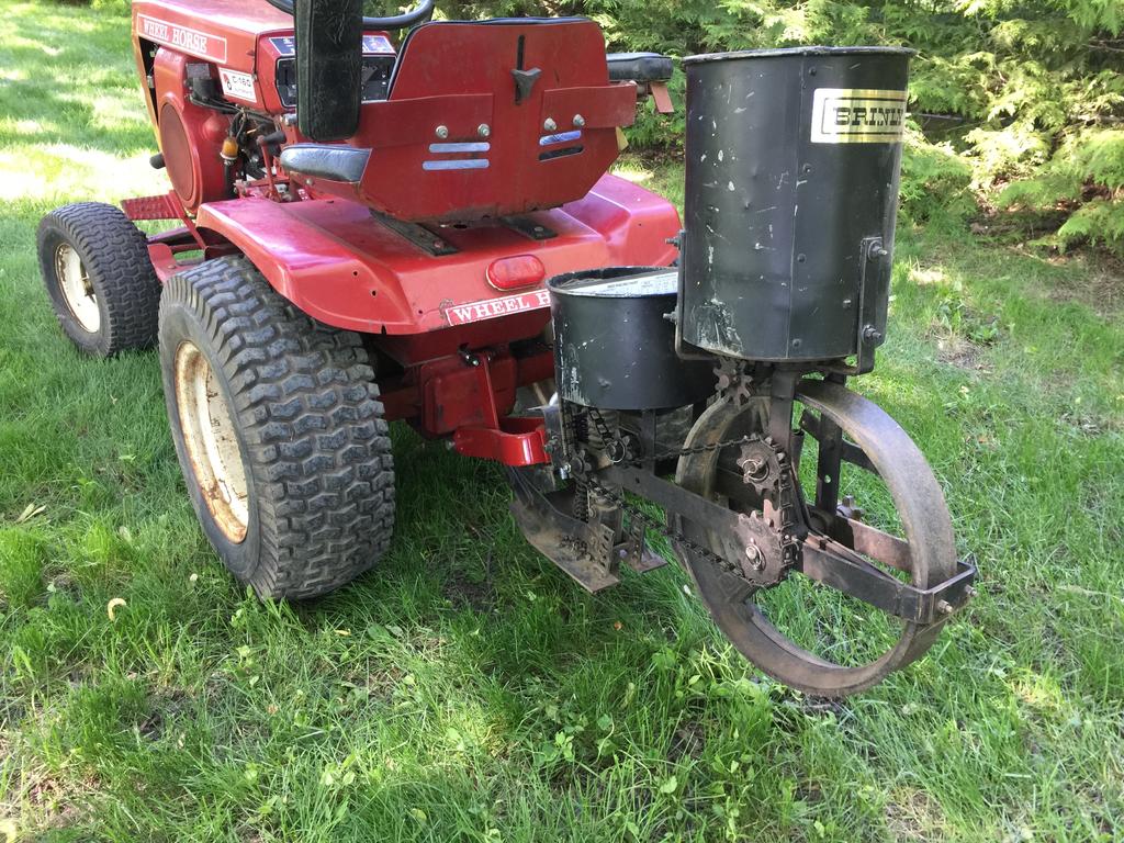

wheelhorseman 3,244 #11 Posted May 24, 2018 (edited) 17 hours ago, wallfish said: Thanks for sharing! Curious why they didn't put shallow paddles on the wheel. Or would that just dig the seeds back up? I know what you mean (like ground driven sickle mowers and such) maybe some old planters had them but I also have a Brinly planter and it also has a smooth wheel that drives the planter and it works good so I personally think the slipping problem is the hitch - if it was ridged (like the Brinly) the front would not dive because of the hinge design and it should work fine Edited May 24, 2018 by wheelhorseman Share this post Link to post Share on other sites
