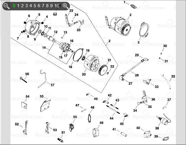

a.dumont 10 #2 Posted May 22, 2018 (edited) I've tried Google and YouTube, but no videos. Did find this on http://www.partstree.com/parts/kohler-engines/engines-horizontal/k482-9042a/governor-021700914/. I'm looking to replace item #7. Edited May 22, 2018 by a.dumont Share this post Link to post Share on other sites

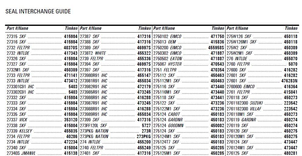

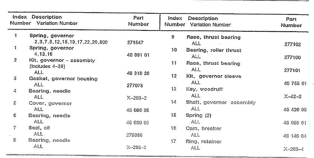

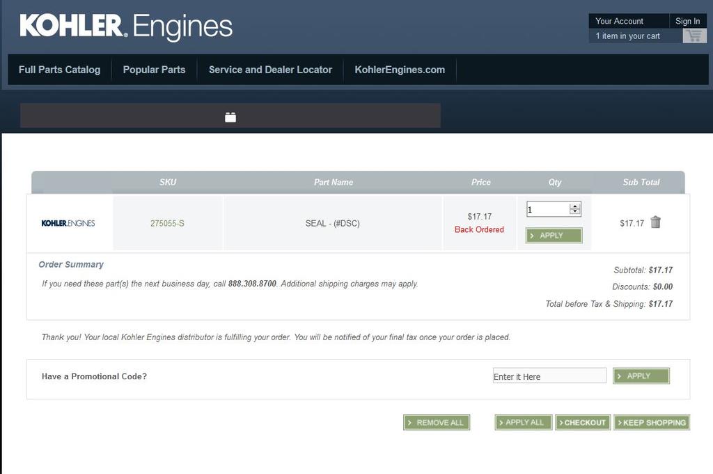

pfrederi 19,784 #3 Posted May 22, 2018 (edited) 275055S is the aprt number. My SKF interchange doesn't find it and NLA from Kohler Edit Technically "Backordered" Edited May 22, 2018 by pfrederi 1 Share this post Link to post Share on other sites
pfrederi 19,784 #4 Posted May 22, 2018 Also stuck out at Federal Mogul (National) and Timken Share this post Link to post Share on other sites
