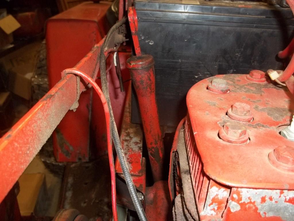

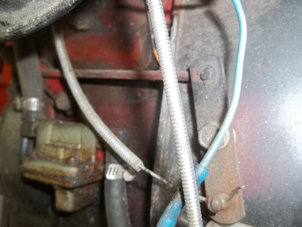

p38js 441 #1 Posted May 21, 2018 Looking for a picture of the routing and hardware for the throttle cable Share this post Link to post Share on other sites
953 nut 63,634 #2 Posted May 22, 2018 On 5/21/2018 at 4:09 PM, p38js said: Looking for a picture of the routing and hardware for the throttle cable The routing and hookup is about the same as any other late 60s early 70s . The cable leaves the dash and travels along the right side of the engine and ducks down below the exhaust crossing in front of the engine. From there it heads toward the other side of the engine and attaches to the lower end of a pivot arm that goes to the governor. A rod at the top of this arm attaches to the governor. Then the governor attaches to the throttle on the carburetor. Pictures aren't the best because of tight quarters in the engine bay of the GT-14. Share this post Link to post Share on other sites
p38js 441 #3 Posted May 22, 2018 Cool thank you this helps out a lot 1 Share this post Link to post Share on other sites
