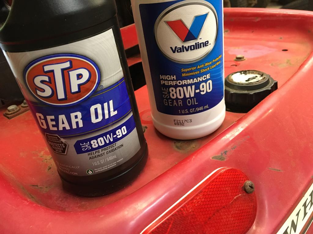

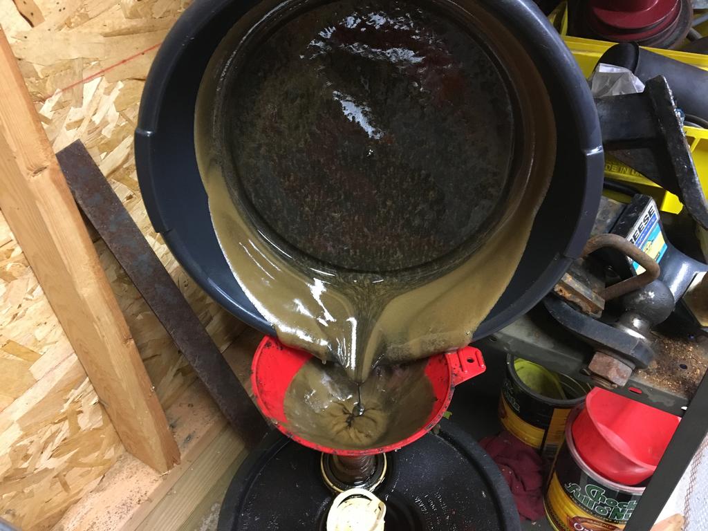

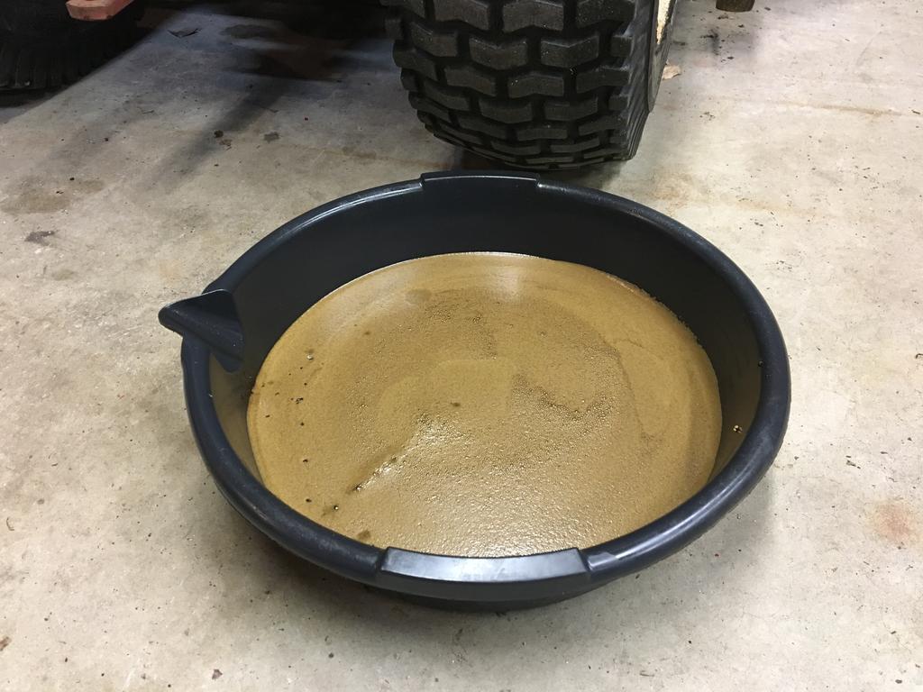

Sparky-(Admin) 24,044 #1 Posted May 18, 2018 The fluid in my C-105’s 8 speed is draining as I type this. Any reason I couldn’t mix gear oil brands? They both have a GL-5 rating. Share this post Link to post Share on other sites
953 nut 63,170 #2 Posted May 18, 2018 Oil is Oil! 8 Share this post Link to post Share on other sites
pfrederi 19,298 #3 Posted May 18, 2018 Dead Dinosaurs are dead dinosaurs... 4 Share this post Link to post Share on other sites
squonk 44,923 #4 Posted May 18, 2018 Sorta related: My Power King transmission takes a 1/2 pint. It has a mix of 90 Wt., STP and Lucas oil stabilizer. Been in there for 5 yrs. 2 Share this post Link to post Share on other sites
Sparky-(Admin) 24,044 #5 Posted May 18, 2018 You guys made me laugh!! Mixed it is! Has to be better that what came out . 2 Share this post Link to post Share on other sites
peter lena 9,576 #6 Posted May 19, 2018 best thing you did was drain out that slurry, don't forget to check out and probably ,replace the shift boot, cause of moisture entry. with the slow speeds that you are moving oil will not wear out, it will contaminate, and hold moisture,. that's your issue. I change mine on a regular basis, keep it clean and fresh and prevent bearing failure. mixing oils at the same spec and weight is not a problem, trashing your gear box with watered down oil is , you saved it. that gear oil had also flashed/ sheared by the double color look , you are lucky pete 2 Share this post Link to post Share on other sites
Racinbob 12,434 #7 Posted May 19, 2018 Love the answers and so true. I'd flush that tranny and add fresh of whatever brand(s), run it for a few mowings and change it again and then as long at it's stored inside you'll be good for years. 3 Share this post Link to post Share on other sites
wallfish 18,792 #8 Posted May 19, 2018 Mixing Oil Brands, You're real rebel Sparky! 1 5 Share this post Link to post Share on other sites
rmaynard 16,701 #9 Posted May 19, 2018 Go for it. Mix away. It won't do any harm. 2 Share this post Link to post Share on other sites
stevasaurus 23,521 #10 Posted May 19, 2018 I never met a smorgasbord I did not like. Your transmission will never know. Dead Dinosaurs are dead dinosaurs... see you at the show Paul. 4 Share this post Link to post Share on other sites
