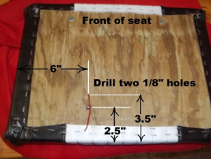

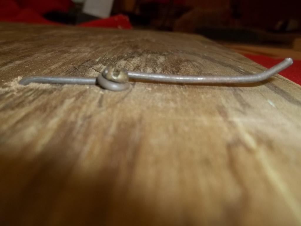

953 nut 64,146 #3 Posted May 18, 2018 Your seat back takes a pair of 1 3/4" 1/4-20 round head machine screws that will go into a pair of "T Nuts" in the seat back. I made up a devise that attaches to the plywood of seat cushion which does a good job of holding it down. you can make one up using any heavy wire and attach it to the seat bottom where it will go into the gas fill opening of the seat base. Mine is made of 1/8" spring wire and the screw eye bent in it is one inch from a 90* bend that positions it. There is one thing we request of all new members, 2 Share this post Link to post Share on other sites
