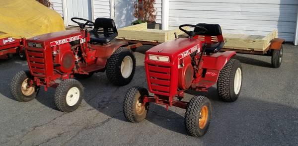

Oldcpecdr 255 #1 Posted May 18, 2018 (edited) Finally going to use one of the Horses this weekend !!!! Neighbors are looking askance at the motley lawn. A friend has offered me a free snowthrower attachment.... will a 10 HP C100 or B100 have enough power to make it useful ? Or do I have to find a third Horse Mike B Edited May 18, 2018 by Oldcpecdr add pic 1 Share this post Link to post Share on other sites
