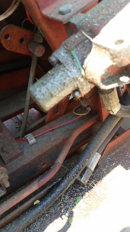

chip61 666 #1 Posted May 14, 2018 Control valve for my hydraulic lift has sprung a leak!! Are o-rings and gaskets available for this?? I thought the line was leaking at first, but I saw fluid dripping from the valve Friday night. Share this post Link to post Share on other sites

pfrederi 18,894 #4 Posted May 14, 2018 I think the first link above is only for the cylinder it self not the control valve. What model tractor do we have here...Charger/Electro??? Is the valve itself leaking or is it one of the hose ends either the fiting itself or where it enters the valve. The hose ends are SAE #5 ORB are hard to find. Lowell has replacement hoses. It may just be the O ring on the end of the hose fitting they are available. they are Dash #905 The victor rebuild kit is NLA from Toro I 2 Share this post Link to post Share on other sites
ACman 7,673 #5 Posted May 14, 2018 (edited) Sorry about that here’s the correct one for charger/electro https://www.wheelhorsepartsandmore.com/hydraulics.html#!/Control-valve-seals-7788-for-HY-6/p/84960117/category=23548048 . Give Lowell a call. Any good farm/ag dealership that’s worth a darn (good luck nowadays) should be able to fix yup . My family’s dealership carries a full line of o-rings , packings , hydraulic hoses and fittings. It’s just finding that person that’s willing to help . Edited May 14, 2018 by ACman 3 Share this post Link to post Share on other sites

stevasaurus 23,446 #7 Posted May 15, 2018 It sure is helpful when a picture is accompanied with a request for help. Thank you Chip61. Share this post Link to post Share on other sites
