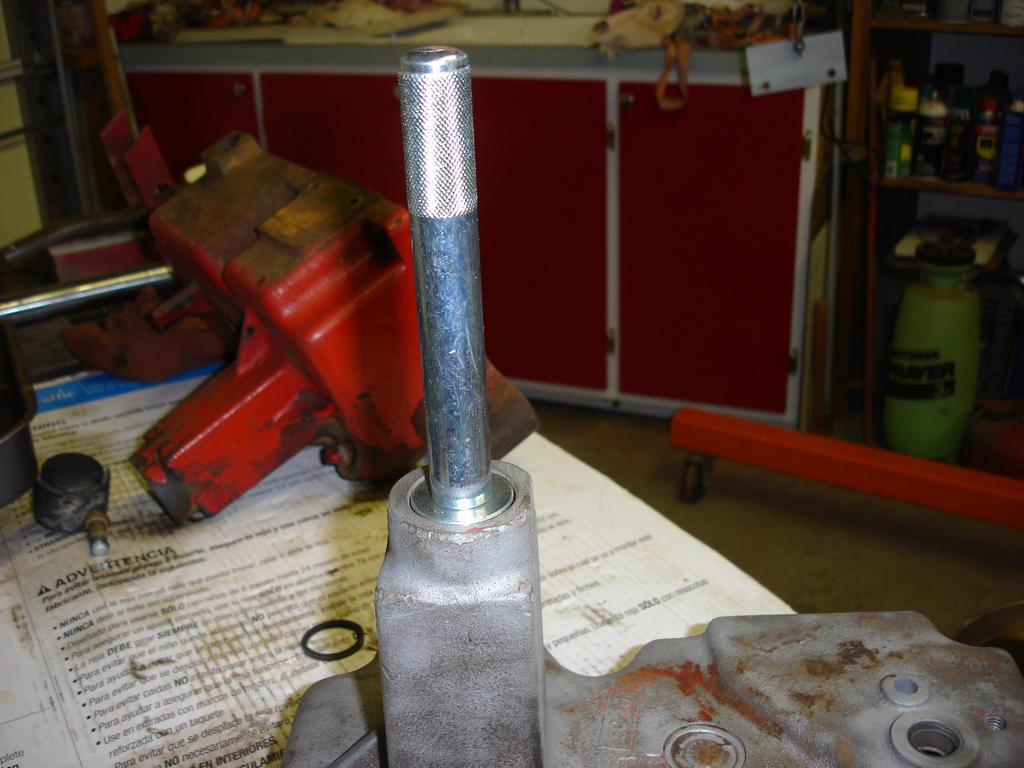

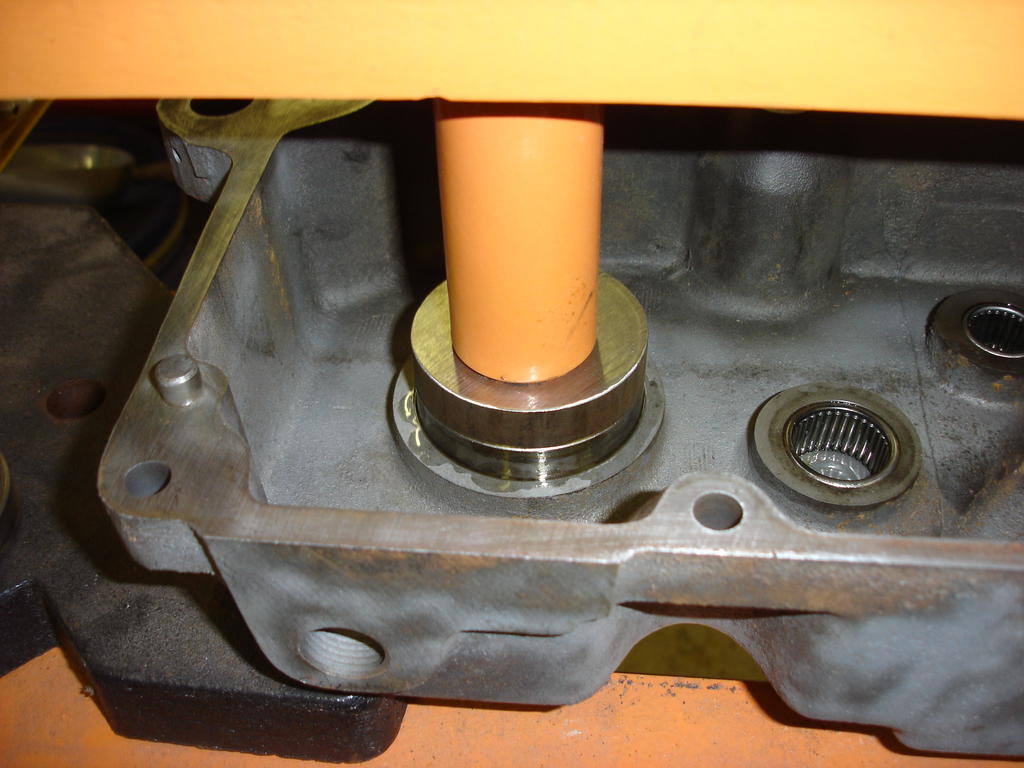

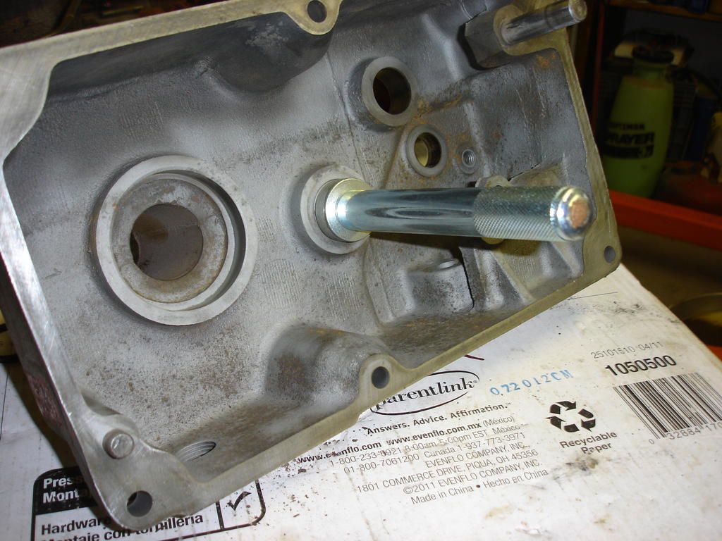

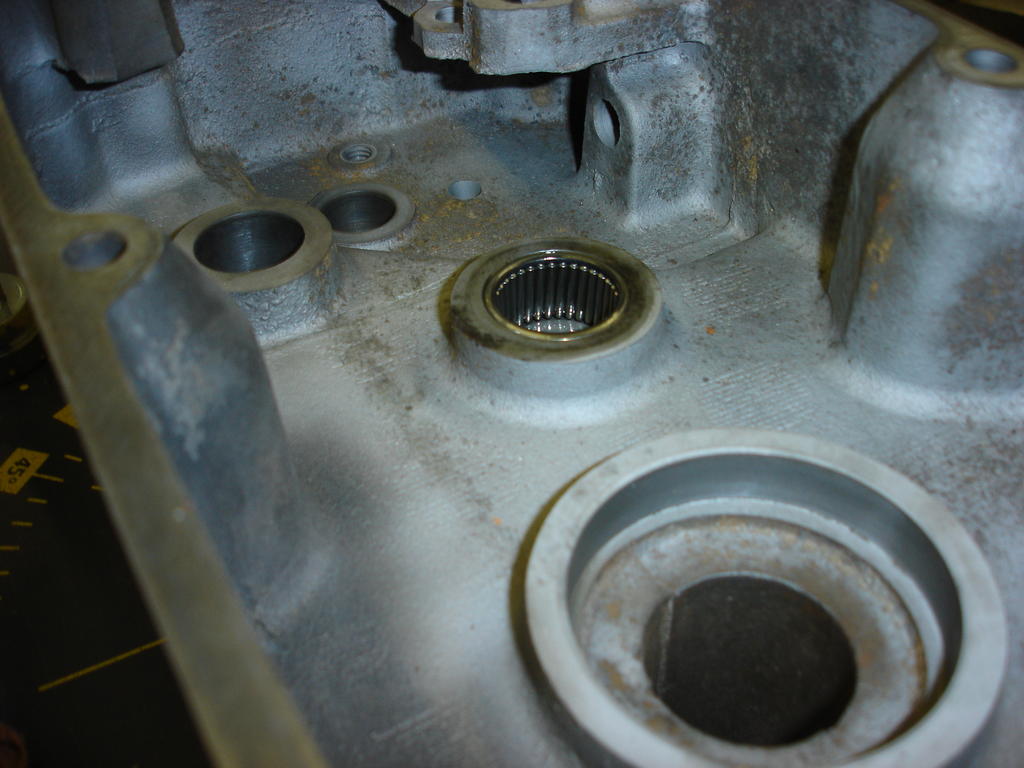

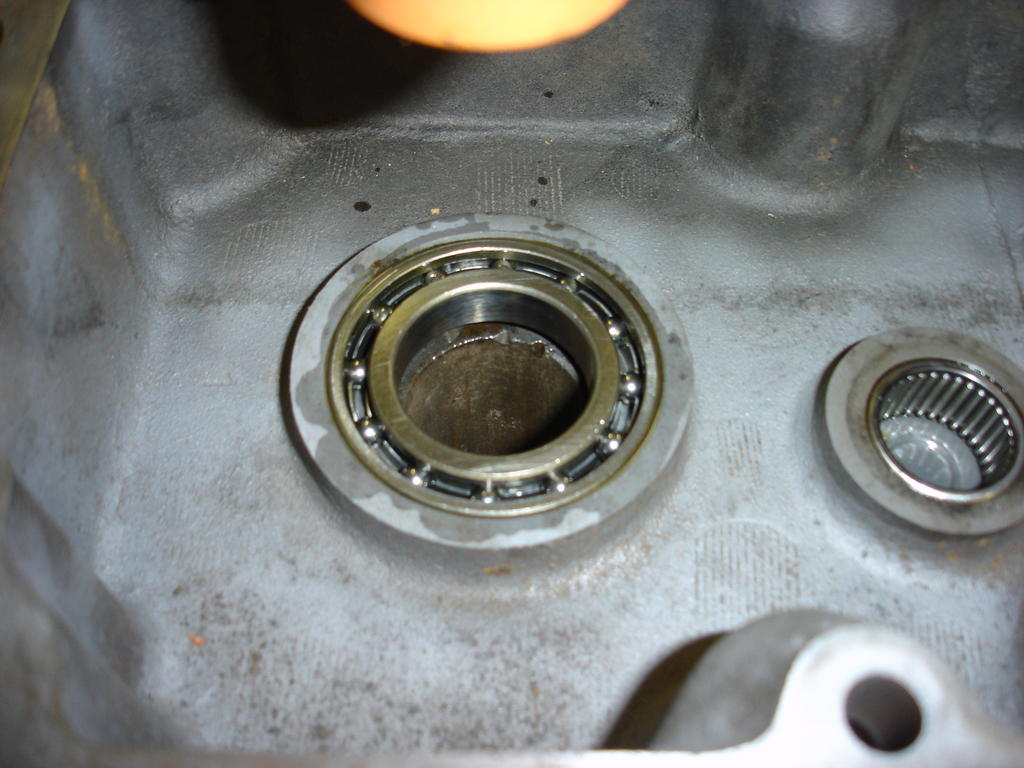

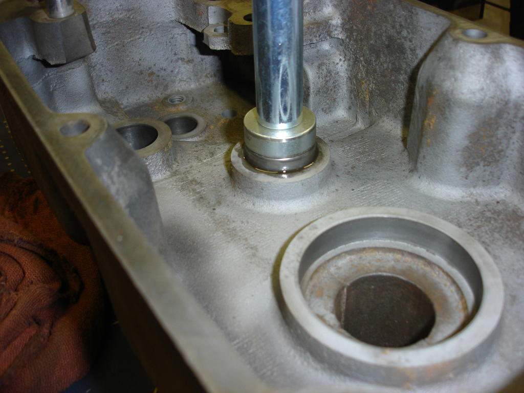

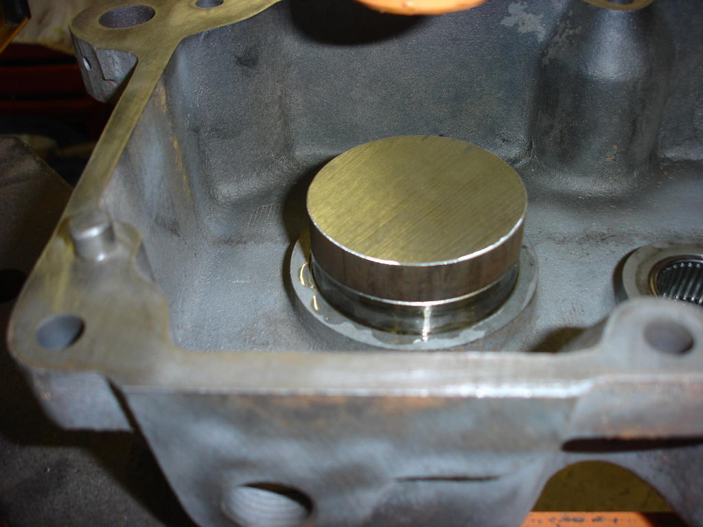

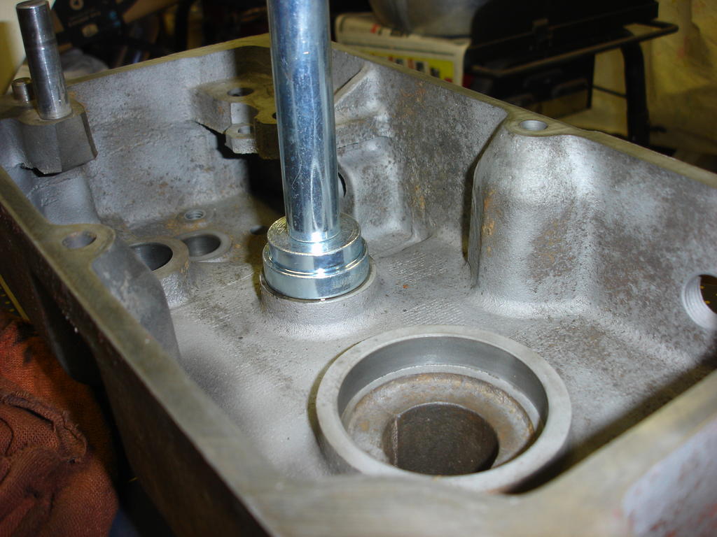

Marv 994 #1 Posted May 13, 2018 Thought I would post some pictures showing bearing installation in trans case. 6 1 Share this post Link to post Share on other sites
