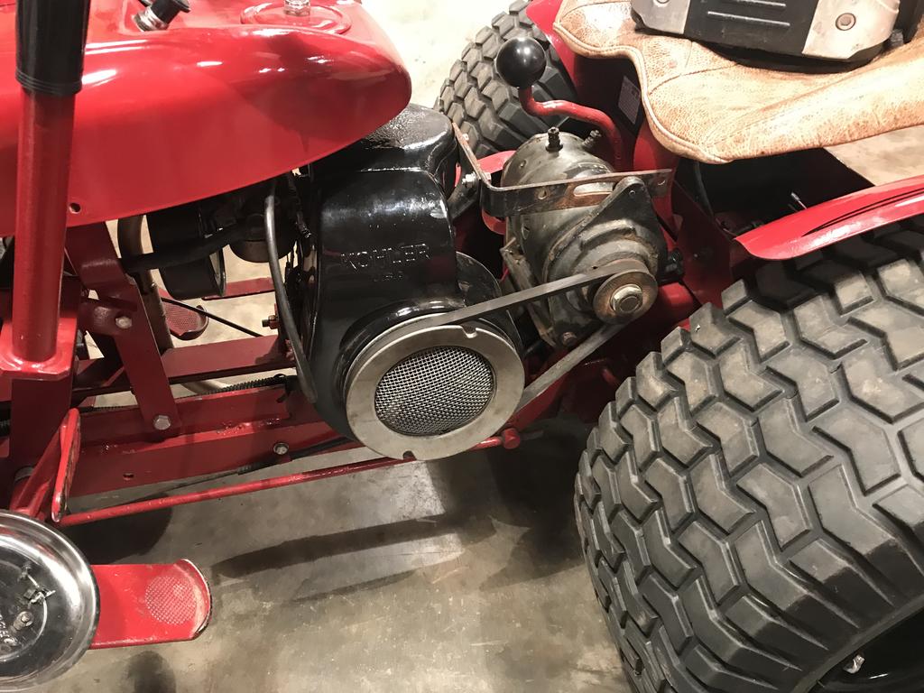

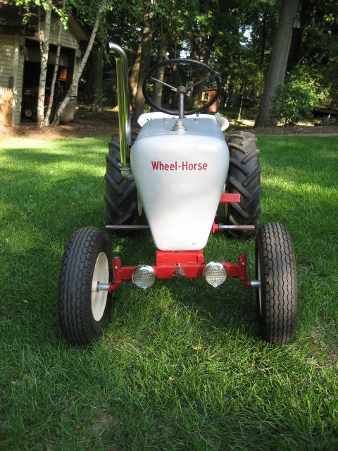

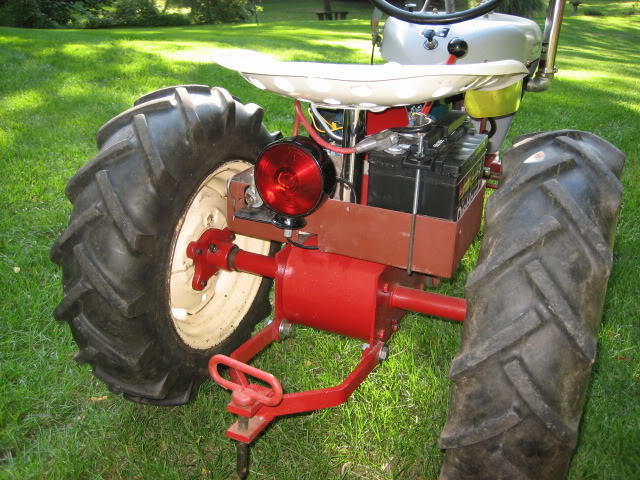

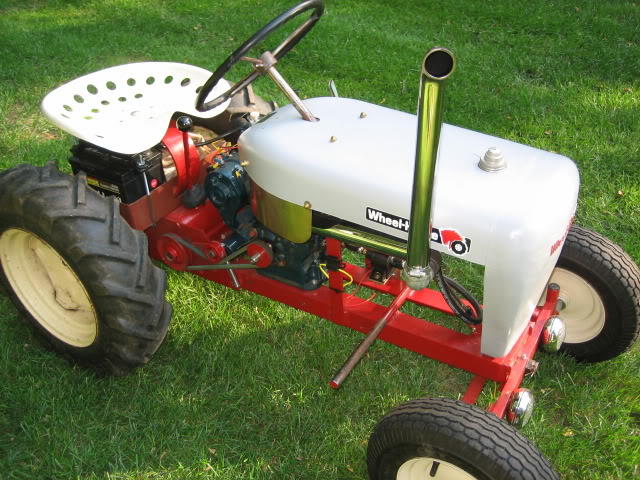

stevebo-(Moderator) 8,606 #2 Posted May 10, 2018 Just installed this on my boys suburban 1 Share this post Link to post Share on other sites

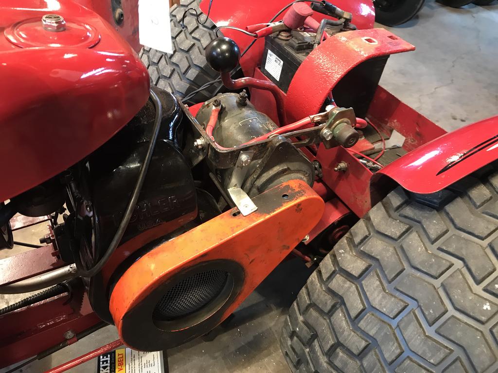

stevebo-(Moderator) 8,606 #3 Posted May 10, 2018 2 2 Share this post Link to post Share on other sites
formariz 12,358 #4 Posted May 10, 2018 (edited) Not sure if you can see photos from post due to photo bucket block so here they are. Edited May 10, 2018 by formariz 6 Share this post Link to post Share on other sites
C&W 77 #5 Posted May 10, 2018 Nice I bet he is going to like it ,was the bending of the shift lever a have to ,or did you do it to use the same engine bolt holes Share this post Link to post Share on other sites

formariz 12,358 #7 Posted May 10, 2018 Just now, C&W said: Caint get no pics fromariz I might need to upgrade something but from what I read sounds nice You should see photos now 1 Share this post Link to post Share on other sites

stevebo-(Moderator) 8,606 #10 Posted May 10, 2018 6 hours ago, C&W said: Nice I bet he is going to like it ,was the bending of the shift lever a have to ,or did you do it to use the same engine bolt holes Need to heat and bend shifter for sure. If you start using other holes then you have to cut hood which is never a good thing.... 1 Share this post Link to post Share on other sites
formariz 12,358 #11 Posted May 10, 2018 3 hours ago, stevebo said: Need to heat and bend shifter for sure. If you start using other holes then you have to cut hood which is never a good thing.... The K91 will fit under hood without cutting it. I moved mine forward enough to not to have to bend shifter and to keep all engine components on engine. Did have to drill new holes in the frame.In addition to eliminate the air cleaner hitting frame I went with a filter from Lauson or a Clinton mounted on an elbow from an updraft oil bath.It is also easier to service filter this way rather than the stock Kohler filter in the normal position. Probably the hardest thing to do was to find the right length belt. Not done yet but there is also a belt cover in the works. Share this post Link to post Share on other sites
