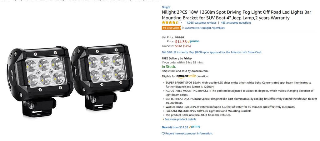

Tractor boy 239 #7 Posted May 10, 2018 Okay. This is what I’m thinking running a separate circuit for the auxiliary lights and only connecting to the tractors battery. Would a higher voltage battery effectively “ramp up” the voltage so I can run this or is that just wrong? Share this post Link to post Share on other sites
gwest_ca-(File Mod) 11,787 #8 Posted May 10, 2018 You can not go to a higher voltage battery because the rest of the tractor uses a 12 volt system. You could go to a higher capacity battery which just means it will hold a charge longer and take longer to go dead. You still just have 3 amps charging it so it would likely never return to it's higher capacity. A battery is designed to start the engine and that's it. The charging system is designed to replace the engery used in starting the engine and maintain the charge so it can start again next time. With this model that is it. The lighting circuit has it's own stator which covers the only other electrical load on the tractor. Garry Share this post Link to post Share on other sites
pfrederi 19,089 #9 Posted May 10, 2018 (edited) Depends on how long you want to run the lights and how much they draw. You seem to have a battery coil ignition which is drawing current all the time 1-2 amps. that only leaves an amp or so to recharge your battery after cranking. If you have a healthy battery you could run some lights I have a set of LEDS that draw 18 watts. That would draw about 1.5 amps. Over several hours you would probably drain the battery. Bottom line 12 watts equals 1 amp and that is about all you have to play with. But with a good battery and you would be willing to put it on a charger periodically you could have some lights. Edited May 10, 2018 by pfrederi Share this post Link to post Share on other sites

Tractor boy 239 #11 Posted May 10, 2018 So I thought about this some more today. Garry pointed out that the battery would die if the lights were used for a hour or so. What if I only used the lights for about half a hour or so the couple times a winter I plow my driveway? Share this post Link to post Share on other sites
squonk 44,775 #12 Posted May 10, 2018 Build a tray mounted on the rear. Get yourself a deep cycle 12 v battery and put it in the tray.Hook only your auxiliary lights to it. Now you will have added weight for plowing, power for your lights and your regular battery will charge and restart the the engine. When your done plowing, hook up a trickle charger to the aux. battery. Share this post Link to post Share on other sites
