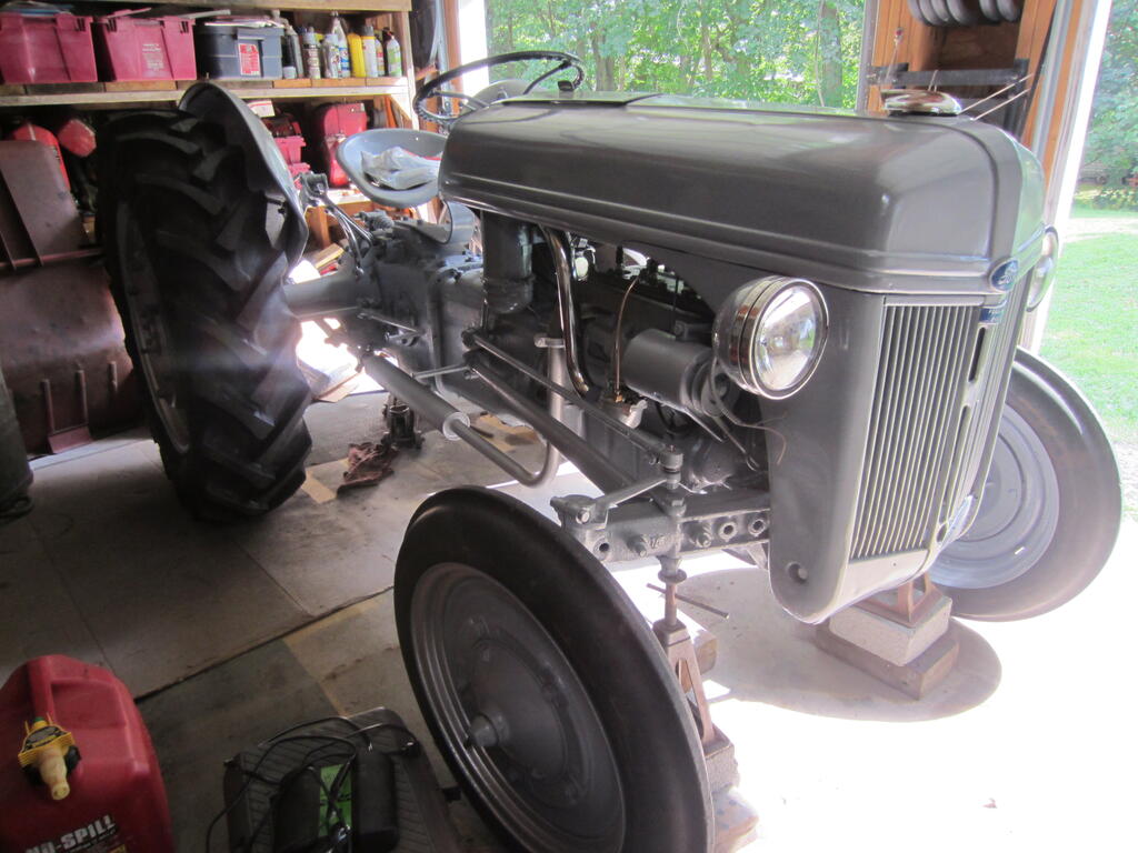

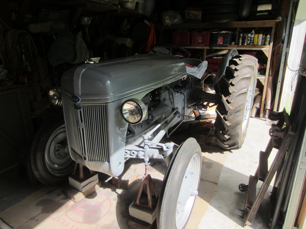

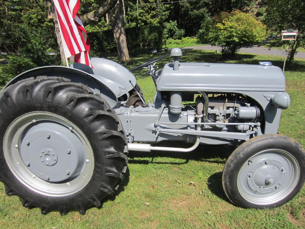

Herder 2,355 #26 Posted August 14, 2021 Got the fuel tank installed, the hood set and ran the fuel line this past Thursday. I am not a big fan of the makeshift headlights, I guess they will work for now. 2 Share this post Link to post Share on other sites

Herder 2,355 #28 Posted August 15, 2021 Finally!!!!! 3 3 Share this post Link to post Share on other sites

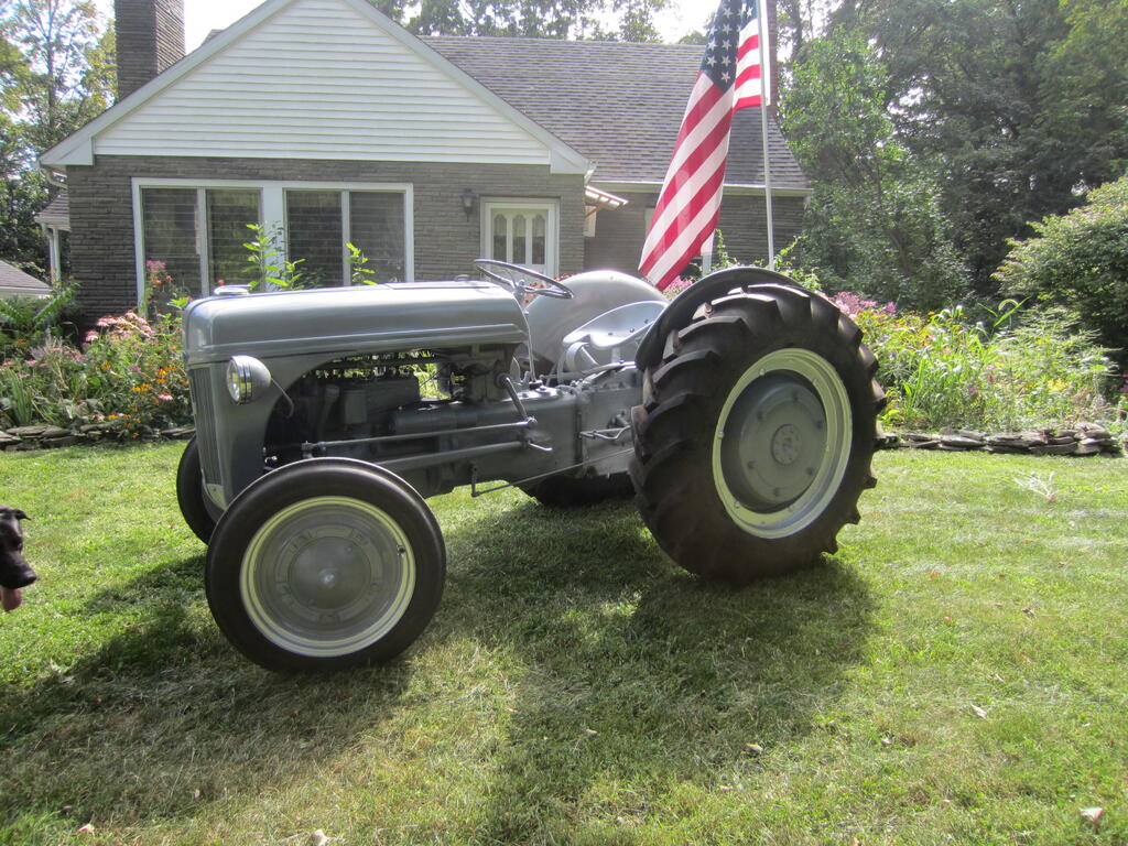

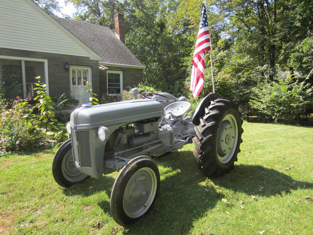

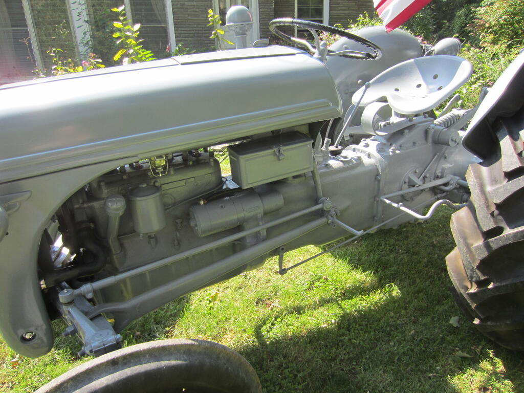

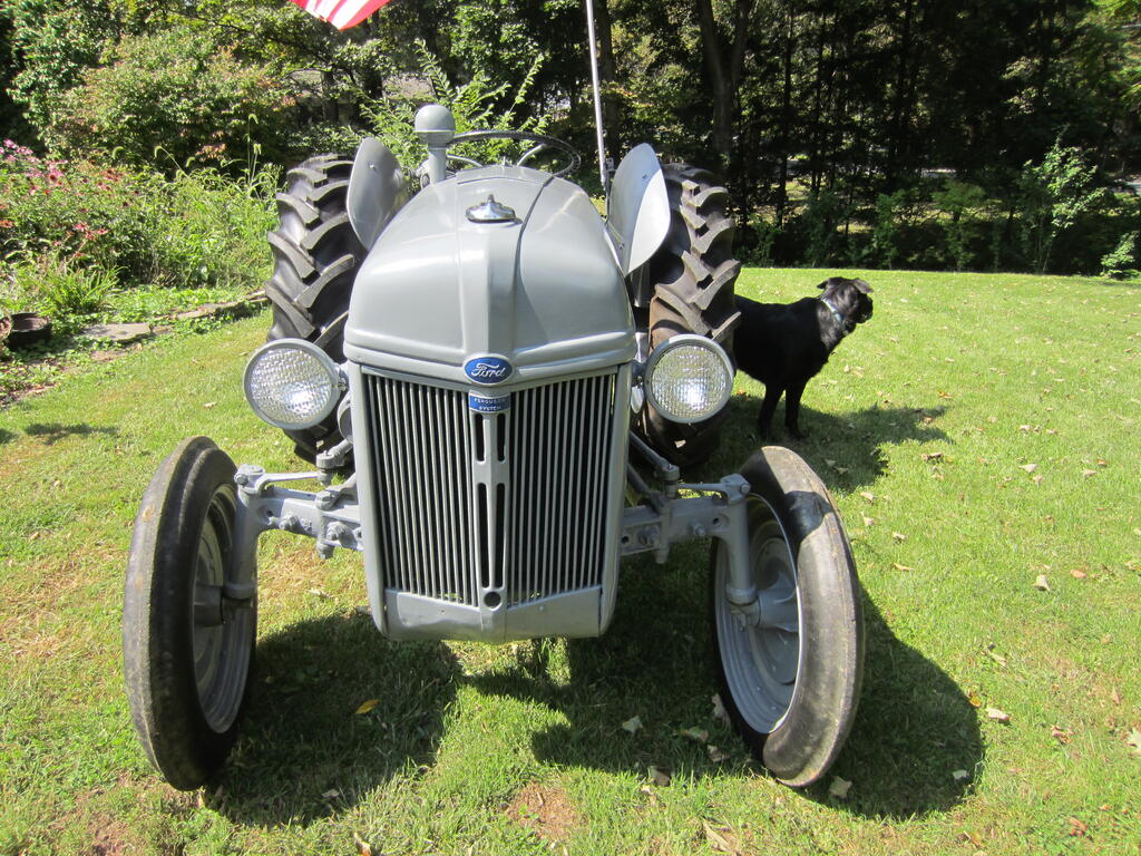

Herder 2,355 #32 Posted September 11, 2021 (edited) Update: The generator came back from rebuilding and is charging. Finished up the toolbox. Installed the air cleaner stack. Headlights took nearly three weeks to get, painted up, installed and wired. Awesome! Love the way they look. Then the fun started, she ran great under load for about 20 minuets and then would go down hill and stall, then needed a cooldown period before she would restart. I checked and replaced all the usual suspects, condenser & coil. What a difference. I also found the ignition switch must have been on it's way out, changed that and the charging improved and she running like a top. And she's outside enjoying the beautiful weather. Have a great day everyone!!!!!!!!!!!!! Edited September 12, 2021 by Herder 2 Share this post Link to post Share on other sites
