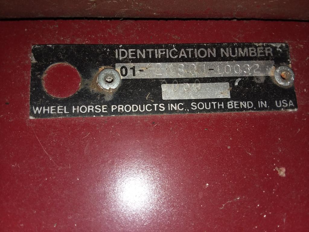

Ed Kennell 43,025 #5 Posted May 8, 2018 Sounds like you have a 1980 C-125 with the Sundstrand 90-1175 transmission. to the Always room for another PeeAaaer. Where is Unityville? 1 Share this post Link to post Share on other sites

Jpud1 5 #7 Posted May 9, 2018 This is the tag on the c125 Share this post Link to post Share on other sites

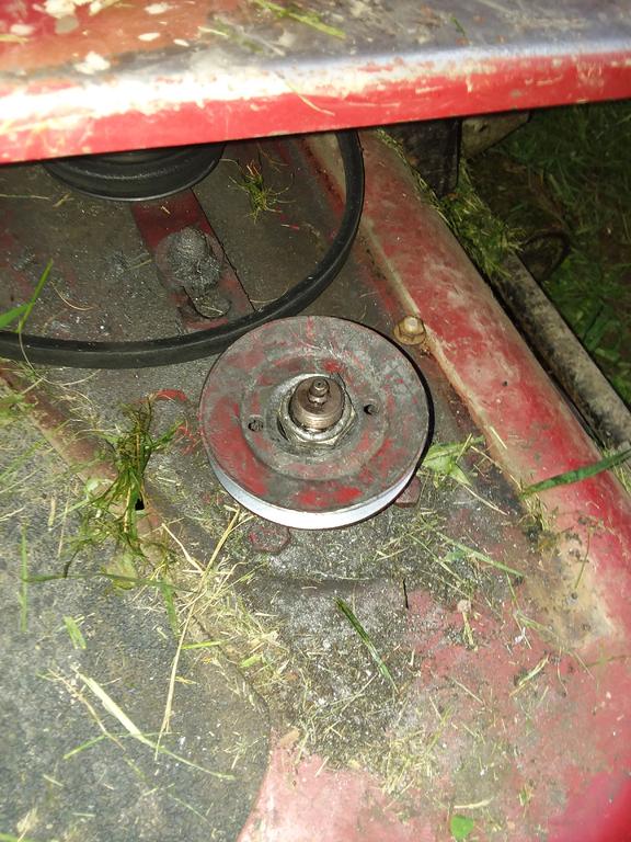

Jpud 1 #10 Posted May 14, 2018 My boy was just mowing with our c125 and the deck spindle went anyone know what the number is on it or where I can find a new one thanks Share this post Link to post Share on other sites
953 nut 62,064 #11 Posted May 14, 2018 7 minutes ago, Jpud said: deck spindle went anyone know what the number is on it or where I can find a new This manual should get you headed in the right direction. Could start by posting a wanted ad in the classifieds here. Share this post Link to post Share on other sites
Jpud 1 #13 Posted May 15, 2018 Thanks so much that's more info than I new or would be able to find myself thanks. Awesome 1 Share this post Link to post Share on other sites
