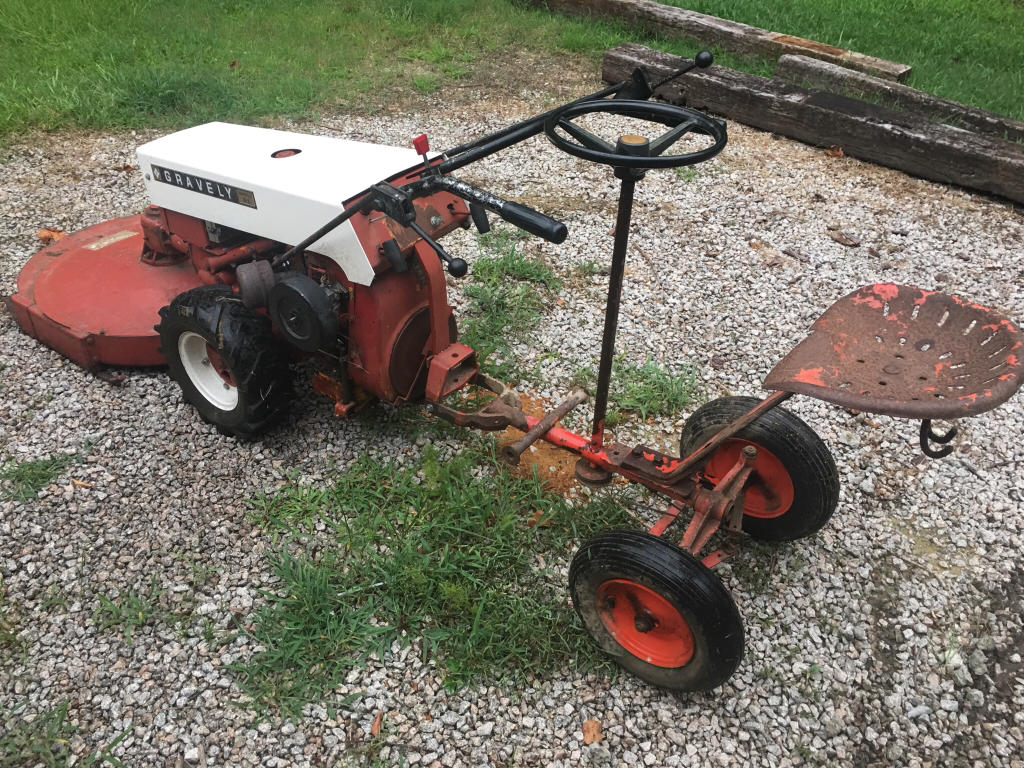

Single flat spring about 3" wide?
The old walking Gravely sulkies used about 1-1/2 springs doubled up. The 2nd spring goes about 1/2 way up to the seat.
Garry
This one is shorter than mine but you get the idea.
  • Like 1
Achto
Maybe stuff a coil spring inside of the original spring.
wallfish
Adding more tension will probably make a more rougher ride.
How about using spacers under the spring at the trans to raise it up? Low tire pressure will absorb some of shock too. And a seat cushion.
