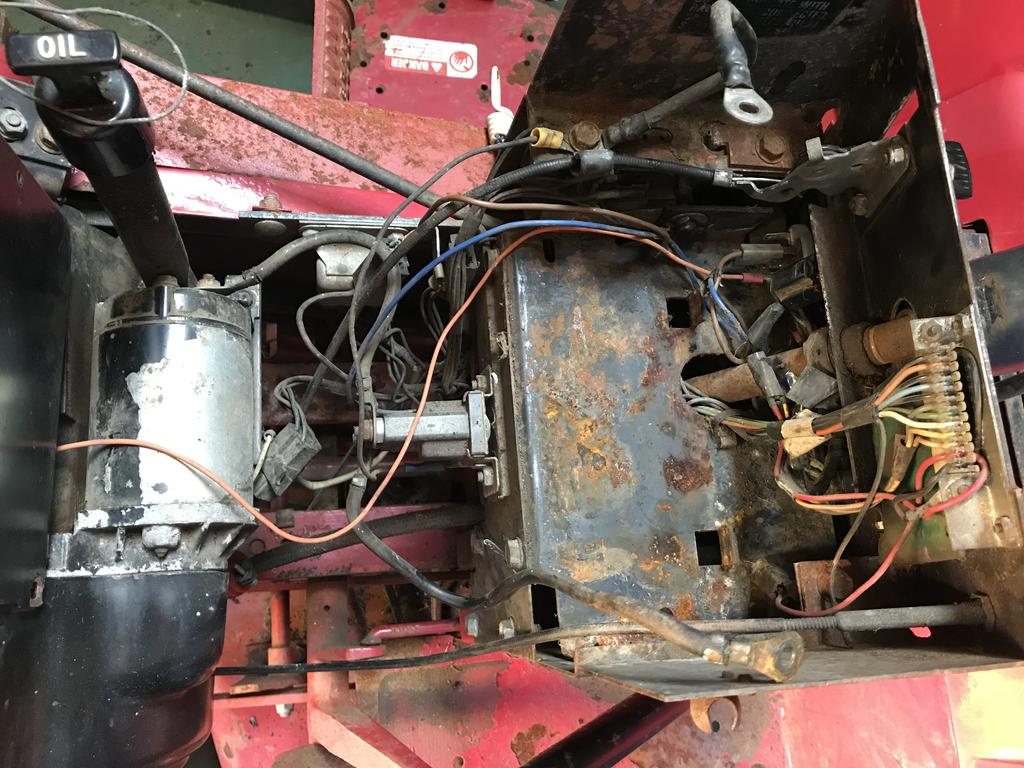

Kasweld 7 #1 Posted May 6, 2018 Hi all, new to the site and hope you can assist me, I’ve purchased a 312-8 today to do up, only thing is the wiring is worse than a crows nest! I’ve put a charged battery on and nothing, no lights noises or anything, the ignition switch has been re-wired and there is non connected wires all over the place, Im just wondering if there is a good diagram to follow as I plan to re-wire it, I shall get all the relevant numbers tomorrow to correctly identify it yours hopefully, kasweld 1 Share this post Link to post Share on other sites
gwest_ca-(File Mod) 11,393 #2 Posted May 6, 2018 Welcome to the forum. Numbers off the tractor ID decal possibly under the left side of the seat and/or All the numbers off the engine data decal including the serial number With those we should be able to identify the correct wiring diagram. There are a few. Garry Share this post Link to post Share on other sites

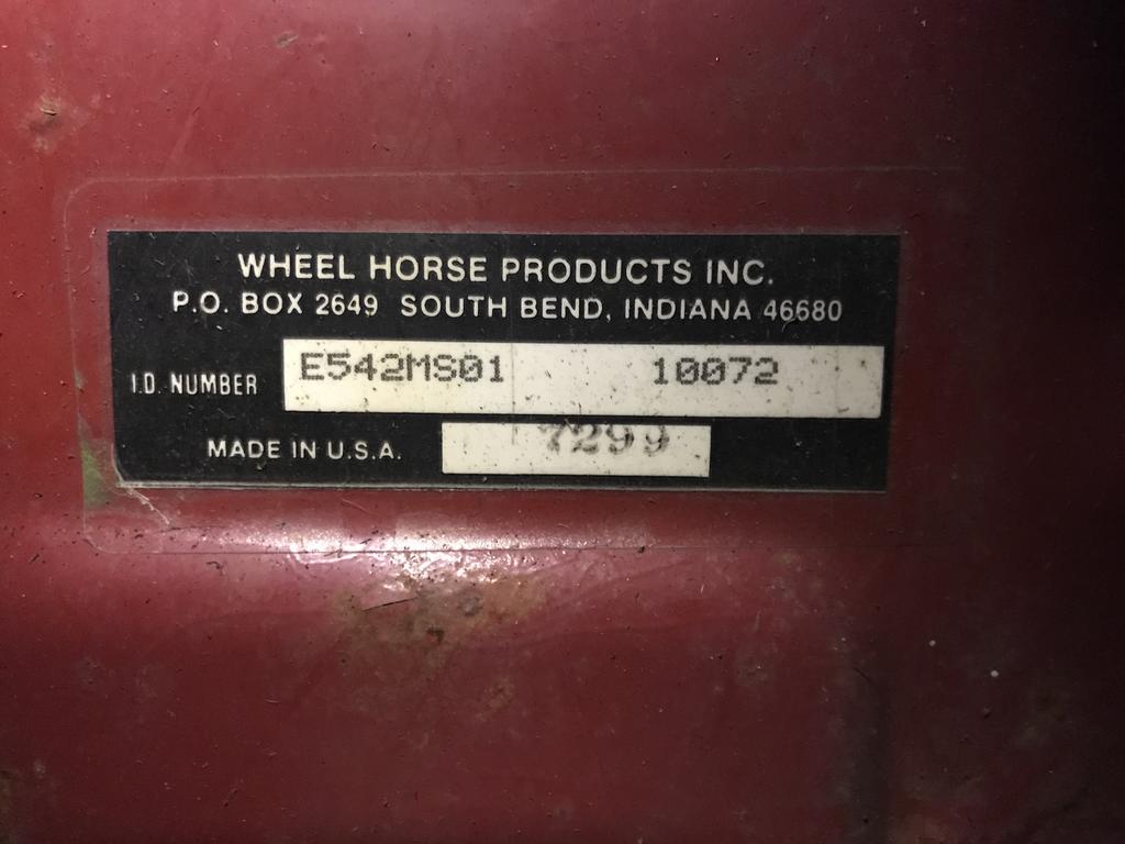

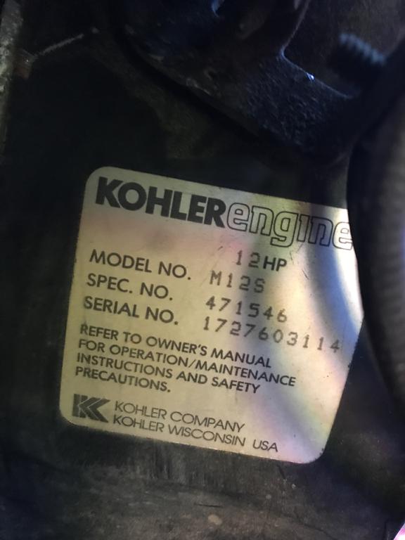

Kasweld 7 #5 Posted May 7, 2018 Ok, have some numbers, couldn’t find one near seat so have took a picture hoping this will help to identify it Share this post Link to post Share on other sites
953 nut 59,343 #6 Posted May 7, 2018 You have a 1989 312-8 according to the engine spec #. this manual has wiring diagrams to help get you started. as questions arise please start a post on that specific question so you will get lots of input from members here. 1 Share this post Link to post Share on other sites
Kasweld 7 #7 Posted May 7, 2018 Thanks 953 nut, I will take a look over them and get started, many thanks for your assistance 1 Share this post Link to post Share on other sites
gwest_ca-(File Mod) 11,393 #8 Posted May 7, 2018 The Kohler serial number indicates the engine was made in 1987 so there is a chance the tractor is a 1988 model E1-12K801. Click on the pictures Garry 1 1 Share this post Link to post Share on other sites

Kasweld 7 #14 Posted May 9, 2018 Have just located the I.d number it was on the deck, so I’m hoping it’s the original one any better clues on date?? Share this post Link to post Share on other sites

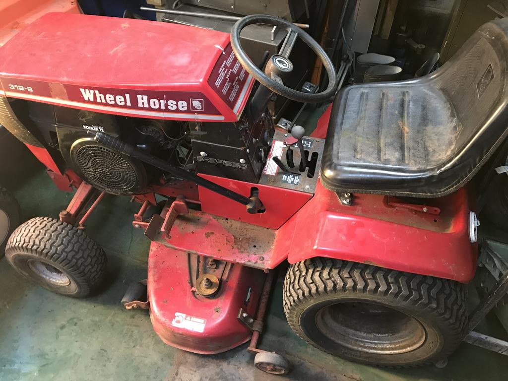

Kasweld 7 #15 Posted May 13, 2018 Had the mower out today and cut grass, goes really well, runs a treat and made light work of the grass few little niggle bits to sort, eg fabricate some belt guards for deck and front puley, and fabricate a new exhaust as one that’s on is wrong thanks for everyone’s help 👍👍 Share this post Link to post Share on other sites
