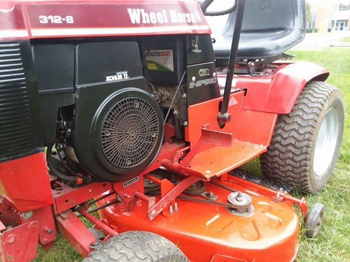

TimH 105 #1 Posted May 5, 2018 Just tried to mow the second time this season. Unit stopped running mid way through . Runs only now on full choke. Tank full of gas. Before I tear into it. Anything I should look at first. Has a Kol 12 hp on it. Plowed snow all winter just fine LOL Share this post Link to post Share on other sites
