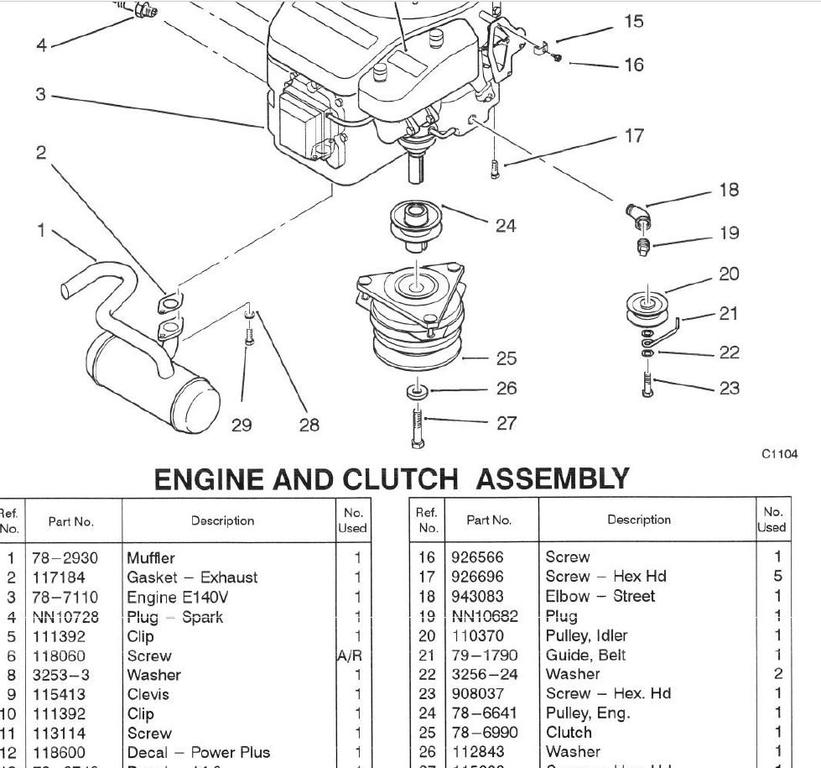

Dan693 510 #1 Posted May 4, 2018 (edited) Hey All.....my early 90's Toro/WH 244H developed an oil leak somewhere around the bottom of the engine so I'm removing the engine to see whats up. Its a Onan 14 HP. I was able to remove the electric clutch but now I'm onto the engine drive pulley. Does anyone know how that pulley can be removed? Its seems to be tight on the shaft so maybe a puller? I dont see any set screws or other ways its attached. I guess its pressed on. I thought i would ask before rolling around on the floor for 2 hours not knowing what Im doing. Thanks! UPDATE.......It looks like I can remove the engine and the engine mounting plate all at once......then flip it over on the bench to repair. Whew!!!! Edited May 4, 2018 by Dan693 add text 1 Share this post Link to post Share on other sites
pfrederi 19,783 #2 Posted May 4, 2018 From parts manual it shows no set screws would appear it is held on by the electric PTO 1 Share this post Link to post Share on other sites
Dan693 510 #3 Posted May 4, 2018 Thanks for the info. I misspoke about being able to romove the engine and the mounting plate together. The mounting plate is welded to the frame. Looks like I back to using a puller. 1 Share this post Link to post Share on other sites
WHX?? 54,490 #4 Posted May 4, 2018 29 minutes ago, pfrederi said: it is held on by the electric PTO That is correct and might be a bugger to get off first time. Be careful not to mash the threads in the end of the crank with a puller. Anti seize when it go back together. 1 Share this post Link to post Share on other sites
Dan693 510 #5 Posted May 4, 2018 (edited) A little twist.......the lower clutch shaft is a separate shaft from the engine one. I was able to hit with a torch and it came off. Edited May 4, 2018 by Dan693 text 2 1 Share this post Link to post Share on other sites
