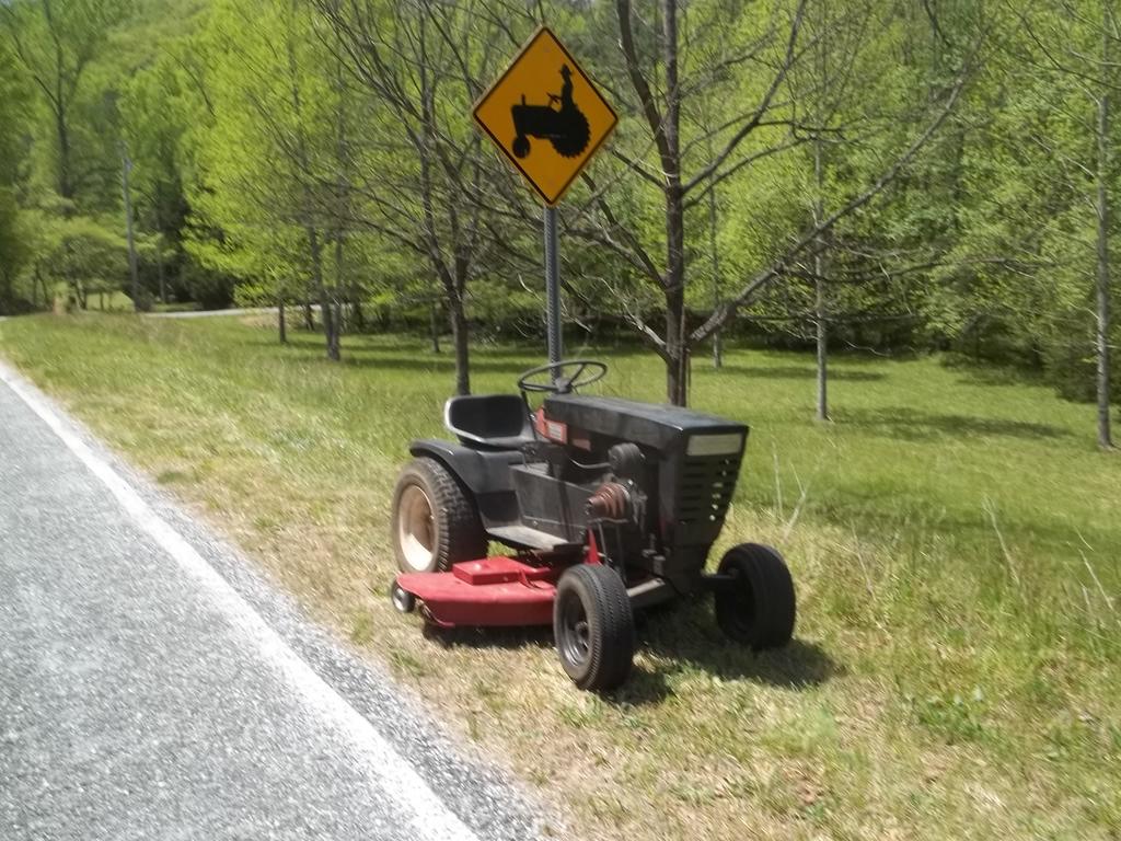

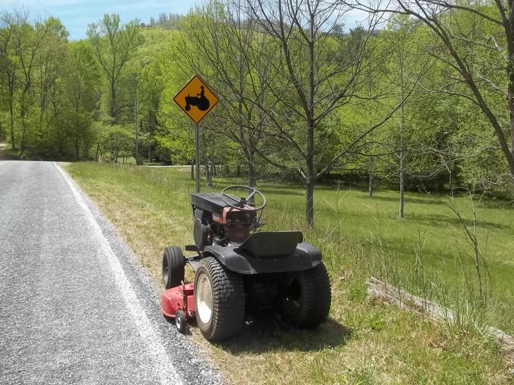

953 nut 62,168 #1 Posted May 3, 2018 A few days back an acquaintance told me his neighbor had a non-running Wheel Horse he wanted to find a new home for. I took a look and saw quite a bit of parts potential, same trigger ignition system as my GT-14 and the seller said the Sundstrand transmission and hydraulic lift worked. Had to jumper across the solenoid to get it to turn over, but the battery was good and verified it had spark. Had some time today and after replacing the old nasty fuel, installing a new plug, ignition switch and choke cable it came to life. Engine was a bit shaky at first, but Seafoam in the fuel and sprayed in the air intake did the trick within ten minutes. It is a '69 Charger 12 andcame with a rather nice 48" SD deck and it is one of the quietest ones I've ever used. That being said I don't know if I have the heart to part it out, in spite of an ugly black paint job it is too nice a . I don't need it, have plenty; so, what are your thoughts. 12 1 Share this post Link to post Share on other sites

Pollack Pete 2,273 #12 Posted May 4, 2018 I never part out a running tractor.I'd use the hell out of it.Looking at your pic.......maybe your black horse was used as a model for the road sign.You say you have plenty of Horses????? I don't think ya could ever have enough.Have fun with your new toy. 1 Share this post Link to post Share on other sites
