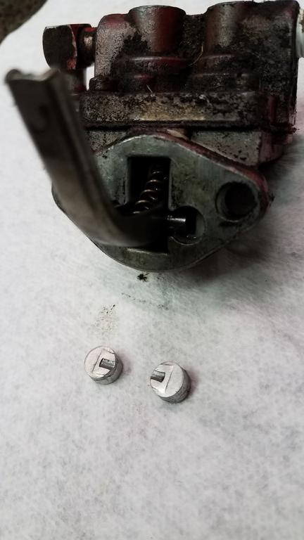

moe1965 766 #1 Posted May 1, 2018 I might have figured out my issue but I thought I would ask the pros . I was mowing today with the c141 and the engine sputtered and died as if it ran out of gas. The tank was half full and I narowed it down to the pump not drawing and or pushing fuel to the carb. I took the pump off and connected it back to the fuel line from the tank and manually moved the pump arm and got lots of fuel to pass through the pump. When I took the pump off the two screws the hold the pump to the block were a little loose. I'm wondering if it was enough slop that wouldn't let the internal thing that moves the pump arm have enough throw to move the arm and push fuel??? What drives the pump in the engine? Could that broken or warn?? Ran out of time to reasemble so I thought I would pick your brains. Thsnks Share this post Link to post Share on other sites
Achto 29,798 #2 Posted May 1, 2018 The pump arm rides on the cam shaft. If the lobe is really worn on the cam it may not work properly. I wold try getting it tightened down & see if you are back in business. 3 Share this post Link to post Share on other sites

moe1965 766 #4 Posted May 1, 2018 Up date. Mower is up and running again I guess the screws were backed out enough on the pump so it wouldn't pump fuel. Strange. No oil leaking from the gasket. 1 1 1 Share this post Link to post Share on other sites
