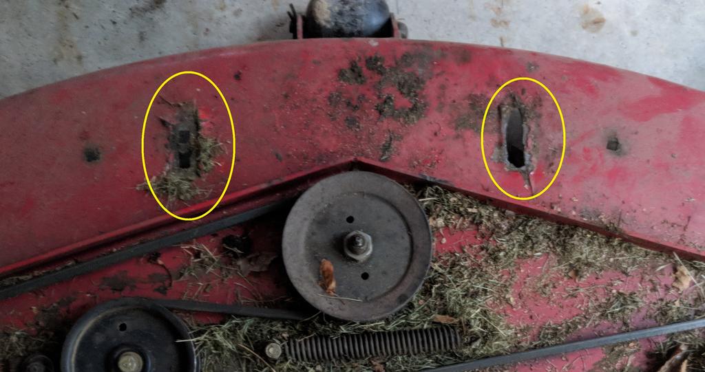

I am in the process of sharpening the blades for my mowing deck (Model 78360 - Serial 7904987) and I noticed that the deck has a crack in it right where the bracket to the mounting hardware (to the tractor) is. SO I know I have to get that repaired.

Cracks there - and several other places - are quite common on these decks, so give a good inspection of all the mounting points.
About the bearings, there was a recent post about replacing these, debating whether to retain the open type that has to have grease forced into them, or go to sealed bearings (I have gone to sealed personally)
As for tires, ebay has so many types/sizes/shapes/and price ranges that a guy could get dizzy going through them. Just go to search and put your size in and set back and peruse them.

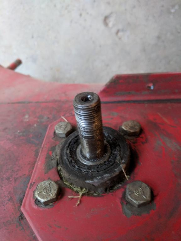

I had also noticed, the right most spindle (closest to the clippings ejection area) has a piece of the spindle come off (where it bolts onto the deck) I take it that cannot be repaired and its probably just easier to buy a new one right?
lynnmor
If the spindle housing is broken, I would replace it.
The bar that connects to the belt tension spring can wear at the bolts.  The plastic bushings on the bolts wear as well.

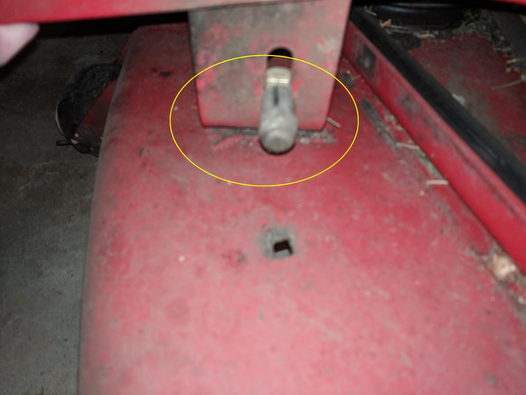

Also in the pic below shows the hole that was ripped out from wear and tear!
