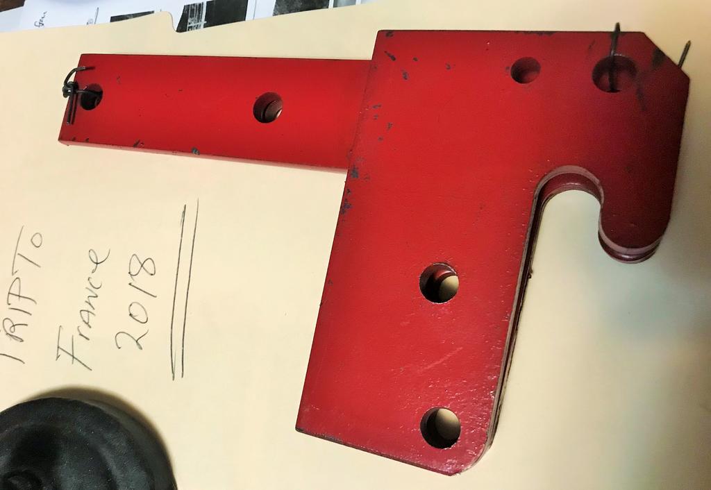

Lane Ranger 11,741 #1 Posted April 29, 2018 This is New Old Stock original Wheel Horse parts from 40 years ago! Guess what they were used for! 2 Share this post Link to post Share on other sites
ol550 844 #2 Posted April 30, 2018 To take on your trip to France? Convert pre attach/matic tractors. 5 Share this post Link to post Share on other sites
MalMac 1,334 #3 Posted April 30, 2018 To use on pre mule drive tractors to add a mule drive attachamatic. I need a set for a 69 Raider 12. 2 Share this post Link to post Share on other sites

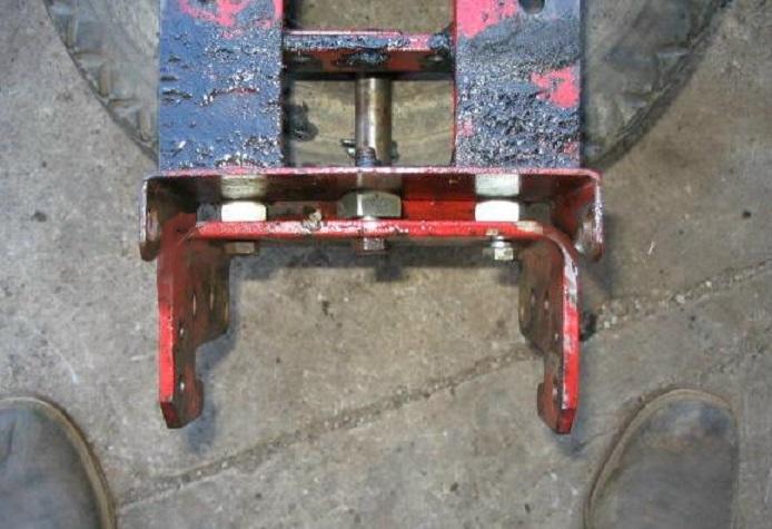

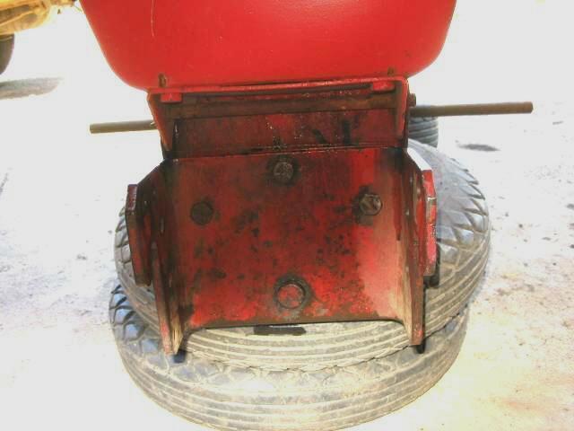

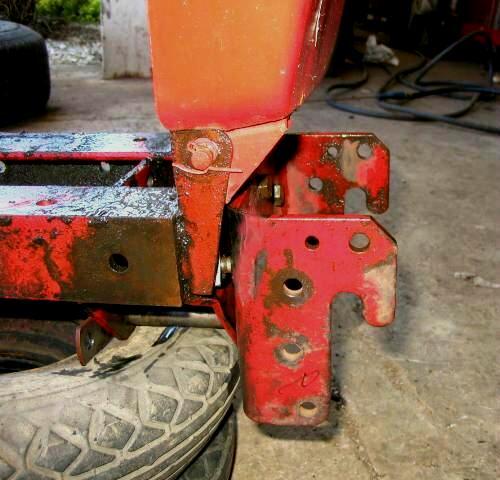

daveoman1966 3,881 #5 Posted April 30, 2018 4 hours ago, MalMac said: To use on pre mule drive tractors to add a mule drive attachamatic. I need a set for a 69 Raider 12. You can also just drill 3 holes in the front hinge plate of your Raider 12 and bolt the front Tach-o-Matic directly to the tractor, then hang the mule drive in it. Did this to a bunch of tractors of this style. This is a Raider 10. 1 1 Share this post Link to post Share on other sites
MalMac 1,334 #6 Posted April 30, 2018 Thanks for tip daveoman, I figured that could be done. I am restoring this one and would like to put original factory option on it. Even though that option came out a couple of years after the tractor was made. This tractors working days are basically over except for some trailer duty. Share this post Link to post Share on other sites

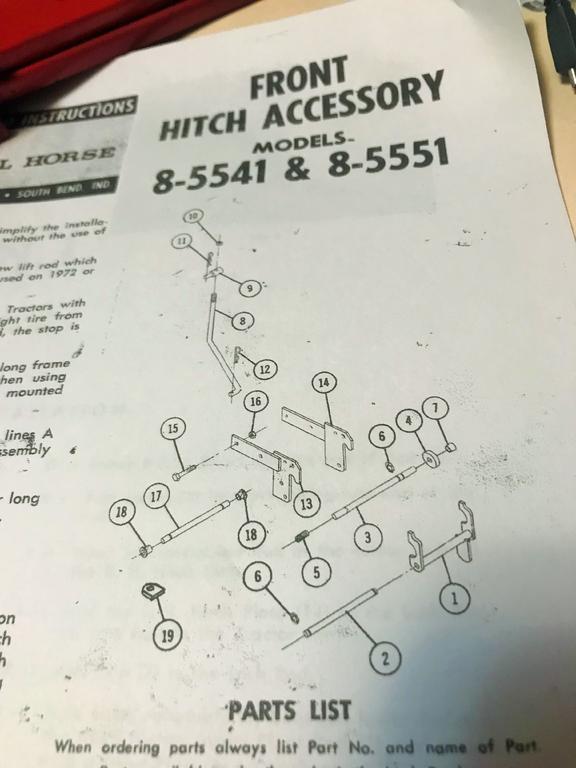

Lane Ranger 11,741 #7 Posted April 30, 2018 (edited) Hitch_Front_1972_8-5541_1973_8-5551.pdf Yes , Wheel Horse was still innovating 45 years ago when they made these two parts to attach newer mowers and snowblowers to older tractors! Edited April 30, 2018 by Lane Ranger 4 Share this post Link to post Share on other sites

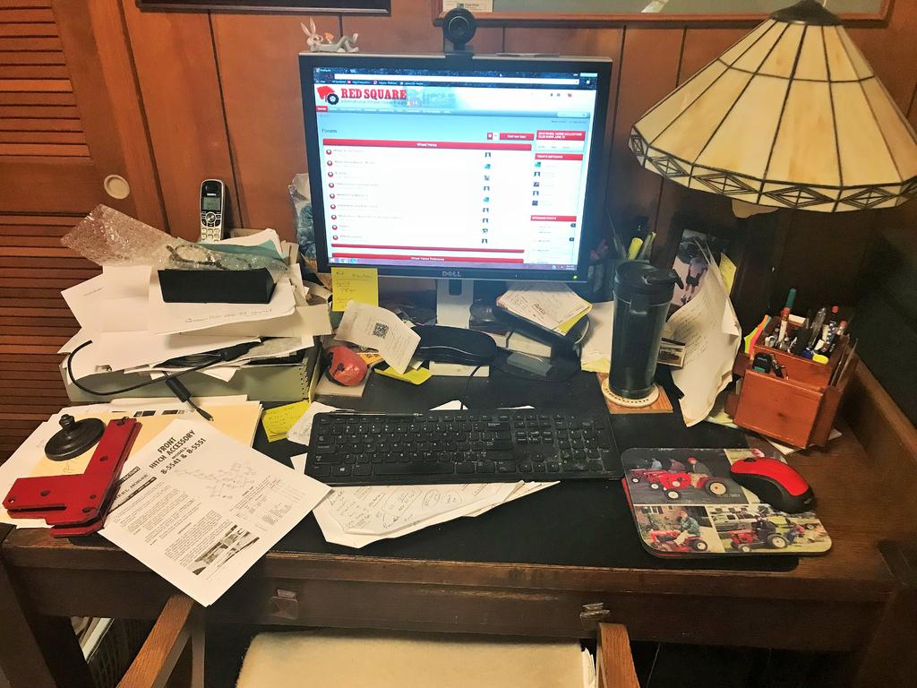

ztnoo 2,302 #9 Posted May 1, 2018 Lane, You need a larger desk!!! 2 Share this post Link to post Share on other sites
Lane Ranger 11,741 #10 Posted May 1, 2018 Steve: I had one four times as large for many years and it still looked like this! 1 2 Share this post Link to post Share on other sites
WHX?? 54,510 #11 Posted May 1, 2018 Like the mouse pad Lane! Those brackets could be easily repro'd on a plasma or water jet machine. 1 Share this post Link to post Share on other sites
