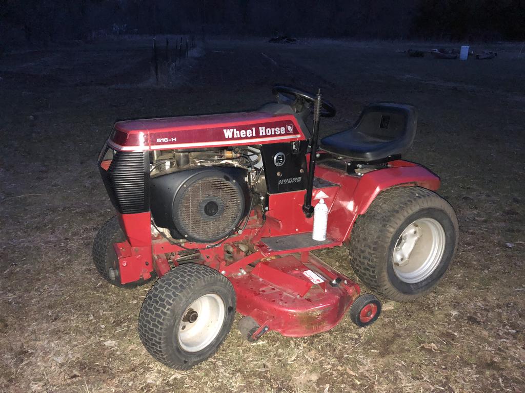

Deadguy 864 #1 Posted April 27, 2018 Today a 516h followed me home. The body work is straight, the paint is shiny, and it has 495 hours on it. But, the fuel line is hard and cracked, but it will run as long as fuel is being dribbled down the carb. The tires are old and hard too. It does have the limp-wristed, metrosexual Eaton 700 as an excuse for a transmission, so it isn’t good for anything other than mowing the lawn, but at least I got a 42” rear discharge deck out of the deal! 3 6 Share this post Link to post Share on other sites

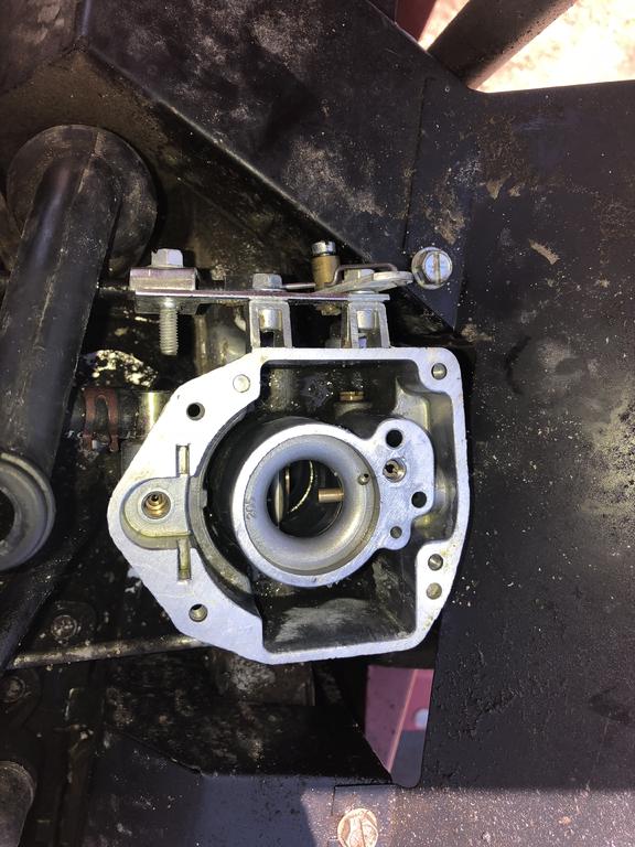

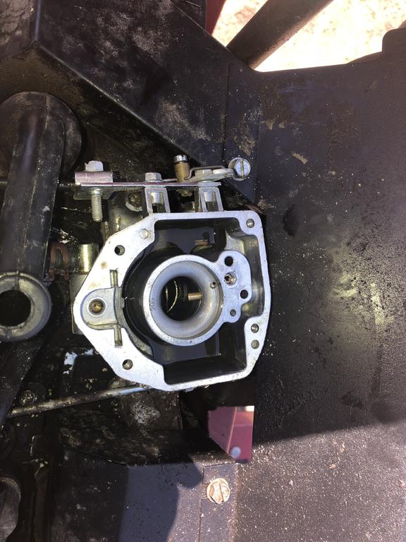

Deadguy 864 #20 Posted April 28, 2018 27 minutes ago, 953 nut said: Oh shoot, I had already started cleaning it when I got this request! Here, see how the gasoline in the float bowl looks like chocolate... Share this post Link to post Share on other sites
Deadguy 864 #21 Posted April 28, 2018 And there at the bottom of the float bowl is done of our Unholy Goo... Share this post Link to post Share on other sites

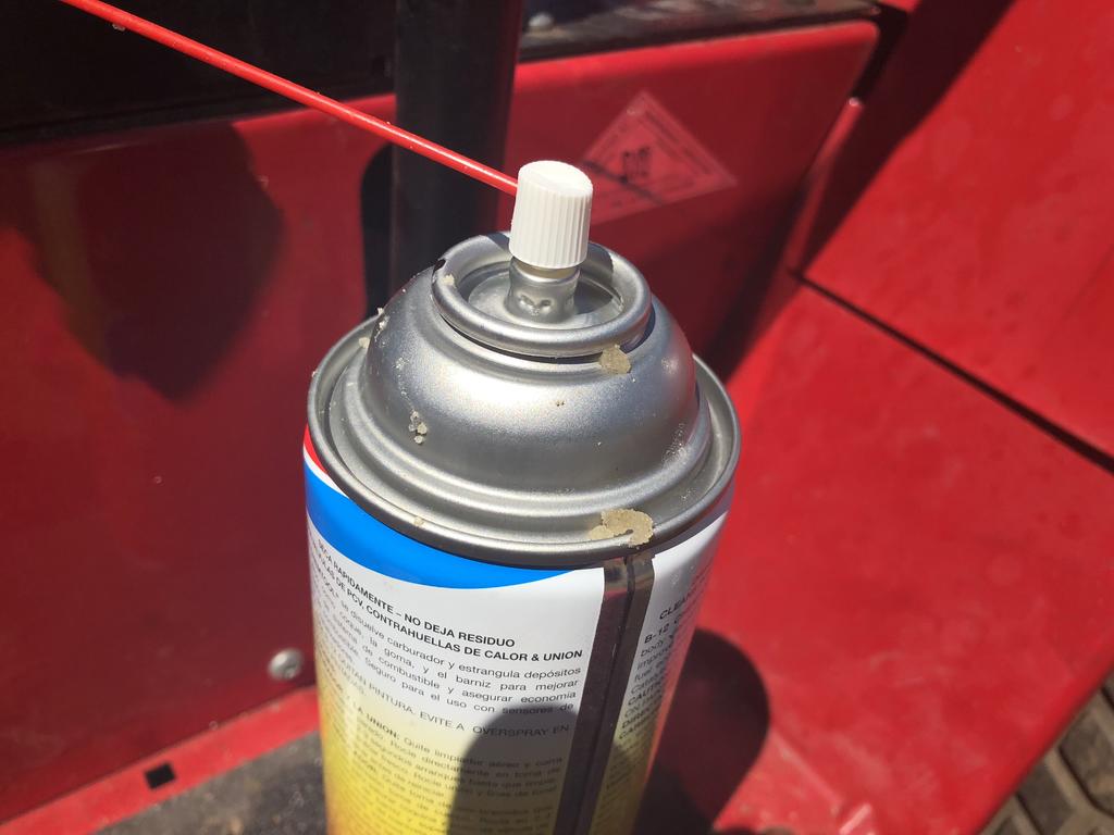

Deadguy 864 #22 Posted April 28, 2018 Here’s a chunk of it on the can of cleaner. 1 Share this post Link to post Share on other sites
953 nut 63,955 #23 Posted April 28, 2018 39 minutes ago, Deadguy said: chunk of it Ethanol! Share this post Link to post Share on other sites
Deadguy 864 #24 Posted April 28, 2018 I hate ethanol! Share this post Link to post Share on other sites
