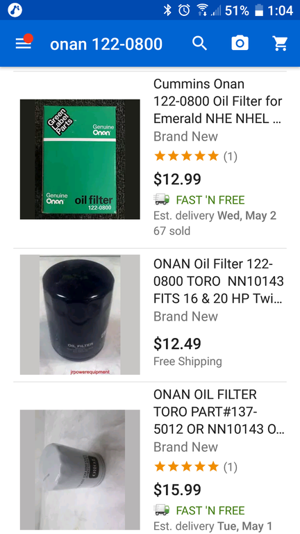

porschpow 7 #11 Posted April 26, 2018 11 hours ago, lynnmor said: I always change the oil and filter together. Using the longer -0800 oil filter, all three 520H's take exactly 2 quarts. Lynmor, What is the model number and name of the longer oil filter -0800 Share this post Link to post Share on other sites
WVHillbilly520H 10,377 #12 Posted April 26, 2018 58 minutes ago, porschpow said: Lynmor, What is the model number and name of the longer oil filter -0800 Onan 122-0800 Share this post Link to post Share on other sites
porschpow 7 #13 Posted April 27, 2018 I was unable to find the onan 122-0800, they offered a wix filter Share this post Link to post Share on other sites
WVHillbilly520H 10,377 #14 Posted April 27, 2018 All kinds on the internet... Share this post Link to post Share on other sites

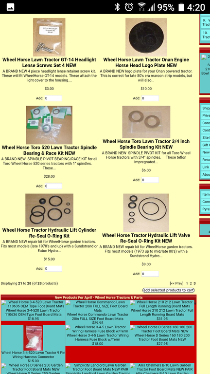

bo dawg 536 #15 Posted April 27, 2018 On 4/23/2018 at 11:43 AM, WVHillbilly520H said: Engine oil changed every 50-100 hours of run time or at least annually and yes it has a drain plug/spout and filter 2.5 quarts with a filter change I use Castrol GTX and factory Onan filters but any brand name oil and NAPA/wix filter will do, transaxle change oil every 200 hours of run time and filter every 100 hours can't recall capacity at the moment and TORO or NAPA/Wix filters, Jeff. Where did you get the wheel horse cover on the shroud? Share this post Link to post Share on other sites
WVHillbilly520H 10,377 #16 Posted April 27, 2018 26 minutes ago, bo dawg said: Where did you get the wheel horse cover on the shroud? "Classic Kitchens and More"... 2 Share this post Link to post Share on other sites

tom2p 2,394 #23 Posted November 3, 2019 (edited) 416-H Onan apparently uses same oil filter Recently I've been using Cummins / Fleetguard LF3339 - 3" diameter and 4.5 length Some oil filters for this application can be slightly smaller diameter - and/or shorter or longer in length The original black Onan 122-0800 filters are 3" diameter and 4.25 length Toro 137-5012 / NN10147 is a smaller filter - slightly less than 3" diameter and just over 4" length read somewhere NAPA filters for this application appear to be larger based on published dimensions (note: some listed / published can not always be trusted) - around 4.8 " length Onan 122-0800 Diameter : 3 " Length : 4.2.5 " Fleetguard LF3339 Diameter : 3 " Length : 4.5 " (can be 4.58 ") Toro 137-5012 / NN10147 Diameter : 2.92 " Length : 4.05 " Edited November 3, 2019 by tom2p Share this post Link to post Share on other sites
lynnmor 8,266 #24 Posted November 4, 2019 You might be interested to know that Onan now packages the white Fleetguard LF3339 in the green 122-0800 box. You can search to find the Fleetguard filters at attractive prices on the internet. Share this post Link to post Share on other sites
tom2p 2,394 #25 Posted November 4, 2019 31 minutes ago, lynnmor said: You might be interested to know that Onan now packages the white Fleetguard LF3339 in the green 122-0800 box. You can search to find the Fleetguard filters at attractive prices on the internet. can recall I was bummed when I opened a green 122-800 box and was greeted with a white LF3339 instead of the black Onan filter I got over it - although the fashion police in me still prefers the appearance of the black Onan filter lol LF3339 is slightly larger - so it makes removal and install just slightly more challenging Share this post Link to post Share on other sites
